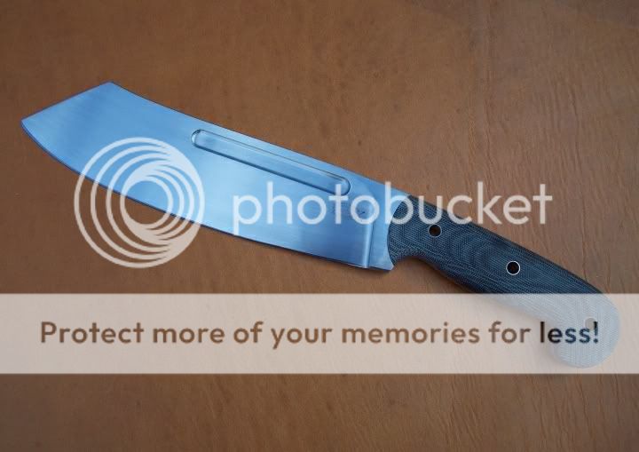

I think 42 means something like this lol:
attachment.php
attachment.php
Haha! Sort of. In theory the blade that would chop deepest out of any design would be infinitely long, infinitely thin, and infinitely heavy, yet with all of the mass at the very tip of the blade. It would also be infinitely useless due to being infinitely unwieldy. :D
Chopping ability must compete against ease of handling, and the two are often polar opposites. It's all about finding the right balance between the two that will make for a piece that both chops and handles well. ;)
That's all a gross oversimplification, but I think it illustrates the principle well. :p
I want one!!!
