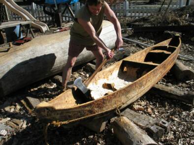

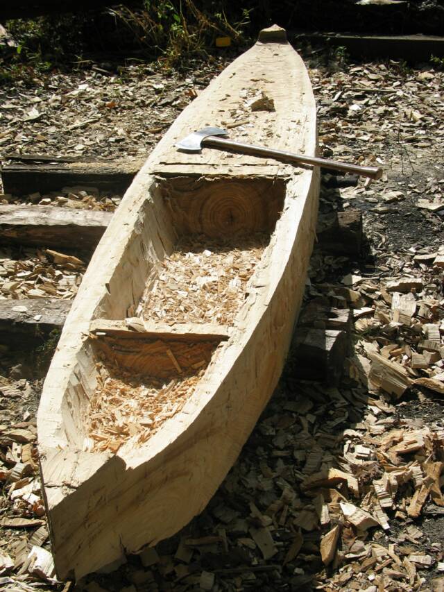

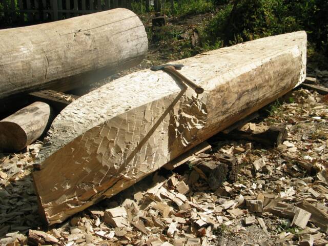

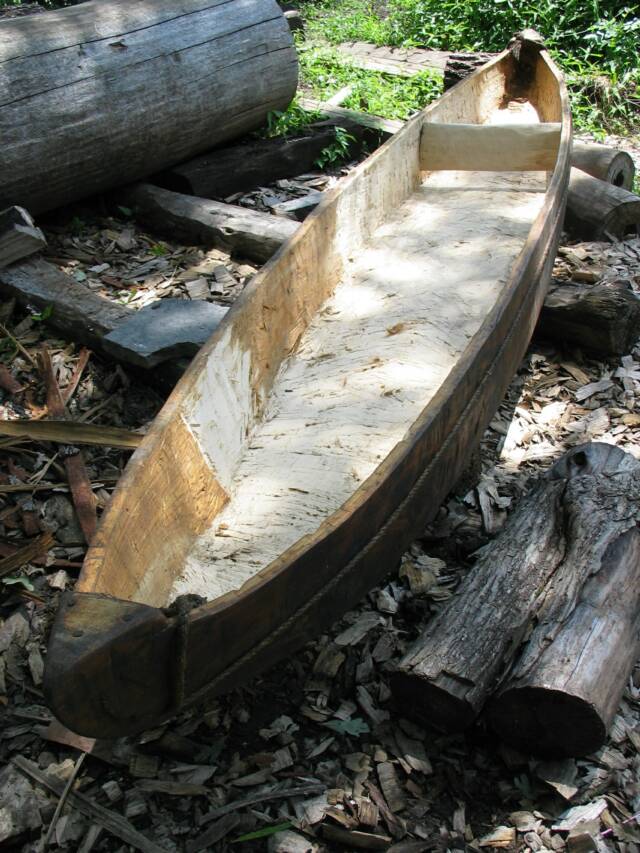

A couple sites with some interesting axework:
http://www.willghormley-maker.com/MakinADugoutCanoe.html
http://www.willghormley-maker.com/MakingADugoutCanoe2.html
From Digging into Dugout History by Jim Low, Missouri Department of Conservation
http://mdc.mo.gov/conmag/2004/01/digging-dugout-history
The Basics of Crafting a Dugout Canoe
1. Remove bark from a log that is no smaller than 10-12 feet long.
2. Place the log bottom up, and chalk the lines for the top and bottom cuts.
3. Drill three-fourths inch holes at three inch intervals about two inches deep along the center of the bottom of the log as depth gauge holes.
4. After the bottom is cut, roll the log over and cut the top of the log.
5. Mark and cut diagonal lines for the bow and stern.
6. Chop a notch with an adze the width of the log, leaving space on each side for the gunwales.
7. Turn and stand opposite of the first cut, using an adze make a second cut 4-6 inches away from the first cut. A wood chip about 1 inch thick should pop out.
TIP: With the adze sunk on second cut, apply pressure downward on the adze handle to pop out chip.
8. Continue to chip out layers of log until the depth gauge holes are reached.
9. Using wooden, tapered pegs, fill the depth gauge holes. Cut off excess peg.
10. The canoe interior can be finished or smoothed with draw knives and gouging adzes.
