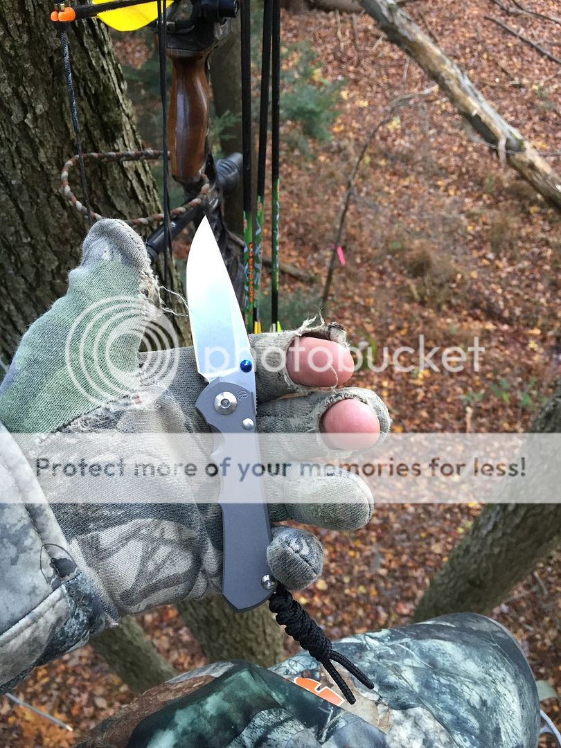

Howdy folks!
I'm reviewing the Small flavor of the Sebenza 21.
I've carried this knife for about a year, with 3 months or so without it. Call it 8 months just to be safe. :)
I'll include some of the pictures that I have, but I'm basically stuck to only my phone, so I have limited ability to capture better pictures.
The knife that I'm reviewing here is the Small Sebenza 21.
It was created in "celebration" of 21 years of Sebenzas.
I chose it over the 25 purely because of aesthetics.
The blade is 2.94 inches long.
Just over 3mm wide, hollow ground.
CPM S35VN 58-59HRC
Uses a pivot bushing. Tighten the screw down all the way and its perfect. Even with the screw OUT, there is no bladeplay at all.
Handle is solid Titanium.
6.9 inches long overall.
Backspacer is Titanium.
Thumb stud is press-fit and also Titanium. After alot of use the blue color starts to wear off.
The washers are bronze and are made specifically for each knife. Not interchangeable between ANY CRK because the thicknesses are slightly different.
Comes with the tool necessary for a complete disassembly.
Disassembly is wicked easy and takes only about 10 minutes for a complete cleaning. It can only be reassembled one way. Mistakes are virtually impossible to make.
All of the screws are polished and sit at the same depth. Even the pivot screws.
The back of the handle jsnt actually flat. It has a subtle curve. Just enough to help keep your grip. :thumbup:
Lockup is right dead center at 50%. And when using it hard and pushing as hard as you can, it moves to almost 75%. Closing and re-opening brings it back to 50% again.
The bevels around the edges of the handle are cut very cleanly and are the same exact width all the way around.
The words cut into the handles "Idaho Made" and the CRK logo are the same width throughout the letters and are also cut extremely cleanly.
NO sharp edges. Anywhere.
No sanding lines or marrs from deburring.
The back of the blade is cut roundly and is very very smooth throughout.
Bevels are even down the length of the blade.
Detent is nice and crisp. Makes an audible "click" upon closing.
The pocket clip is perfection in itself. The second bump is like a "fail safe" and also clips to the pocket. If ever it starts to fall out, that second bump snags on the rim of your pocket. In a $350 knife its fantastic.
There's a video on YouTube where Chris is being interviewed with a tour of his factory. He says that the space within the handles is within one-tenth of a thousandth down the length of the handle. That is so small, and the fact that they can use such tolerances blows my mind. I used a dial-caliper to check the centering, and that's also within a thousandth.
I had alot of problems trying to sharpen it, but I realized that my stones were just loaded up. After cleaning the stones, it was back to normal in terms of sharpening.
I've used it to cut tires, sandpaper, cans, wood, scraped off gaskets, etc.
I use it just like any other knife. I actually use it harder because I know it can handle it. It's in the same condition as the day I got it, except for a few scratches.
The scratches on the Titanium look fantastic IMO.
It took some breaking in. At first when I got it, it was kinda tight.
Use it, disassemble. Clean. Over and over again. Probably 4 or 5 times, and not that it's broke in, its super smooth.
You need to hold it to start to understand. Better yet, buy one and start reading up on it after you've handled it to learn more. If you can find that video it would help even more.
It's by far my favorite knife that I own now, or have ever owned,. Ever.
It was worth every penny of the $350 that it costs.
