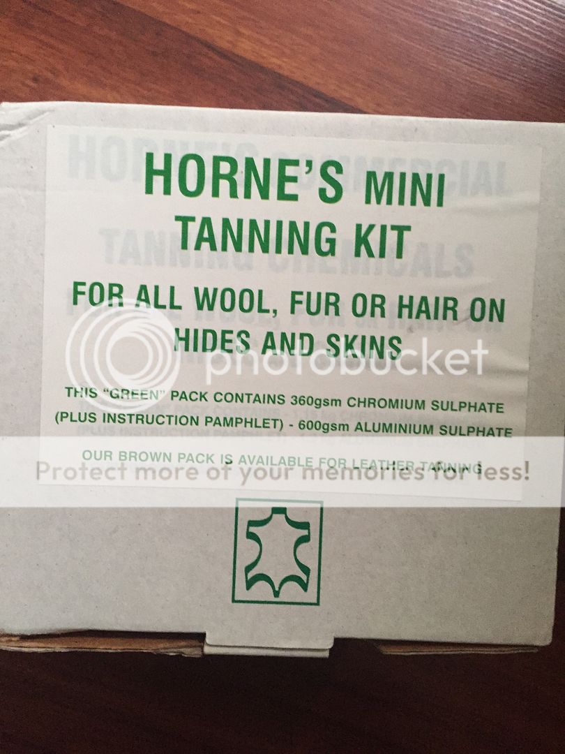

I have been asked to make a sheath with a hair on inlay. I wasn't able to find this particular hide tanned in Australia, so I have sourced the hide and got a tanning kit for hair on DIY tanning.
Unfortunately it is a chrome tanning kit (again supply of a lot of things is quite limited in Australia) and I just want to find out if there is a way to make sure that it will work for a knife sheath without damaging the knife.

Here is the tanning kit I got locally, flashing knife it comes with is not in the pic.

I also thought that some of the bad rep for chrome tanned leather came mostly from the less than optimal tanning process. According to instructions in the kit, after all the soaking/cleaning at the end of the process (even specifically asking for rain water :eek:, good thing that after the biblical weather we had in the last week and a half I have about 2 buckets) nothing soluble in water would have stayed in the leather.
That's awesome man. Please let me know how the kit works out!

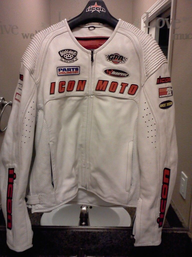

Exactly what I was thinking too. I was reading about the various qualities of chrome tanned a couple of weeks ago. According to the article one of the main benefits is that high quality modern chrome tanned is basically water damage resistant. They claimed that their leather could be machine washed.
I have an expensive white leather motorcycle jacket with red leather panels. It gets dingy pretty quickly riding through all the gnats and whatnot and I'd read that it could be machine washed. I've done just that a few times and have noticed no damage outside of a little stiffening, but conditioner helps that.
Doesn't say anything about metal interaction, but it says to me that chrome tanned is a different product than what used to be available.
Interesting stuff for sure.
