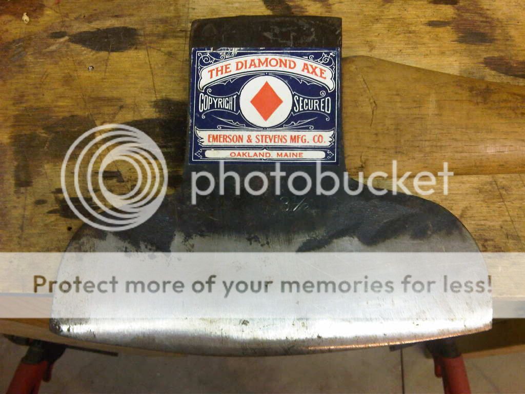

They made great axes. I have a couple - here is the prize piece -
Its a beauty and rings true when struck.

Excellent video. Thanks for sharing. I was surprised there were so few workers there. E&S was the last axe company to use the 2 piece overcoat method to make axes, long after most axe companies gave it up. I have a E&S db 3 pounds even and unhafted with the old diamond shaped eye.

Half axe, how do you know its a E&S? Don't get me wrong I am not questioning that it is a E&S. I have one that looks a lot like yours. Just did not know the maker. Can't remember where I put it either. I am sure I still own it.
I was curious about that too. I have two maine double bits with a weight only, no makers mark.
It's stamped E&S Hand Made. Very light stamp I couldn't capture with my cheap camera. I understand light stamps from this company were the norm and would have worn off quickly with use.
Half axe, where is that stamp at? Thank you for your help.
I have been wondering about this axe for sometime now. The axe is very thin in the eye. Mine is stamped 3 1/2. It is also stamped on the bottom of the head, it is either 18 or 81. It looks the part of a two or I guess with a DBL bit three part construction.
The steel is very thin in the eye.
I'll go out to the shop tomorrow and try to get a picture when the light is good. It is on the face below the center. If I remember right, that is part of the S just below the center of the axe in the picture. In addition to the 3 on the face, I have a 35 stamped on the bottom. The seller, who was a knowledgeable collector, claimed it was the year produced. So maybe yours is 1918?
