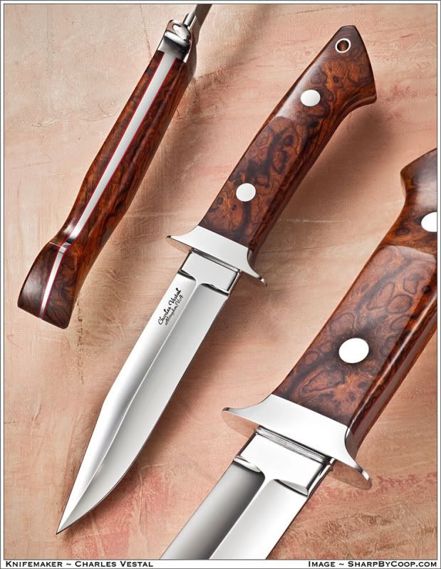

Charles Vestal:
Hello Everyone,
Here's my contribution to the CKCA Mini-Knife Show.
A Loveless style Fighter/Boot knife. 4 3/4" Mirror finished CPM-154 Blade, 9 1/2" Overall
416 SS Guard and stainless bolts and thong tube.
Ironwood Burl scales with red liners
Comes with a leather sheath (still working on this)
Blade was heat treated by Paul Bos to 60-61 RC
A thanks to Coop for the great photo.
I hope you like this knife and I look forward to meeting everyone at the Banquet.
Take care
Charles

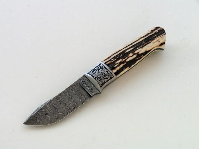

Tim Hancock Semi Skinner,
The Damascus is 15N20 and 1080 ladder pattern the bolsters are 416, Engraved with a Gargoyle motif, by Bryan Bridges.
The tang is tapered and shows the pattern all around the edges. The scales are Sambar stag pinned with five 416 pins. Blade is 3.5" OAL is 7.75"
The sheath is a belt clip style with shark shin overlay.

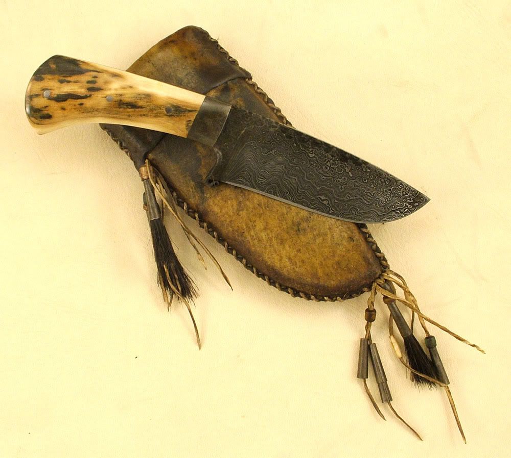

Homestead Hunter:
Blade - 4 1/4"
Overall - 8 1/4"
Full tapered tang
384 layer Random pattern Damascus (1080 and 15n20)
Mammoth Ivory handle
Steel bolsters
Thumb position file work
Forged finger pad w/ curl
Sheath: by Karen Shook
Latigo leather inner pouch
Rawhide cover
bead, tin cone and horse hair decoration
