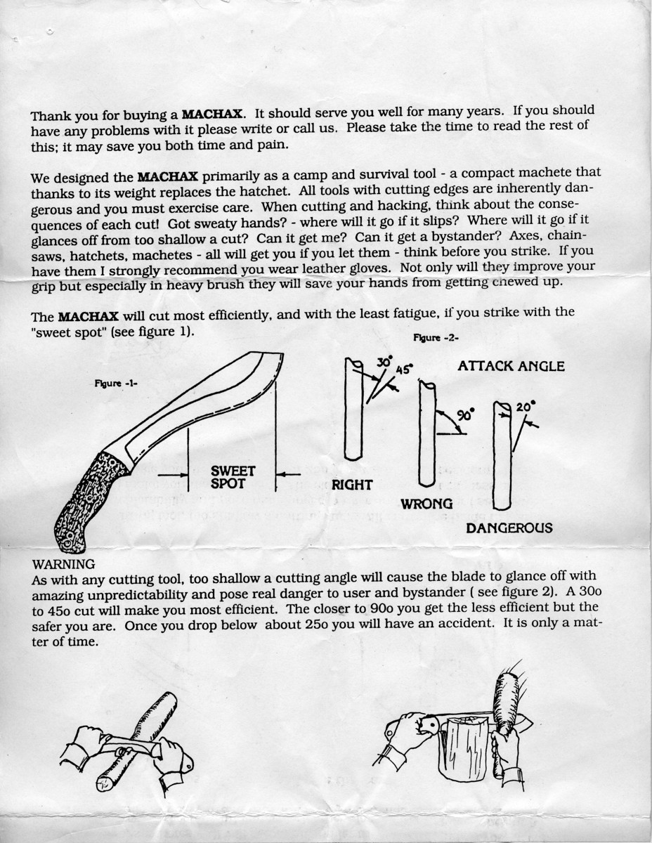

This is pretty cool! Kinda feels like looking into the past to solve a current problem. I hope I can replace my BK4 before winter.
Anyway, thanks for sharing bladite.
"The new 1986" , Yep, Its been a few years since that was written :)
Awesome piece of history!
