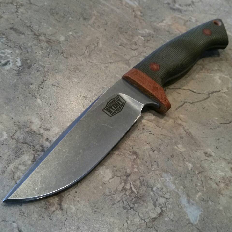

D2 Blade, all canvas micarta handle and guard including hardware, Loveless bolts I made from canvas micarta as well. Tapered tang Blast and tumble finish on entire knife.
That would also be very nice with a small double-guard. [emoji41]
have you tested the strength of those bolts? I'm curious as to how they hold up
They definitely wont take a side load...lol but as far as pull strength on the threads , it's fine for this application. Also everything is epoxied so its at least better than straight pins. It's mostly aesthetic and I promise....not worth the time to do it a lot.
That is a good looking knife, I like the blade lines and handle, some nice work there.
