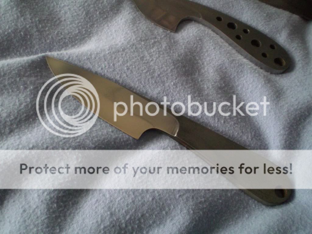

and yes, it was etched in a 50-50 solution of vinegar and water, heated
(1st pic)
btw.... That knife is hollowground 1095, water quenched

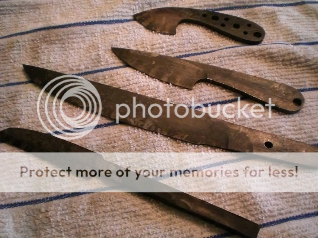

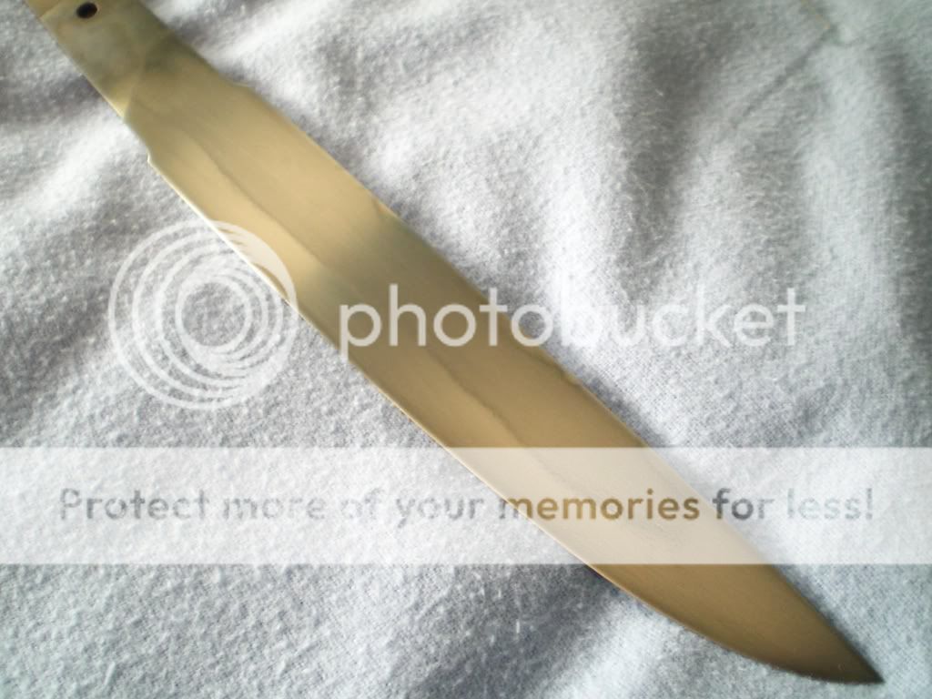

thanks so much for all your advice espcesially sunfishman... i hardened four blades. One was O-1 tool the other three were 1095 high carbon. The 1095 I quenched in water and the O-1 in oil. didnt crack any of them and while i havent finished polishing the O1 all the 1095s got great hammon lines. sure there is room for improvment... but thanks aLOT.
heres some pics
heres right after i finished gettting the clay off
Grinding....
Polishing...
fin
another
thanks for your help... these will be up for sale soon....
