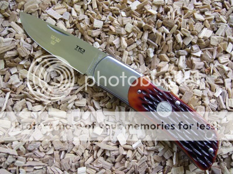

Hi, I really want to get a fallkniven TK3 with jigged bone but the only thing holding me back is that it seems like a very tricky design to clean. I know it's an outstanding knife and I'm sure they thought it through well but I'm just wondering if anybody has had previous experience with this?
Thanks for the help,:thumbup:
Gabriel.
I don't understand how it would be any harder to clean than any other lockback. The blade is stainless so just some soap and water should do fine. Re-oil the pivot.
Most times a wipe down will do.
Greg
I was thinking more along the lines of how to clean the washers out if they get packed with dirt. It generally happens over time... I thought that this would be harder considering the non adjustable pivot pin. Maybe I'm just creating problems where there are non :o
Gabriel.
Clean with soap and water. Fallkniven advises not to oil the pivot because the oil attracts and holds dirt and debris.
They also suggest on their website to avoid using a folder for extremely dirty tasks, simply because this can cause the pivot to gum up over time, and recommend using a fixed blade for such tasks.
Kevin
Wow, that's easy but no oil!!! that's a first... Any idea what bushings it sports(if any)?
I can't speak to the TK3, because as you noted it isn't easily disassembled.
My PXL has no bushings that I have noticed, only a hole in the blade and a tight tolerence fit on the pivot pin. If there is a bushing pressed into the blade the interference fit is so tight I have never noticed it.
The washers/spacers are teflon I believe, if not teflon, a synthetic of some description.
