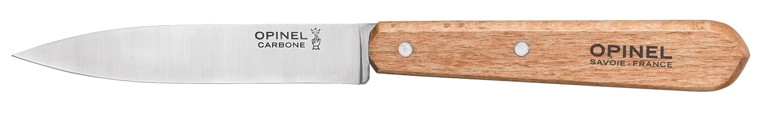

Opinel does have a carbon paring knife (sold in sets of 2). Search on 'Opinel Carbon Paring Knife No. 102'. Haven't seen/found other Opi kitchen knives in carbon, however. Having said that, their stainless (Sandvik 12c27Mod) is very good, and used in their other kitchen knives.
Here's a pic from one online seller:
I have a set of these paring knives. The patina they end up with after a year or so is really fantastic. And they sharpen up really easily and cut really well. There is a thin gap between the wood and the partial tang, so they are not appropriate for a commercial kitchen.
