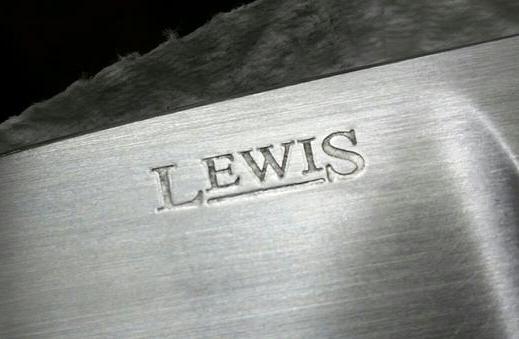

Etching deeper while keeping it clean and halo free is half the battle. I think it was Brian Fellhoelter (one more fine/experienced maker who used to hang out here) who suggested incorporating Windex into the routine. IME nothing made a bigger difference than using the appropriate electrolyte solution for the steel type and using Windex to stick the stencil down to steel. I was skeptical on the Windex but not anymore so I will leave it to you to try or toss the idea.
Also, using plain Scotch tape to "hinge" the stencil can be helpful in that you can pull the top or bottom piece of tape after 1st run and fold back the stencil far enough to clean out the etched steel area with EtOH on a clean swab. The long-sided tape hinge allows you to drop/reposition the stencil precisely, replace opposing tape if needed, and have another go or two at etching deeper with same modest voltage (I use 12V X 800mA for everything). This in itself minimizes the halo on carbon steel in my direct experience. From there, it is typically an easy job to clean up satin finish with the final grit as others have suggested here.
As an example, this is a sorry macro shot of my usual 0.50" wide mark on an 800 grit satin background directly after etching as described above. No cleanup other than a wipe down with Windex on a swab has been done yet. Look close and you can still see a halo etched a few thousandths deep which will be removed in short order with some fresh paper on a hard backing.

Laurence, I use the same etching machine but my etches are not as deep. I have been more concerned with getting a dark mark. I have been putting my machine at about 16 volts power and etching for about 4 seconds and then once again for four seconds before flipping the switch to mark for a good four seconds and then three more. I really like the looks of your mark. Should I be etching for a longer time in your opinion? Here is a picture of my mark ...shallow but dark. Thanks, Laurence "Larry" Lehman P.S. I use #94 etchant from IMG in New York on my stainless steels blades. LL

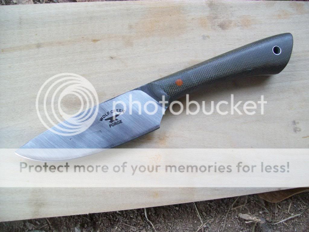

Well my set up has been kinda cobbled together. Im using the battery to my 18v drill and using straight saltwater on a Q-tip. I may have too much power so I probably should get a proper power source and try the windex method.
So far this is the best I've been able to do. Sorry about the crappy pic. Just did it real quick for this post.

Cool little drop point.
