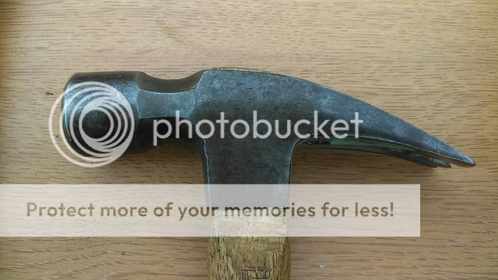

That why you should just wire wheel it, it has so much pitting that you nothing else will look right.
The photos you found were likely dark from patina and we're heads that were wire wheels.
Here's an example of a 1950's Vaughan/ craftsman hammer head that I wire wheeled.
