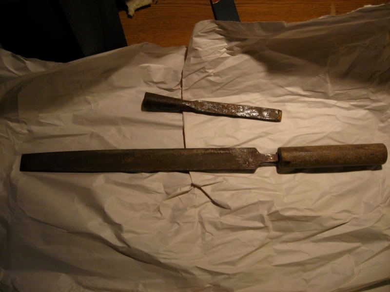

took a little trip down to the junk shop today,
and came home with $2 worth of steel,

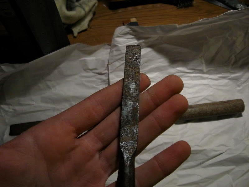

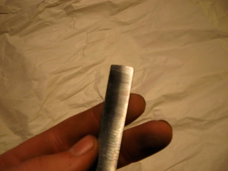

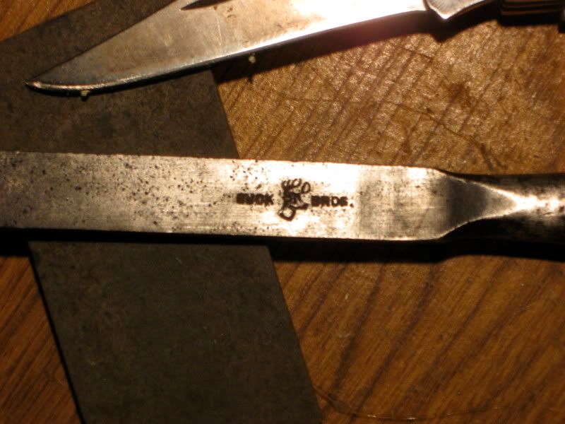

a nice little mortising chisel that is pretty badly gummed up,

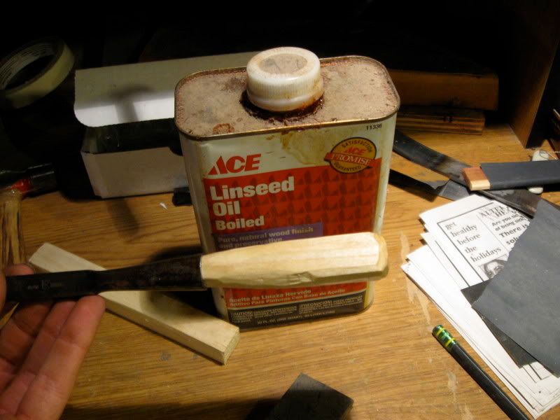

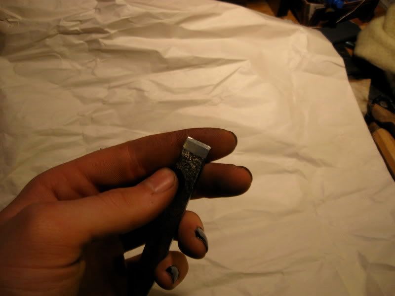

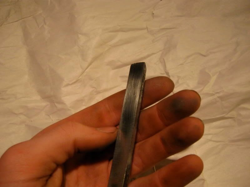

i started by sanding with some 150 grit paper to take off all the rust then i started trying to sand the pitting out of the back, but it was pretty deep, so i took it to the belt sander with an 80 grit belt followed by flat sanding on some 150 grit and then 400 grit paper,

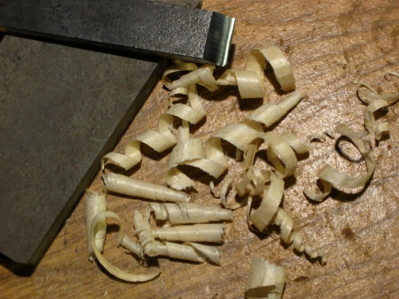

then i rough ground the edge (straightened, squared, raised a burr along the whole edge) with a few passes on a coarse stone on my bench grinder,

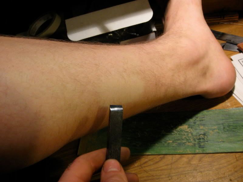

then i cleaned up and flattened the bevel on some 150 and then 400 grit paper for a slightly convex bevel. followed with green rouge for the final polish and stropping. its sharp

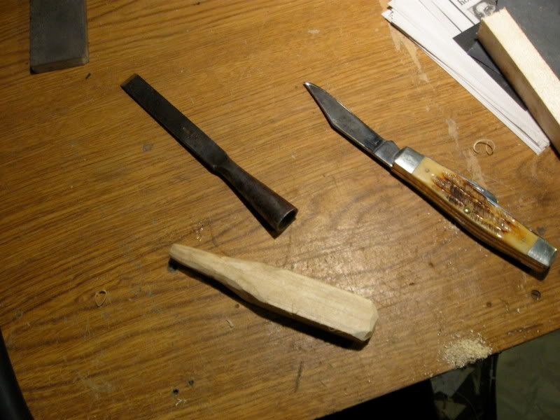

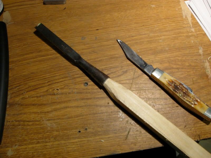

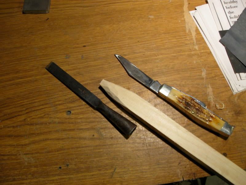

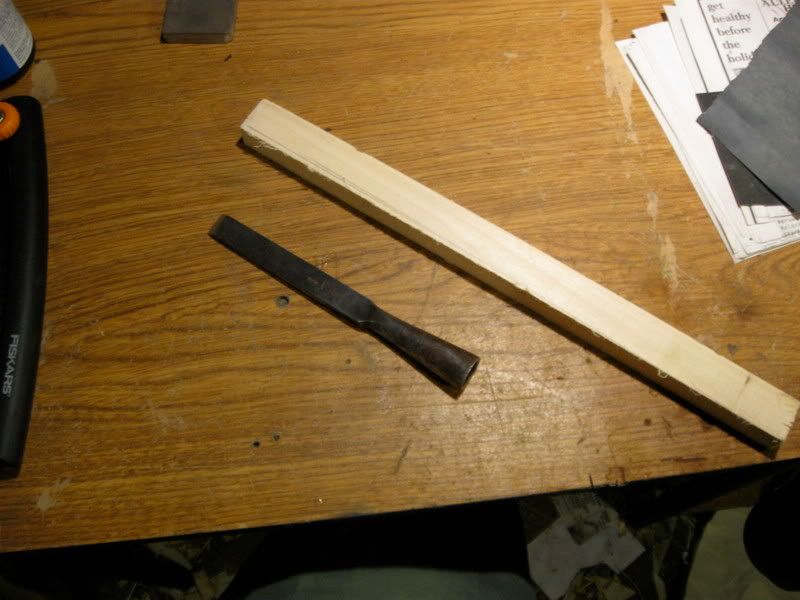

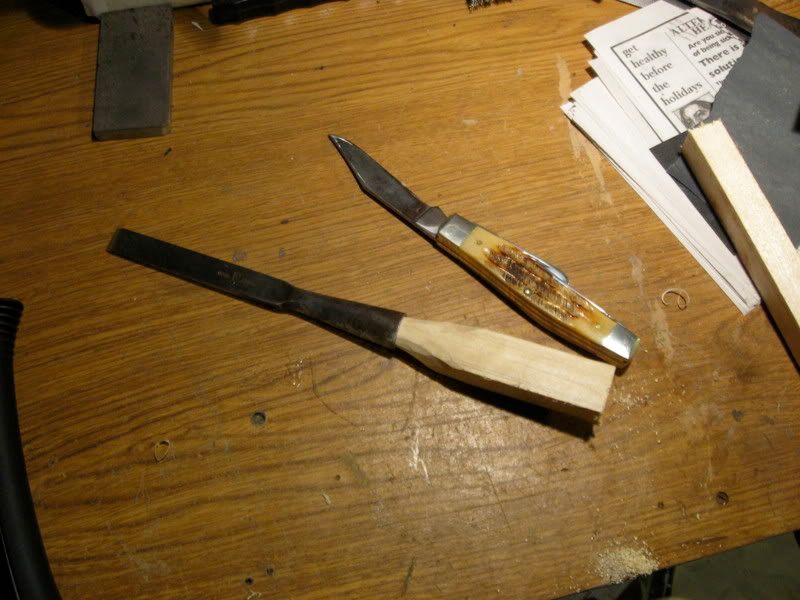

with that done, i moved onto the handle. i grabbed a likely piece of scrap poplar from my box of wood,
