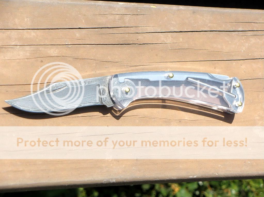

ItsTooEarly's pic from march of this year (Buck Knives forum). it's one of the best pictures here in BF, imho.
looking at this picture, i think moving the pivot to the left (farther from the lock notch) will make a traditional spine lock almost as strong as a tri-ad, owing to increased leverage. am i right?

I don't think so. The force has to be exactly 90 degree against the lock mating surface. That's why th pivot center has to be closest to perpendicular against where the mating surface is. Thia way, pressure to the spine is transferred as push forward on the lockbar.
Moving the pivot to the left will result in force of the spine transferred tangentially, resulting in more push to the lockbar up towards release, in addition to forward, which requires stronger springbar to keep the lockbar down into the notch.
Tri-ad lock can have that as the force is transferred to stop pin. Now it might be good idea to narrow down the lockbar lever and insert a stop pin, making it a true tri-ad. Or bring the bar a bit forward (remove material from blade tang infront of the notch) & insert the pin in the resulting gap.

thanks. the picture kinda blew me away. first time to see the insides of a buck hunter after more than 40 years of fascination. but going back to the topic, nothing wrong with putting reflective tape right on the scales. better yet, luminous dots.
Yeah, I've seen some others on buck 110 too. The one poste here is 112 I guess (?) From the pics, it seems possible to add stop pin in front of the lock bar, very close though to scale edge/corner.
A forumite on Britishblades put glow in the dark on the SRM763. No need transparent scales it seems. Still great idea to see inner parts, always intrigued. Imagine the new Spyderco Szabo with transparent scale ;)
If Buck made the 110/112 with clear scales like that (and a standard blade) I'd totally get one. I love that picture. :)
