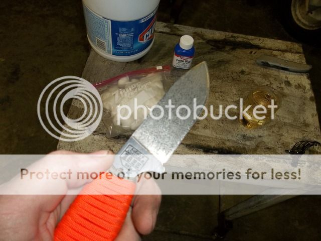

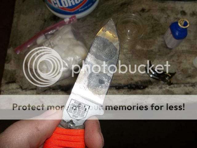

wanna start by thanking Clich, not sure if he is the first to think of this, but his HowTo thread is a boon...his method works perfectly, Im pleased with it.
Clich's Thread http://www.bladeforums.com/forums/s...er-etch-how-to-NEW-TECHNIQUE-AND-PICS-POST-25

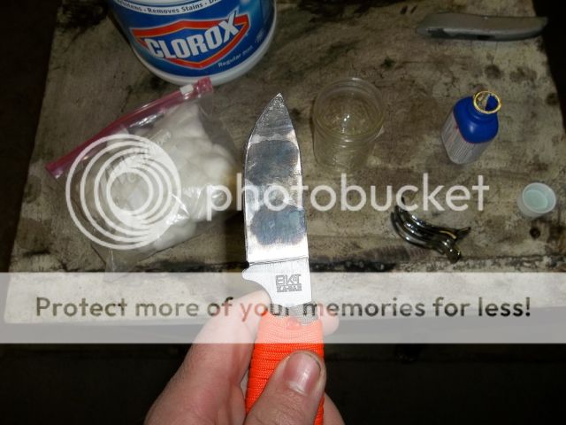

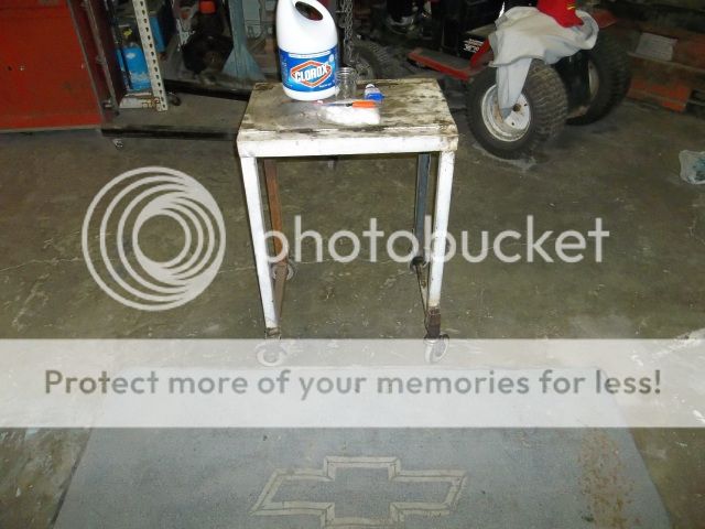

messy shop, check. Chevy floormat, check, homemade oily ''workbench'', check. Im ready to roll

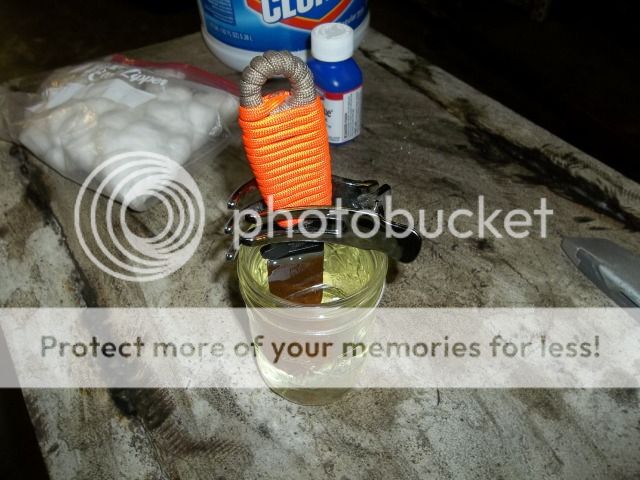

I put three heavy blobs on there, then light coating all over the blade.
Soaking in the, wait is that 'shine!!!??? nope, just clorox. Stole, er I mean Borrowed a hairclip...worked well ;)
55 minutes later, ''holy sh*t I rusted it ALL up!!!''
after drying, 100 grit scrub, and washing up
light recoat of the permablue...

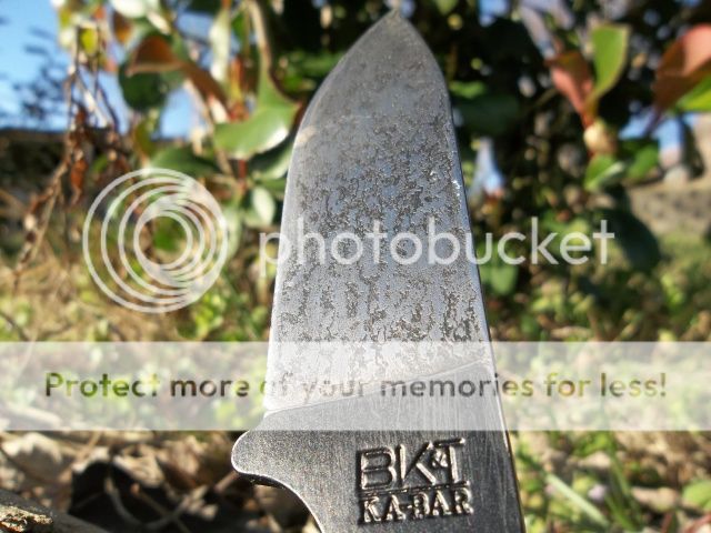

sanded with 1,000 grit then polished with 000 steel wool
cleaned, sharpened, oiled.

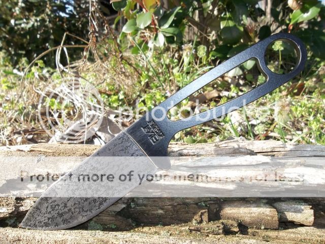

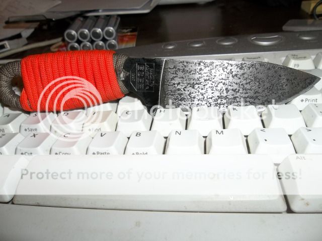

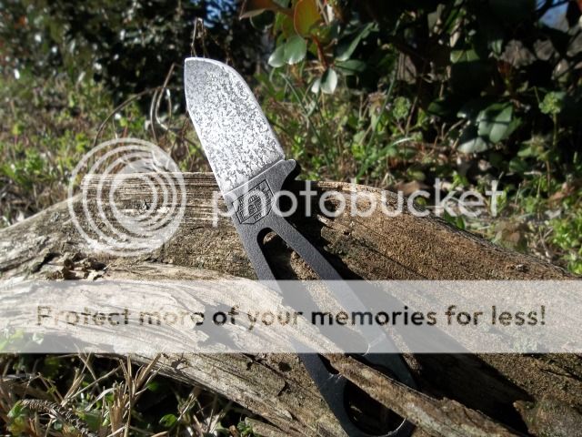

I like it, think the BK2 is getting bleached next.

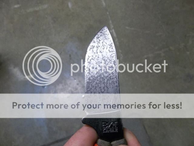

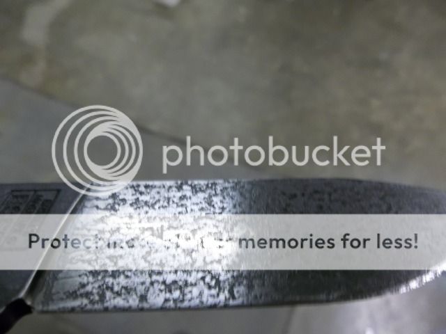

*Note To Self, next time dont get the Blue on the edge, etched it pretty good, took me awhile on the 'stone to clean up.
*better pics of the etched blade

Awesome work. No its not my idea but I've experimented with enough different techniques that I've perfected it as much I can. Looks amazing!
Btw for the edge use some carmex or other petroleum based jelly. Blue it first, apply a thick coat of the jelly to the edge then soak. Its also how you can do just the flats. In this pic I put the blue on the flats and jellied the rest of the grind.
Thanks, should have done that to start with, ...where credit is due & all that
