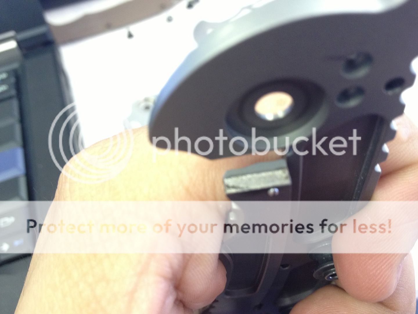

Here's some pictures of what carbidizing looks like after sending it in to ZT for repair.
I mention all of this because you'll notice the corner of the lock bar where it actually engages the blade. That's worn, and is practically down to bare titanium. It likely won't stick because...it's worn. That'll happen whether it's recarbidized or not, as is demonstrated by all three of my 0560s and those of others.

You can tell what has been carbidized by the way it looks on the lock face. You can see it in the pic showing the lockbar. the light area that looks sot of "gritty" is the part that's carbidized. The darker area is Bare Ti. I hope that makes sense. It probably doesn't though:)
