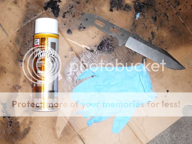

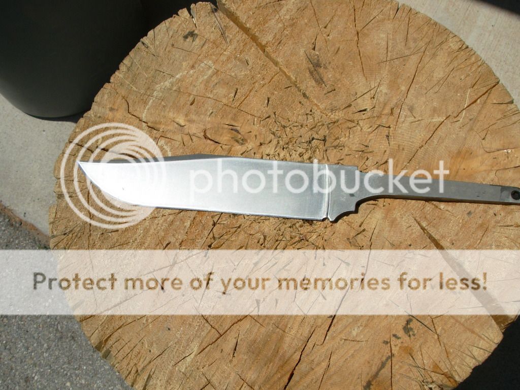

is citristrip best option for stripping the finish? i'm going to strip my 16 once it gets here.
I have had pretty good luck with this stuff. You dont need anything to apply or spread it. I scraped the coating off with a scrap piece of wood and rinse with water. Takes off any coating from Becker/Kabar
TTW,
After messing with various paint finish strippers for at least 20 years that's the same stuff I prefer. It's may cost most per ounce than the same stuff in the cans but it seems to go just as far. Once the cans get less than one half full, the volatiles in the solvent seem to evaporate and it looses it's punch, especially in dry warm weather. Also the aerosol makes application much easier. No snotty gelatinous goop to slather around.
I like to degrease and then scuff the surface of the older slicker coatings a bit with some 220 sand paper before applying to allow the stripper to get even more "bite" and work faster.
