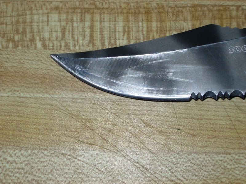

Ok I decided tonight that I couldnt deal with my sog trident being dull anymore. This thing was so dull fishing line was an issue to cut so when I was done fishing I went to sports authority and picked up some crock sticks and got a coarse bench stone from sears. Now its no sharpmaker but no place local had it and the budget was tight. I was able to get it sharper and it would kind of cut hair it pushed hard but its not scary sharp at all. How can I get it there guys. I have been trying for almost 2 hours. I dont know if the pics help at all. Any advise would be great. Thanks
Make sure you're holding a consistent angle on each pass. If any of those scratches in the coating are from the stone, then you're dropping the blade far too low and not grinding at the edge. Get it sharp on the stone first, the crock sticks are much slower cutting.

I just tried it that way and my edge is worse then when I started. Before I was trying the burr way but I cant feel the burr when using the crock sticks. Also the blade doesnt all touch the surface of the stone at once I guess the way its shaped wont allow it. Im sure these two should be able to get anything sharp enough to shave

I can not get the blade to fully contact the stone at any angle. I dont see why it wont but only small areas contact and you have to move the handle to get different areas to contact at the same angle. Are all knifes like this? I mite have to pick up a spyderco or buck for fishing but for now I need to get this sog decent. I tried that magic marker trick and it confirms that it all wont touch

Hey I ended up picking up a lansky 3 stone standard kit which really helped because I could tell how much farther I had to keep grinding on the benchstone to get to that angle. I used the 17 for my edge and I have the crock sticks that I used last. I was able to cut hair from my arm but it felt like I had to push against my skin to hard to do it and it did not shave clean. Im so close and I want to get it that way. Ill be posting up some pics of what the blade looks like now.
