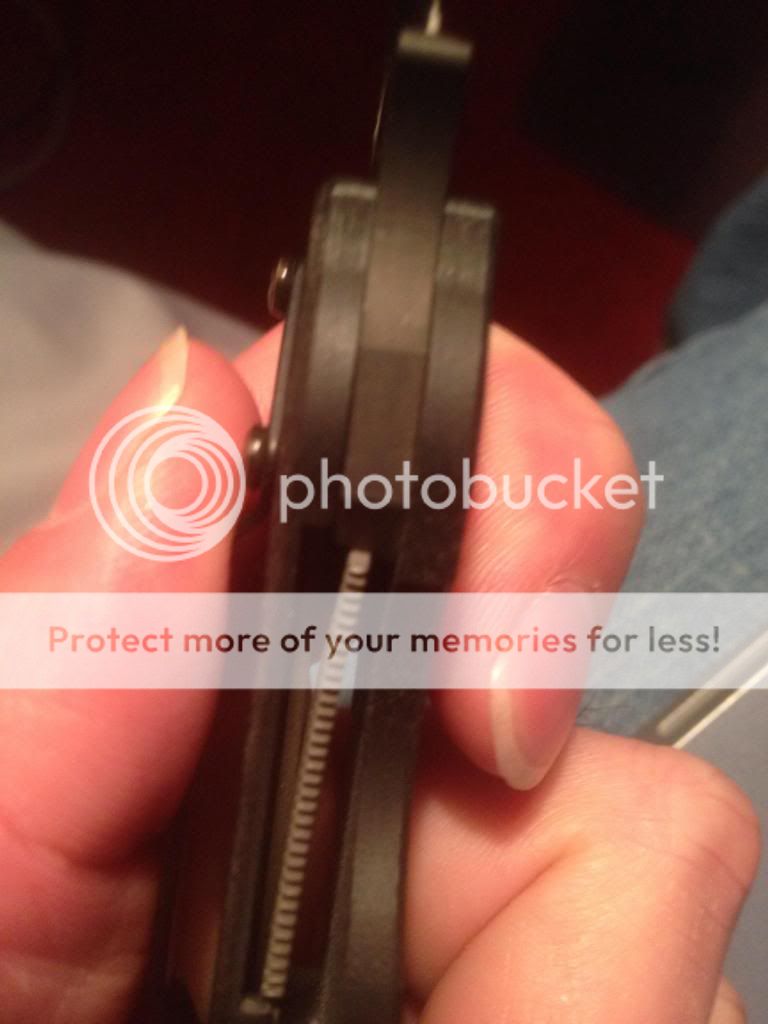

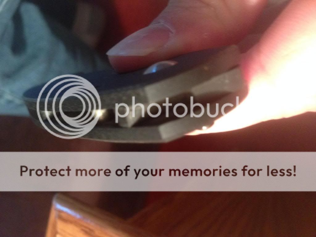

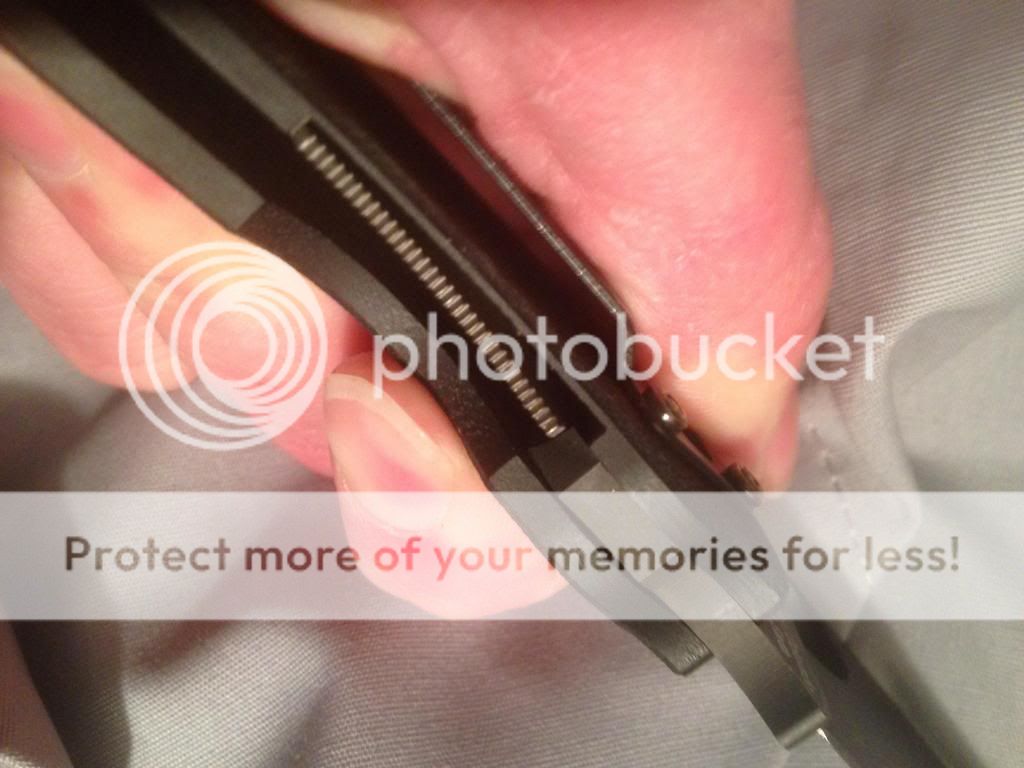

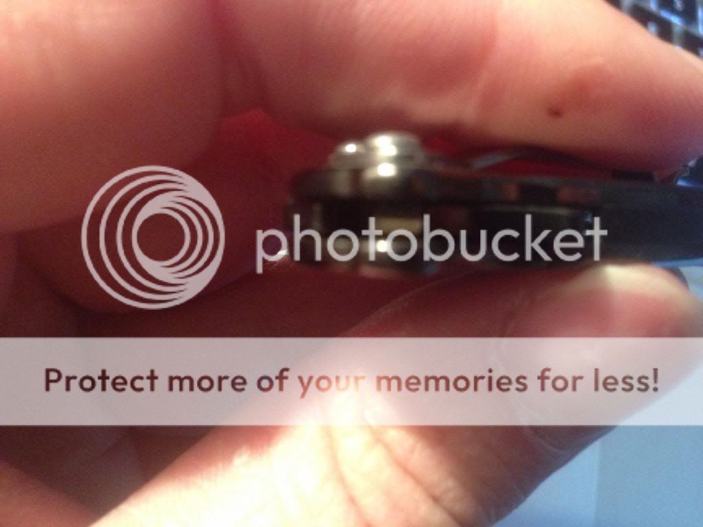

I have at least 3 different examples that have coated (DLC) blades Microtech, Spyderco, & Kershaw all 3 have the blade tangs coated...
In at least one example I can get the lock to deflect as much as 40% towards unlocking (it's normally at about 50% lockup), so far it hasn't actually failed but it'll come darn close.
Just thought it was odd.

I find this hard to believe without pictures. If you have trouble uploading them, I'll gladly put them up for you. Just e-mail them to me.
i'll work on it...
Here ya go...apologize for the poor cell phone photos
Kershaw Chive:
Kershaw Leek:
Spyderco Military:
Microtech Socom Elite A:

Heres some of the lock slip I'm seeing.
Normal state ~50% lock up at rest:
Moderate spine pressure lock up is 10-20%:
