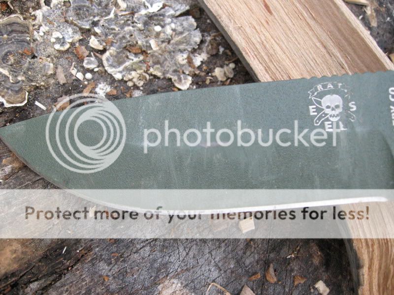

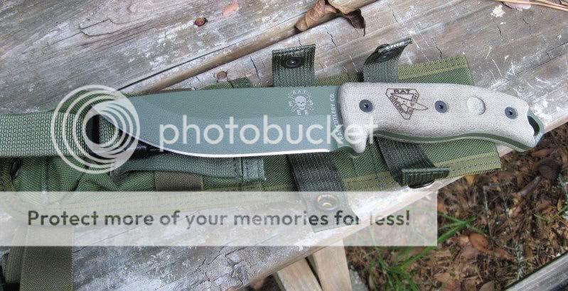

The hardest thing on the coating is batoning through very tough wood. I don't really worry about it. Here is my RC-5 before batoning:
After:
mines a little scuffed fom battoning but whatever. These knives arent meant to look pristine imo
