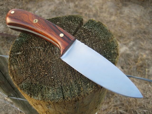

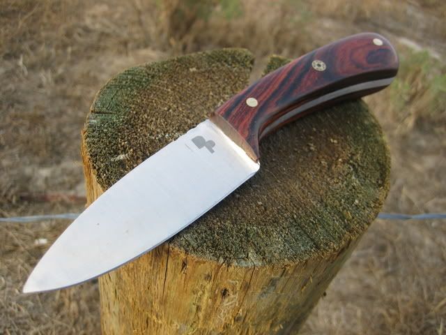

Just finished this one to send out to have a review done. It is my Outdoors man model here are the specs.
3/16" 1095 high carbon steel
Full Tang
Full Taper grind
Blade 3 & 3/4"
Handle 4 & 1/2"
Overall 8 & 1/4"
Hand rubbed blade to 220 grit wet/dry
Two 3/16" Brass pins
One 1/4" Mosaic pin
Figured COCO BOLO handles hand sanded to 400 grit then buffed with white rouge.
THIS ONE IS NOT FOR SALE!!!!! The paper in the background is a spec sheet for the writer. Thanks for looking Doug. Comments welcome.
Nice. I like the handle. It's a good "hand full" and has a nice compound curve. I really don't care for knives that have thin scales and are flat and transition to flat without much radius. The fit looks good, but more finish on the blade would be nice. Remember: These are the words of an idiot.:D:D
Updated photos
good simple knife! Looks like a handy size too :)
