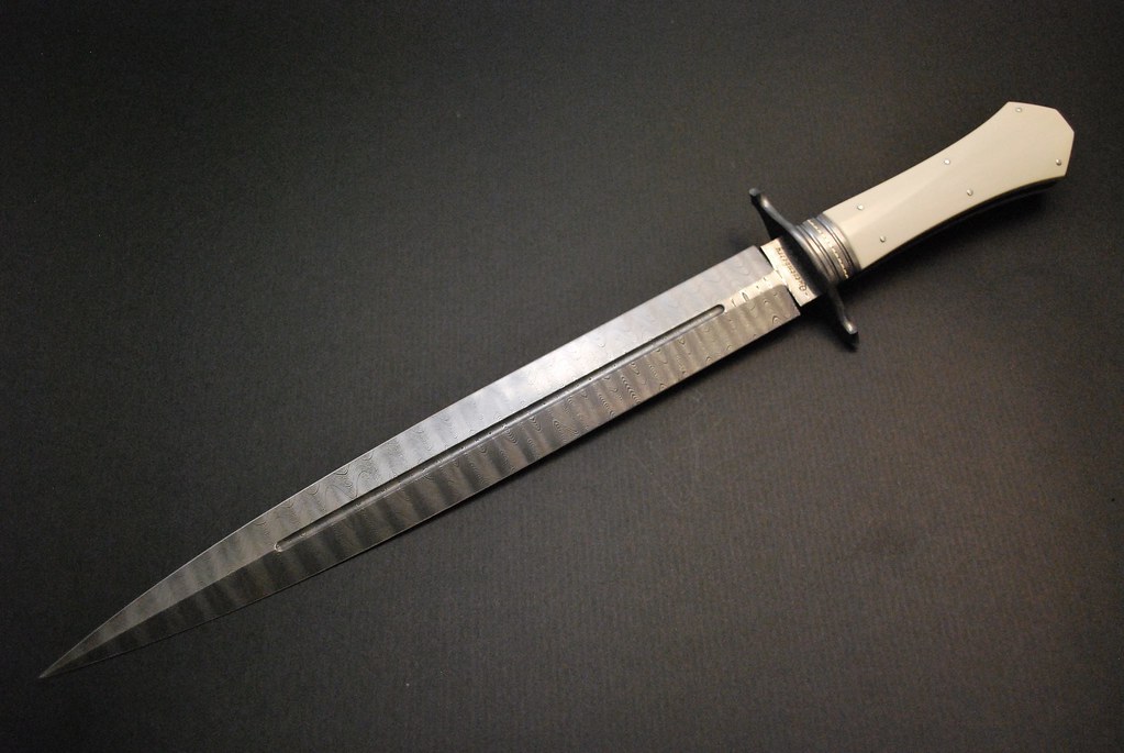

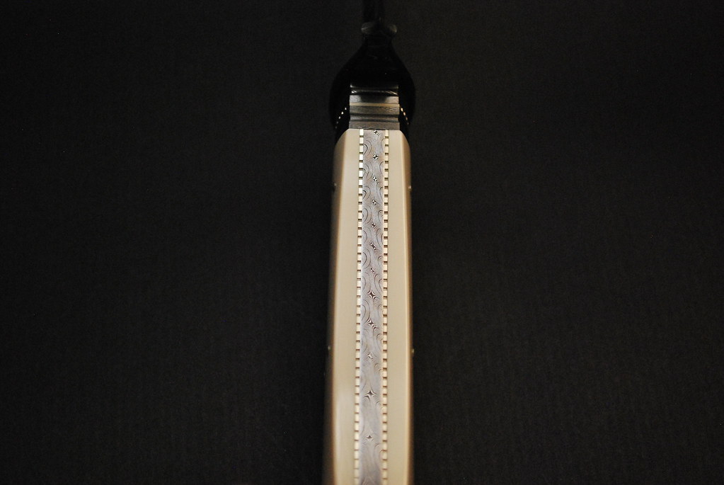

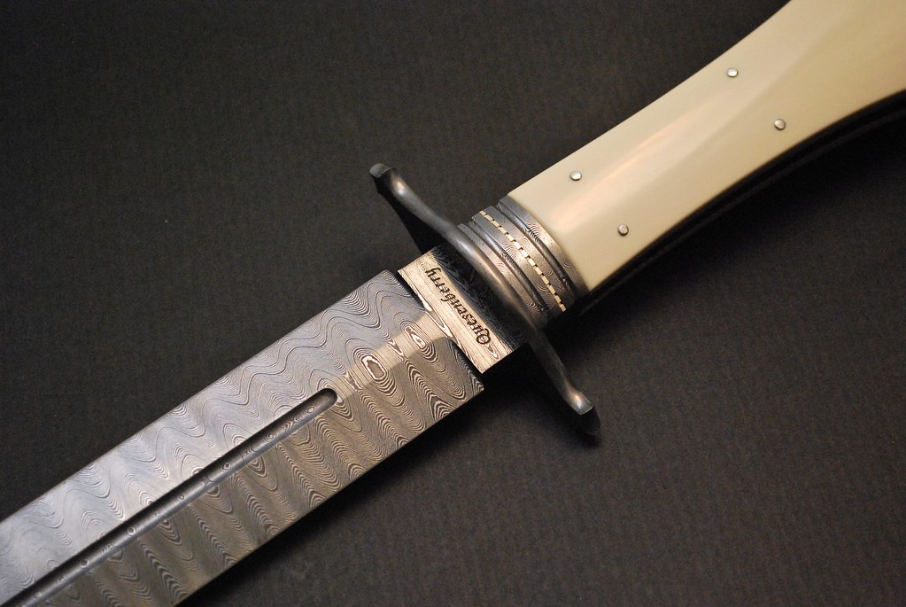

This is a custom order for a fellow forum member. He liked the dagger that's on my avatar but wanted ivory and all damascus fittings. Well here are the results. 11 1/8" ladder pattern blade, OAL 16". The shaped guard is ladder pattern. The grooved spacers are a twist pattern as well as the frame. I made the frame from a piece of 1" wide twist that I cut down the middle and used the inside of the bar to make the outside of the frame, forging to shape. The liners are coined German Silver. The pre-ban Elephant ivory is held together with Sterling Silver domed pins. I'll be taking this one to the San Antonio show for delivery and a real photograph by Point Seven. I'm sure he'll be able to show the chatoyance in the blade and frame. Hope you like it.

Let me add my well done to the others. Someone is going to be very happy when they get to San Antonio. +1 on the tight fuller. A very nice touch to a great knife. What did you use to grind it?
Gary
Gary I used a carbide ball end mill to cut it in and steel rod welded to handles to finish it out with sandpaper.
