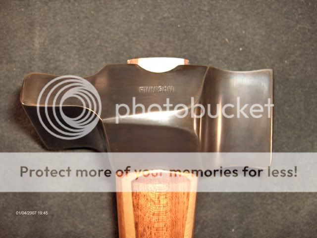

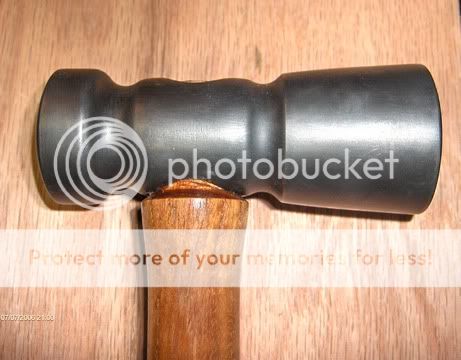

I use Wheeler Premier Cold Blue for my hammers I make. It does not prevent rust but it does slow it down alot. The patchy spots can be prevented by alot of carding between coats. Premier cold blue is a brand new formulation that reacts slower so you can get lighter shades.
All three of these hammers were blued with Wheeler's. You can get several shades which is bit tougher with traditional cold blues that just turn black on contact.

Wow! Those pictures are worth a whole bunch of words. That's exactly the look I'm going for.
