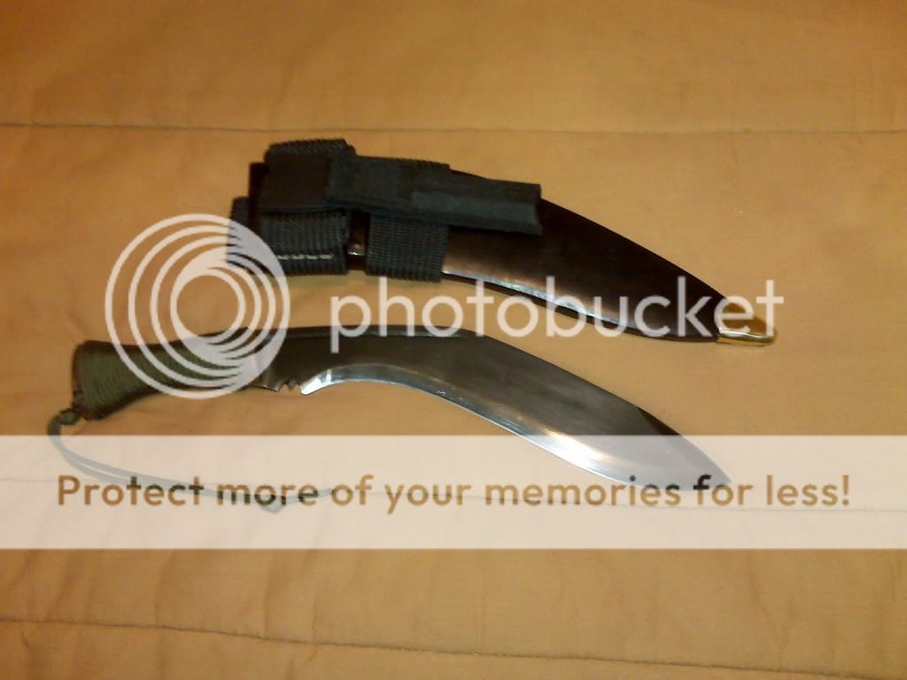

Here Is a cheap Indian kukri that i did for a project. I cold blued it with brownells Oxpho-Blue. It is very wear resistant. It requires carding it with #0 steel wool between coats.
It took adout 6 coats to get a nice uniform coat. It will work on a high polish or a rough one it doesn't matter. By pre oxideing the surface it will wake a knife more rust resistant.

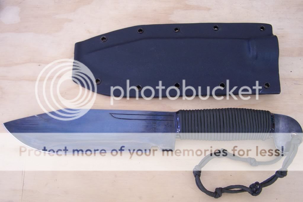

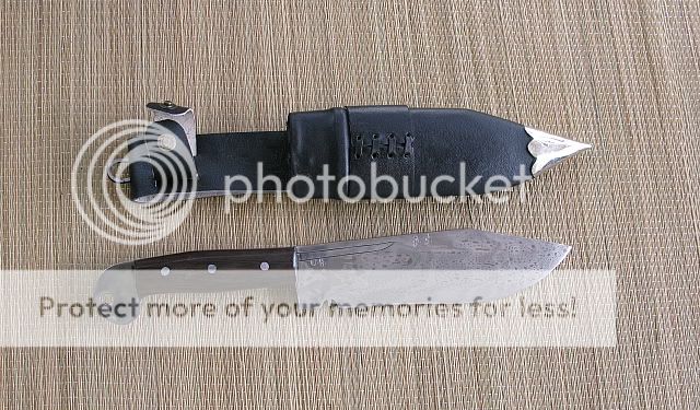

I've blued my H.I. Bowie. I will try to remember to take some pics tonight and post them tomorrow. I also used Oxpho-Blue.

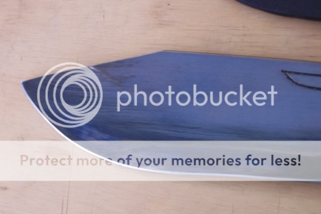

I was feeling industrious so.....
w/flash

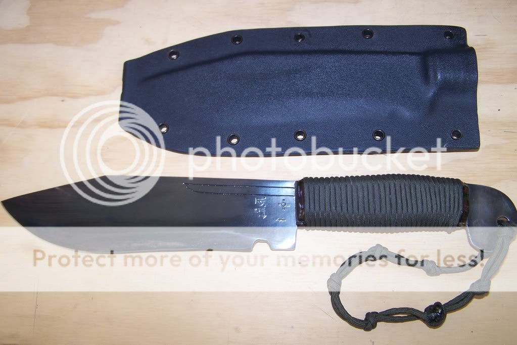

Rub marks are due to the sheath. Here is what it looked like before I started:
