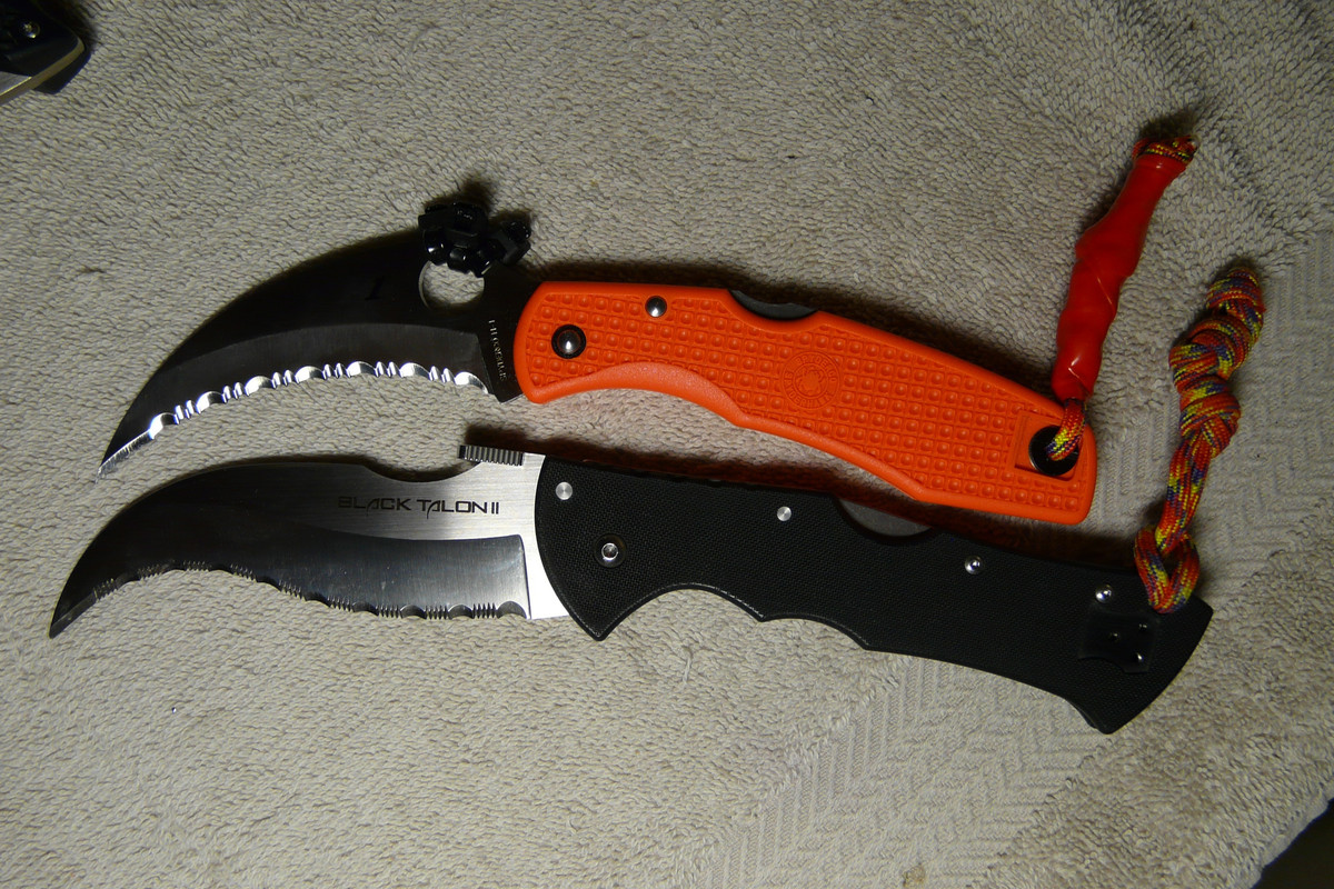

:) I don't have any complaints about rusting of my CS knives under most normal conditions . But I wanted a beach knife that I could carry in and out the salt water all day and not worry over .
It would be great to have CS fill this need . Maybe a rustproof , orange handled BT2 ?

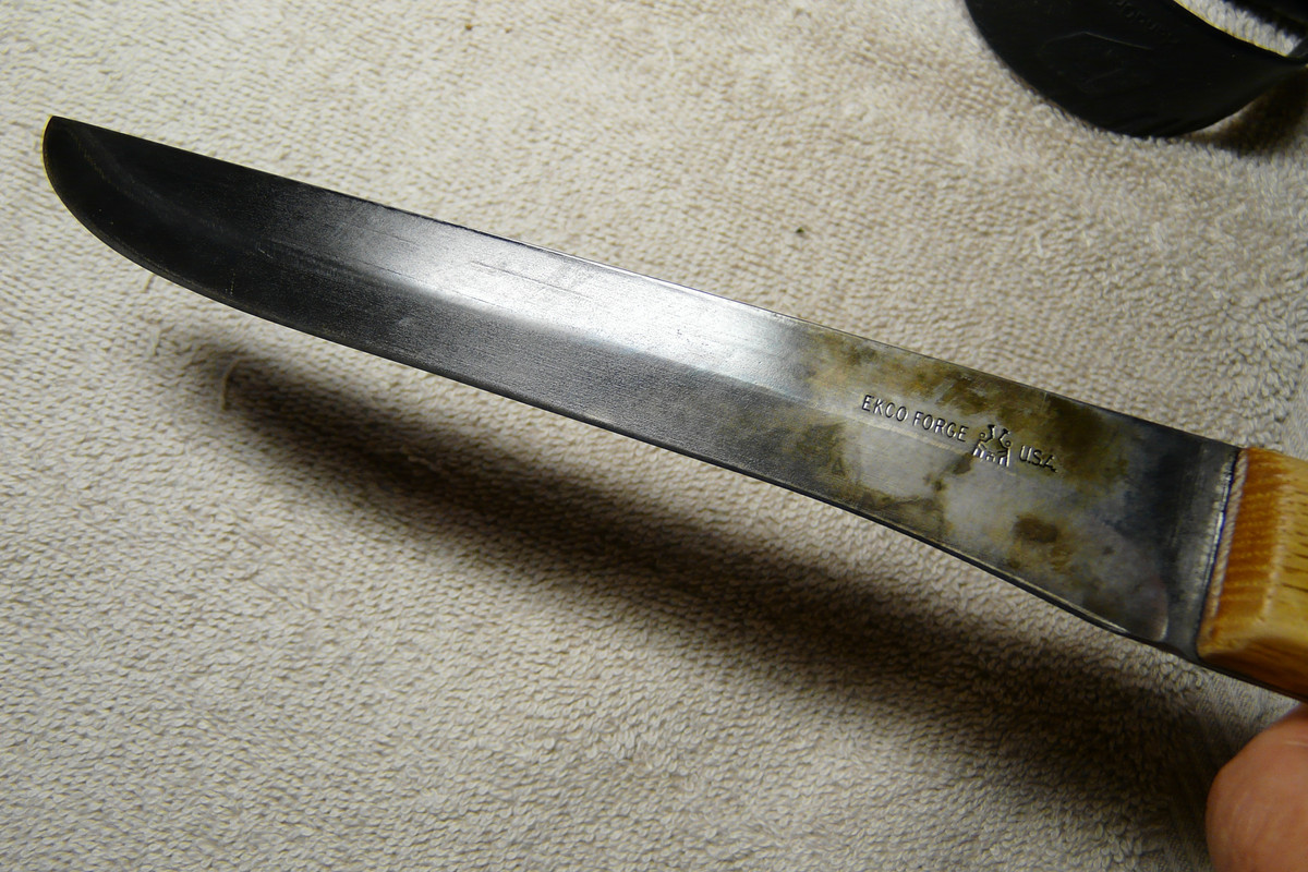

But , here's my most used kitchen knife . Right up your alley . Main bodily fluid exposure is raw pineapple . :p:thumbsup:

Nope ! I'm more saying that , yes : the good old carbon tool steel will do the job . :):thumbsup:
But , it does require a much higher level of maintenance . How much more depending on the type of steel /HT and the exact conditions of usage . :(:thumbsdown:
