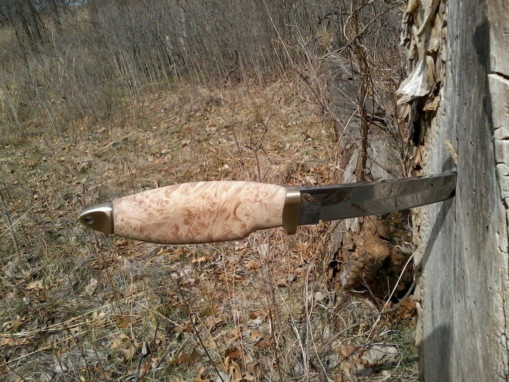

Yep, which is why my Tanto now looks like this:
That stabilized wood should be just fine with soap, DEET or other things. :thumbup:
