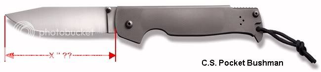

What's the length "X" below ?..frame to tip?
Trying to avoid the policeman-with-a-tape-measure maximum of 4.5"...gotta stay legal, don't you know. :)
I know the specs say "4.5", but is that a frame-to-tip measure or a "sharpened length, beyond the ricasso"?

If the specs say blade length it should be frame to tip; if they say edge length it is only the sharpended portion. However if the blade length limit is 4.5 inches I would chose a smaller knife, because if it is right at that line a LEO might still call it illegal.

I just measured mine and X in the photo measured 4 3/8s inches...
