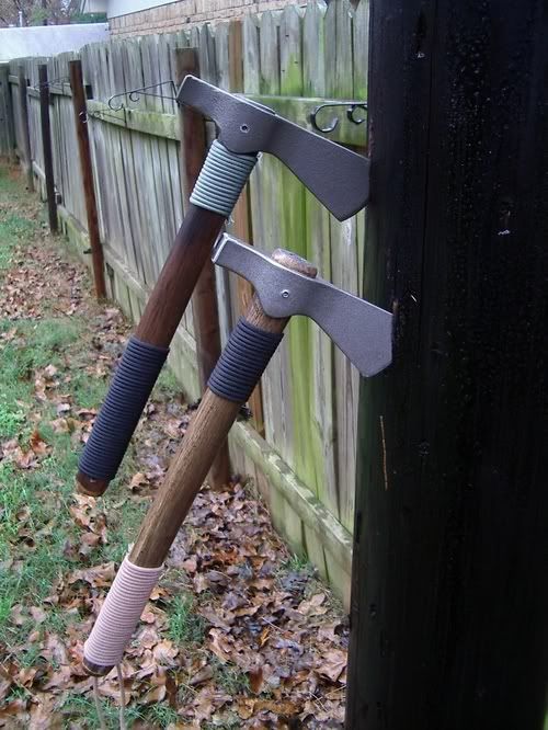

I usually cut a few inches off of the handle, and I have one that I took about 4in off. Its a great feeling tool.
Here are 2 that I redid.
The black handled one is the shorter one.
the other is about 2in shorter than stock and has a lanyard that I put on there.
