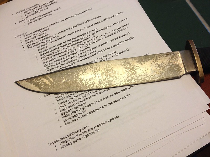

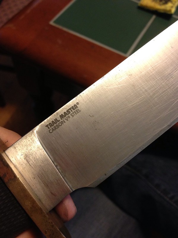

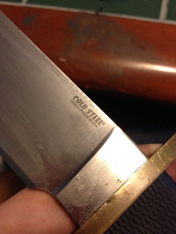

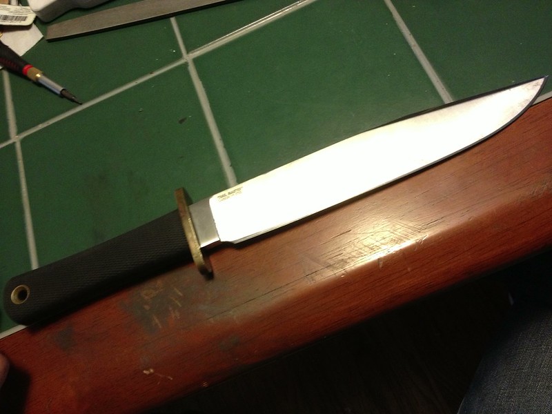

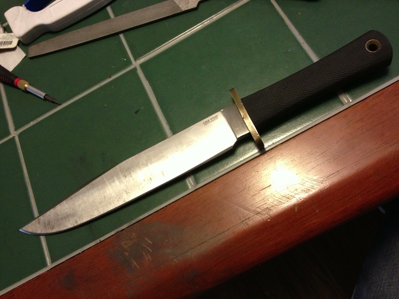

I happened to stumble on a used Cold Steel Trail Master in Carbon V steel and USA made at the flea market for $40. It sounds too good to be true right? Well, I had actually just handled a real Trail Master the other night, so lucky me right? I guess it wouldn't hurt to ask you guys to verify. Unfortunately it doesn't have a sheath.
Two things that had me concerned was the guard is loose up and down not front and back so I don't think it's a real issue, but I want to double check with you guys. The other issue is that the edge is not sharp at all, it was actually flat. Does Cold Steel do a "spa treatement"?
Here are some pictures:
Untitled by Hairlesstwinkie, on Flickr
Looks real to me. You got a wicked deal. Call Cold Steel about fixing the edge and guard, they'll hook you up. I've never sent a knife in for a spa treatment, but I expect good things from Cold Steel.

Ouch,
I didn't know you could use clr on metal because of the corrosive agents in it...I've only used it on glass.
I use WD40 or gun oil to clean my carbon blades.
Don't EVER use CLR on Carbon 5...
I guess you already get that now...
go from 600 to 1000 or more wet or dry autobody sandpaper on a sanding block to keep corners sharp.
Use water or WD40 to lube.
RenWax for long term storage.
Ballistol or EEZOX and #0000 steel wool for carry/camp etc. Stag and Nickel Silver fix-up, (WOW!!).
Kydex or a really heavy leather sheath made from 1/4 oak sole stock and snaps and rivets, sewn (no velcro).
Factory Re-sharpen, or find somebody thats really good w/ a Wicked Edge system.
1000 grit edge bevel polish is enough IMHO.

'Ya probably messed up any collector value it had, and an older TM has a bit, so, maybe you should have tried something like Flitz or Metal Glo, would go a long way to preserving the value and cleans well. It is a real TM, a bit older, '90's probably, possibly, possibly '80's. Man, why do I never find a TM for $40?? All I get is a whole lot of free stinkeye.

You will find that unless you STAY on her, w/ EEZOX, or RenWax---she will PIT on you---I mean little black holes, not any of that fancy red rust stuff.
