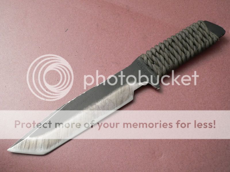

After using my awesome trailmaster in sk5 awhile,it was getting messed up. So today I was kinda bored and decided to experiment a little bit. I first gave it a vinegar bath. I didnt like the way it came out so this it what I did.
First I got some 600 grit sandpaper and buffed out the stained discolored brass to a nice even semi-dull brass, looks alot better.
[/IMG]
Then I wet sanded the entire blade with 600 grit sandpaper.
[/IMG]
After that I covered the blade in mustard, then blotted it with cheesecloth and waited 15 min.
[/IMG]
Then I wiped it off with a paper towel and did the mustard and blot a second time, waited another 15 min. Heres second coat.
[/IMG]
Washed and dried the blade then buffed it with grade 0 steel wool. Starting to look good!
[/IMG]
After that I cut six stripes of paper towel and covered them in mustard, and wrapped them around the blade in the design I wanted, then put a heavy book on top to keep it flat and pressed, waited 20 min then washed it again and buffed again with grade 0 steel wool. Heres the end result. The knife looks so good now I kinda want to rehandle it with G10. I just have to re sharpen it and its done. Hope ya like it!!
[/IMG]
[/IMG]
