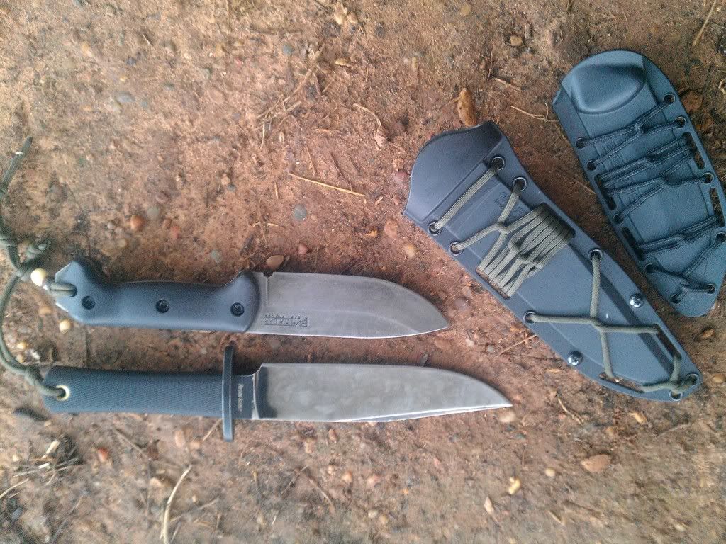

Kraton is just a type of rubber, so yes over a long time you will have a slight smoothing out of bumps, but its still grippy stuff. Have had mine for awhile and it has not broken down at all so I think you will be good to go. The sheath is not bad, its a snap in securex plastic sheath. I removed the handle snap on mine to make it carry how I want it too and I have had to reheat the mouth of the sheath once before to make it grip tighter, BUT I highly doubt you are going to thin the knife to the point of making it not hold in the sheath. The sheath retains by nubs under the guard not on the blade surface. Kind of hard to explain but there yah go lol.
Modified sheath...

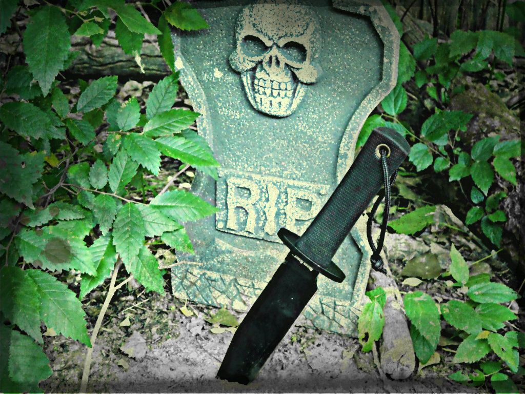

and a pretty old pic for giggles.
