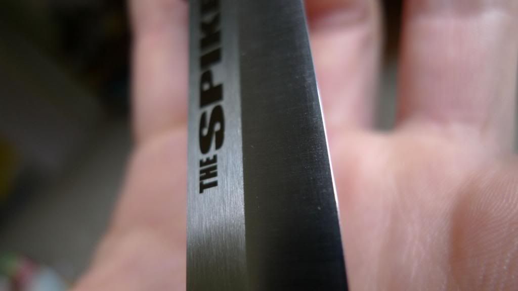

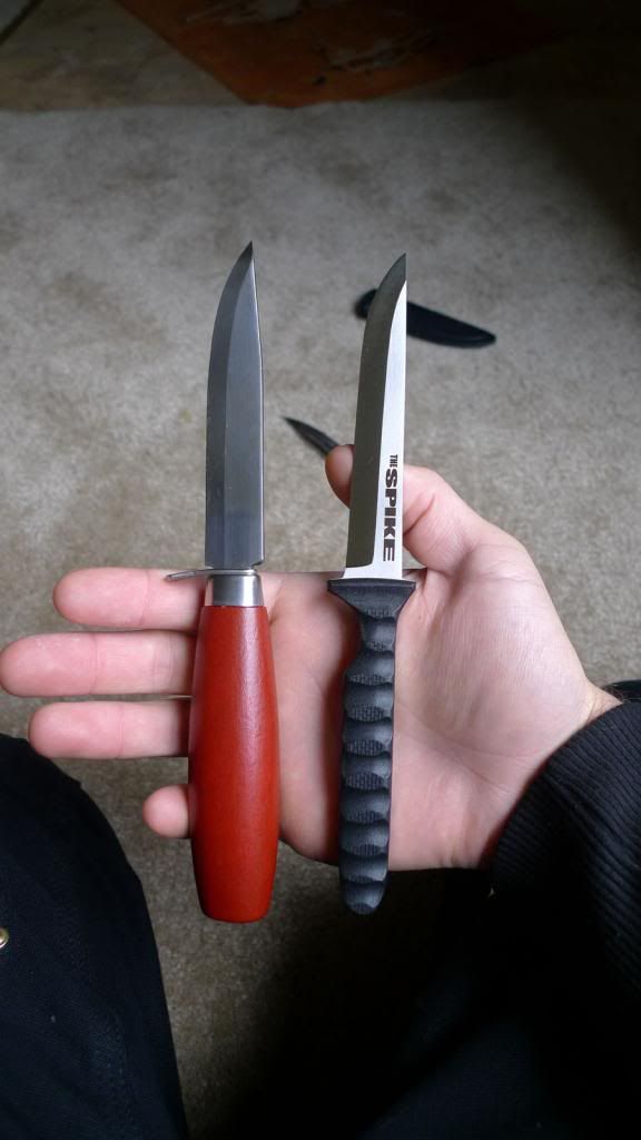

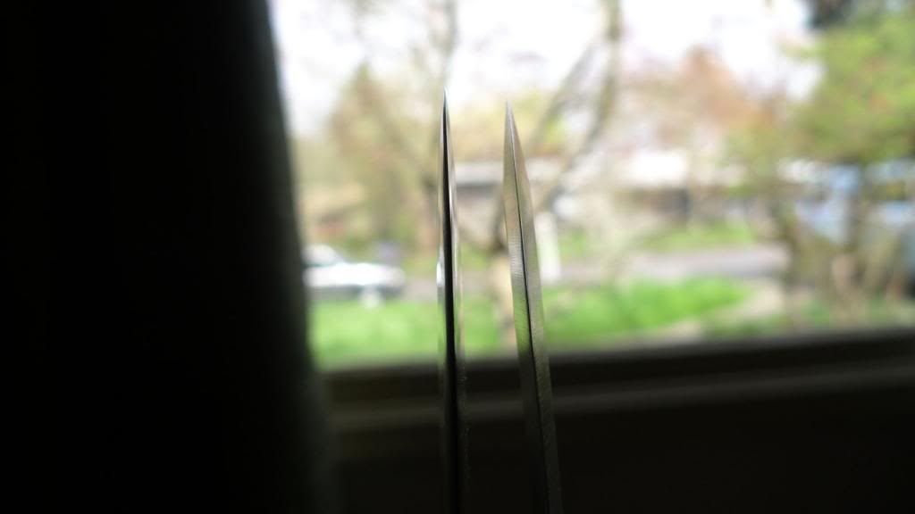

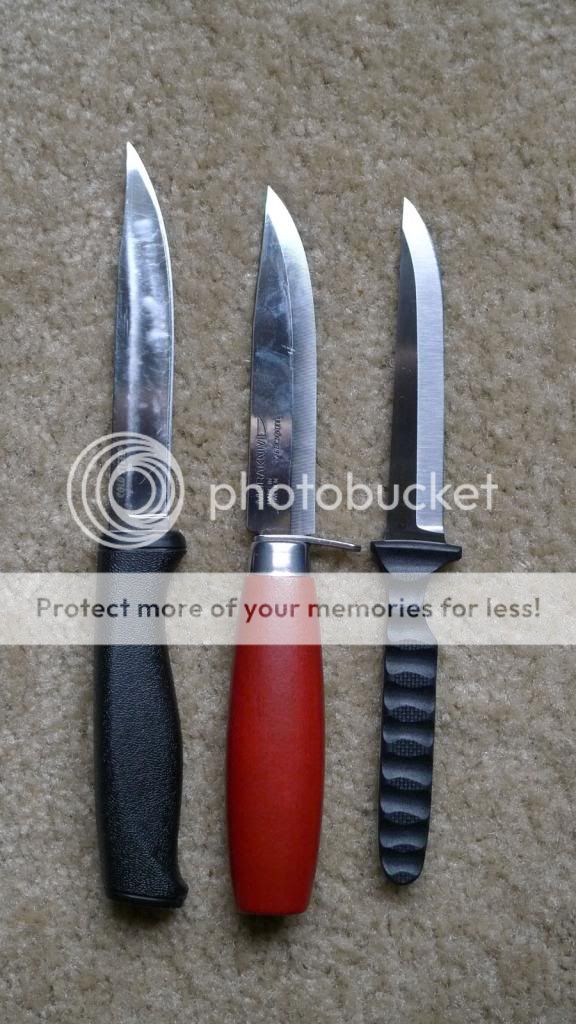

This is it next to the CS Finn Wolf because it's in the same price range and the same compact design theory, and a Mora 612. I say that the spike is a Puuko because it is. It's the same overall shape and it has a true zero ground geometry - something I never would have expected out of cold steel. The grind is identical to that of the Mora except on a 3mm thick blade. The grind heigth is only 5/16". Since the blade thickness is 3mm that makes the grind angle 21 degrees.

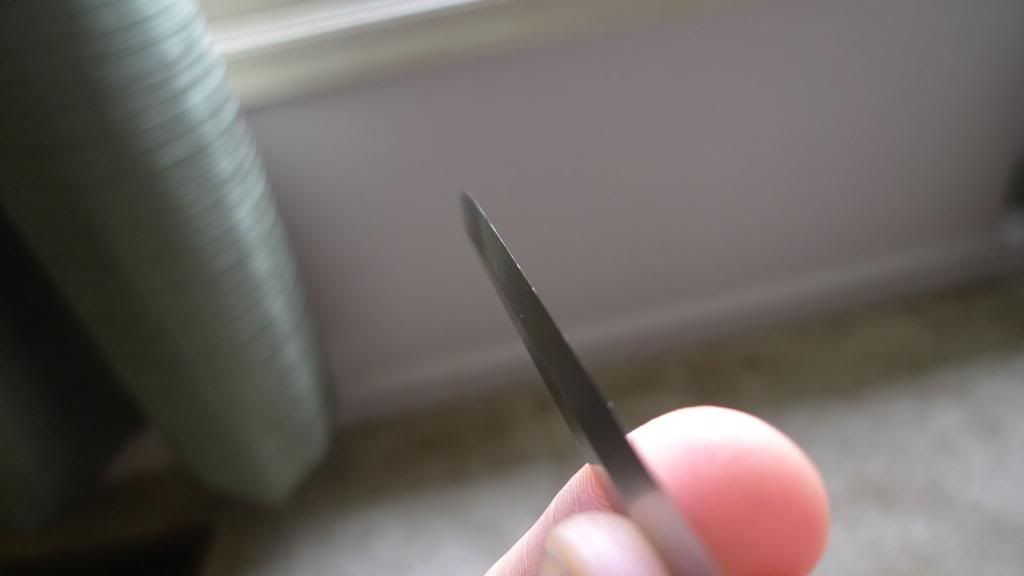

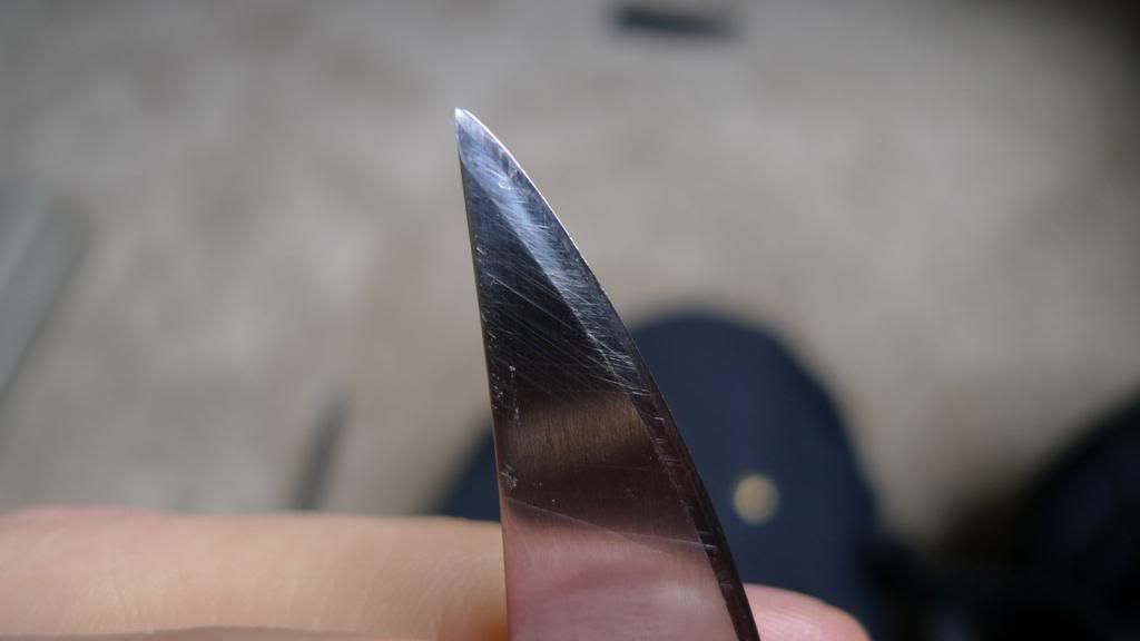

You can see the thickness of the grinds from this tip shot, the thicker Spike being a much wider triangle than the 612, and the hollow ground finn wolf looks like a kitchen knife by comparison.

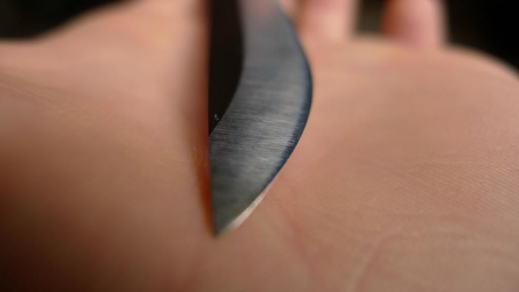

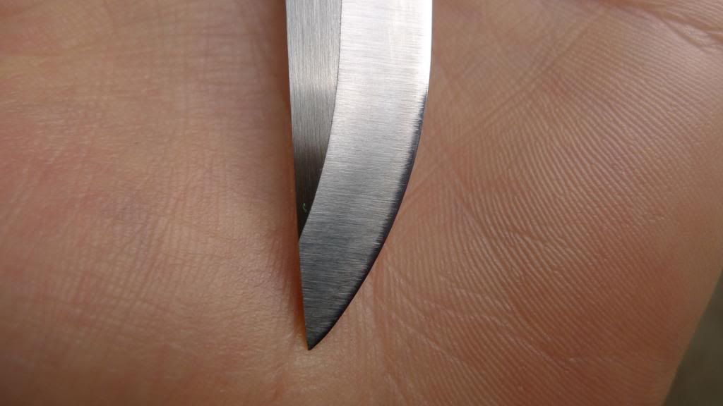

It is a true zero in the sense that it's brought to an apex in the initial grind without any secondary bevels. However, there is technically a micro bevel in the form an edge refining polish convexing. It's not enough to feel with your finger, it's just enough to bring the edge up to a fine grit vs. the rougher grit finish of the main grind. It's more pronounced on the belly and almost not visible at the straight edge.
The grinds are crisp everywhere on the knife.

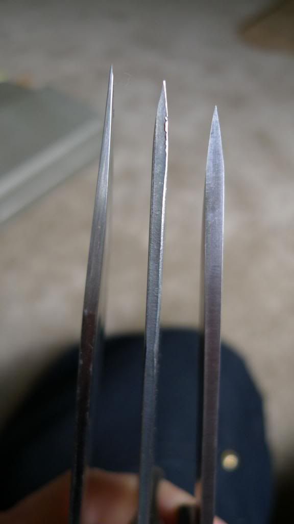

This is an example of the 18 degree relief and 21 degree primary secondary bevels on the Finn Wolf.

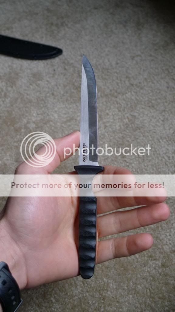

The handle is much slimmer than the Mora, but it's still quite managable. The heavy scalloping on the handle manages to be grippy

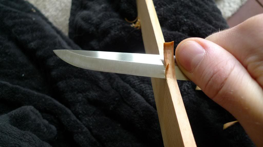

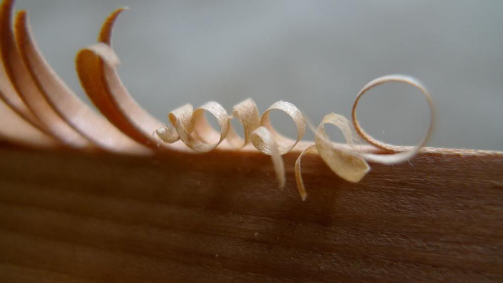

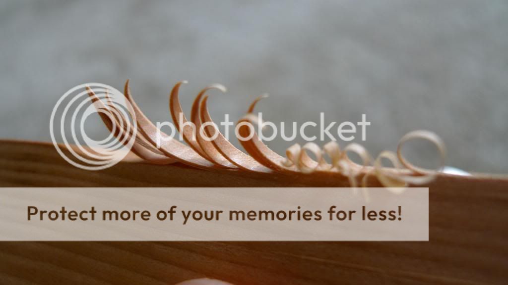

It works like any other puuko/chisel, good control of minute detail for wood carving and shaving.
You can produce thick shavings:
Or translucent paper thin shavings:

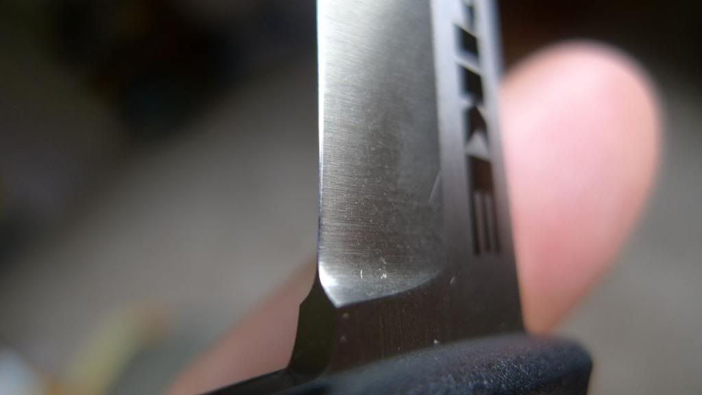

The steel is not ideal for a zero grind. It's a soft stainless, so it mashes dents and rolls quickly even under moderate use. The slight benefit is that it takes well to burnishing and steeling. The bright line in this next photo shows the edge malformation reflecting light after moderate use - all of it goes away with a few hard passes from a Hock brand (higher hardness than others) burnishing rod. So if you carry a 5" burnishing rod with you into the woods it comes back to sharp easily.

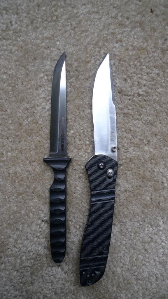

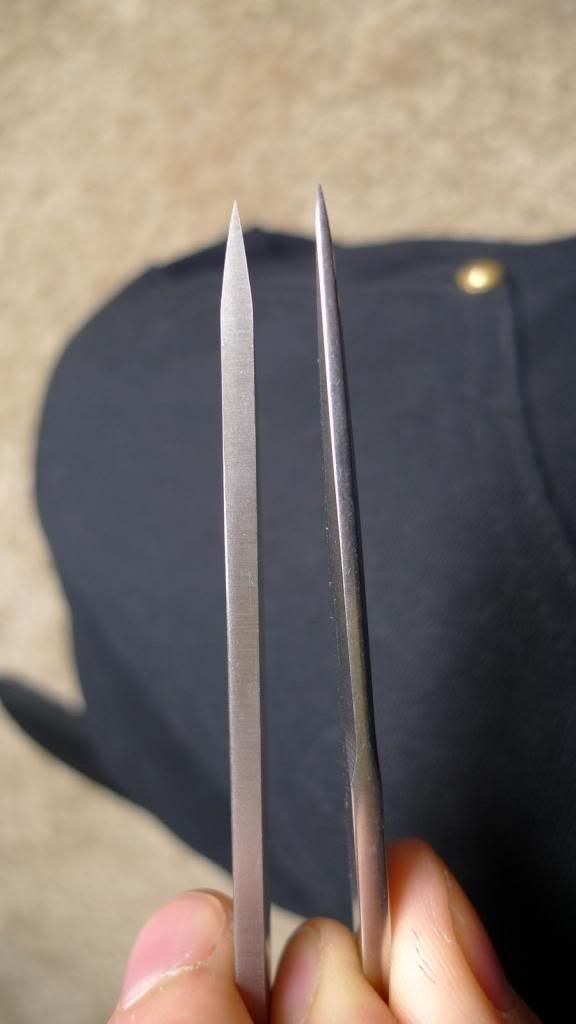

Final thoughts: would I carry this? no. I would carry it over a mora because it's more compact and mora's steel isn't the best either, but I wouldn't carry it over a full flat anything. My big fixed blade carry takes care of heavy work like splitting, and my BM710 takes care of any carving I need with better steel, an equivalently fine edge (21 degrees+relief) and a thinner slicing profile. I know that the whole point of a zero ground puuko is that it's a chisel - it lets you carve with precision.... That isn't more important to me in an edc than slicing ability.
This is an example of the difference in grinds between slightly modified bm710 and the spike:
Even though I'd choose other knives over it for edc - I respect it greatly for what it is. It's an excellently compact design with absolutely no waisted space anywhere, no choil, no extended pommell, no extra long ricasso. The true zero edge is a surprise coming from cold steel (since it's not a strong edge type at all) and it works every bit as well as you'd expect. I bought this 99% knowing that I wouldn't actually edc it, but wanting it as a fine cheap example of a blade done right.
