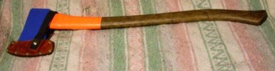

With all this talk about boy's axes, I picked one up when it came available. Just spent the last hour oiling the handle (it has lots of lengthwise surface cracks) and cleaning up the head. I hope the handle lasts cause it is epoxied to the top of the head. I'll post pictures after I get it cleaned up, a couple of coats of Krylon on it, sharpened, and tested.

I went out and spent a few minutes splitting wood with the boys ax. I needed to put a lot more snap to it, otherwise it wouldn't splt through. the only problem I had was with knots. It just didn't have enough momentum to power through some of them. For the most part I was impressed.
For being about half the size the boys ax is pretty effective. Although, if it was all I had to splt wood, I'd want the wood cut to 12" - 14" lengths instead of
16" - 18" lengths. The handle worked fine and was a pleasure to use. Very little shock (close to none) without gloves. I'll clean it up a little more then set it up as a camping ax. The last picture shows where epoxy was used to anchor the handle. I'll post a couple of more pictures when it is finished.

Well I got her finished up. A coat of Rust-oleum primer and blue paint. And an edge protector cause she sharpened up real nice.
I tried to wrap part of the handle with duct tape but it didn't turn out as well as I'd liked. This is so she would show up better while camping. Someone else had done something like this to their ax on the forum and I liked the idea. I think they painted their handle though. If it irritates my hand. I'll take it off.
