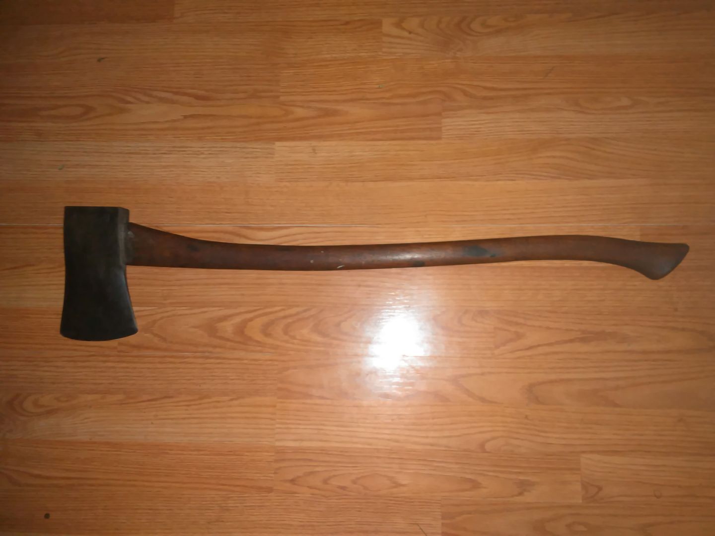

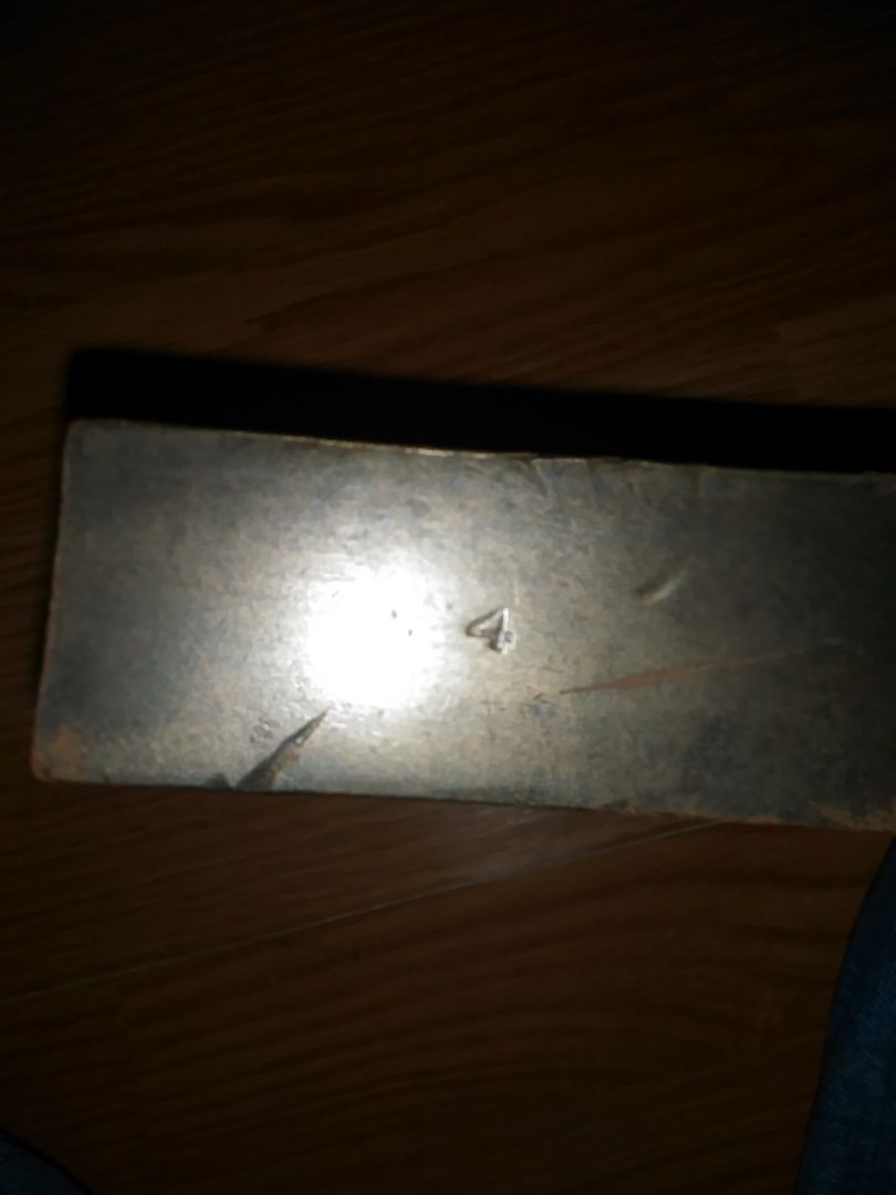

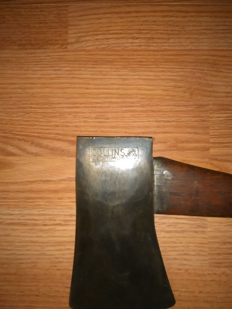

Here you go, it's a 4 lb. head though. The haft is exactly 35" long, 1 3/8" wide, and 13/16th thick.
I don't have an original Legitimus haft but maybe you can make do with this.
