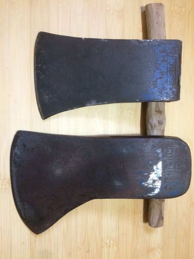

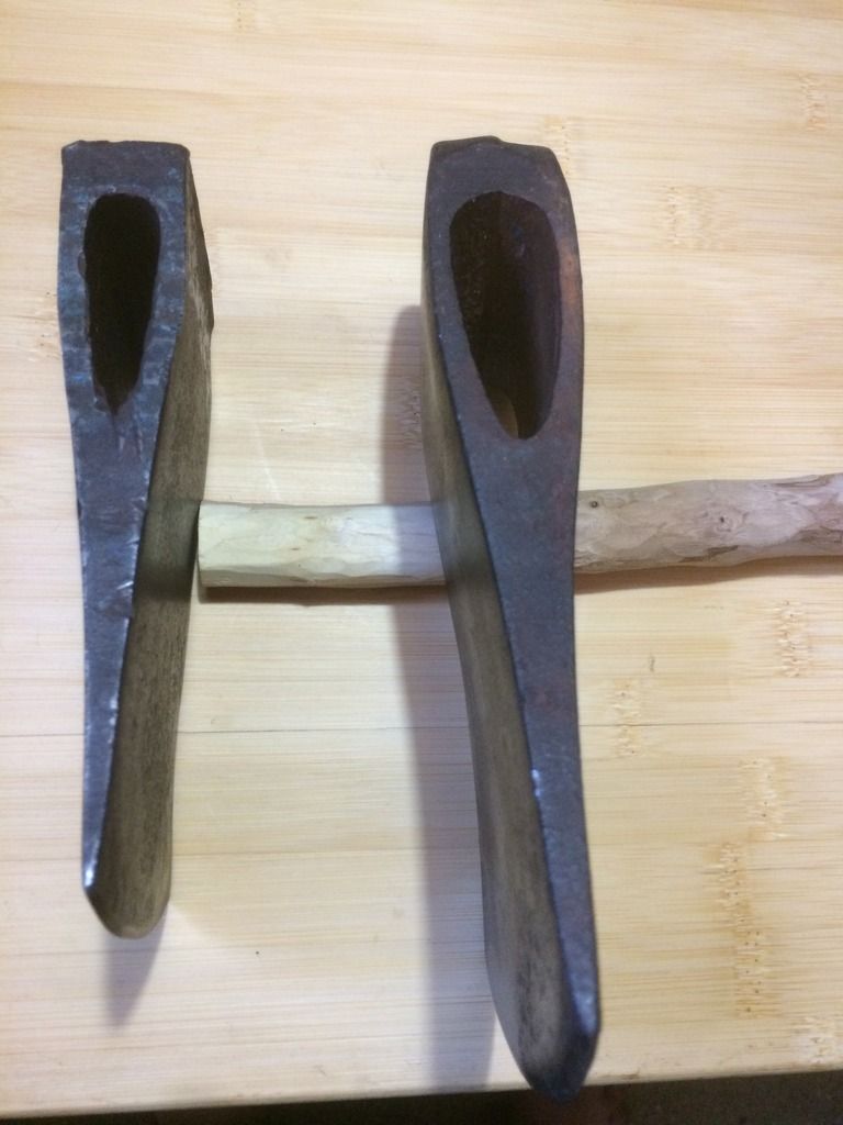

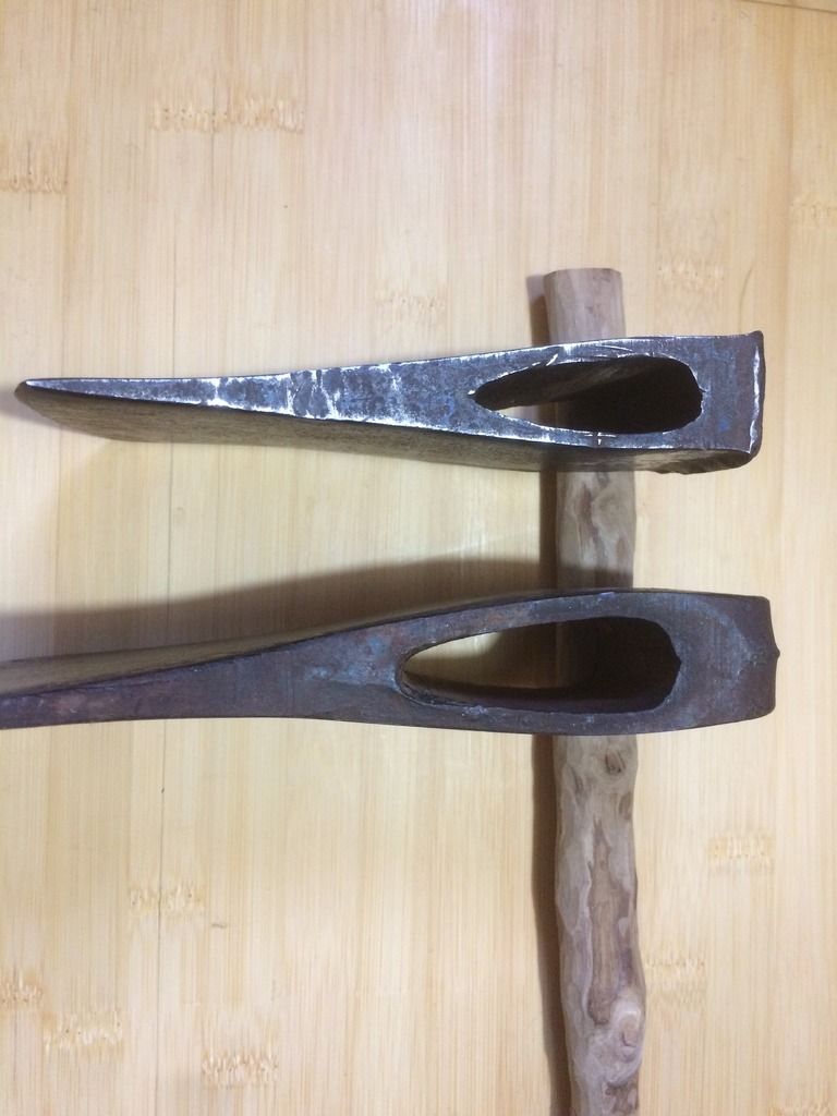

Here are the only Collins's that I have come across a boys at 1lb 15.3 oz the 3 1/2lb thats 3lb 2.7oz and not so much grinding. This for reference only.

If this helps ( adding to rickoff's examples ) here's my homestead which is pre Mann ( so pre 1966) which if the grinding marks means anything would make this an example of probably a later production pre mann Collins axe
( though it does seem fairly thin compared to others )
