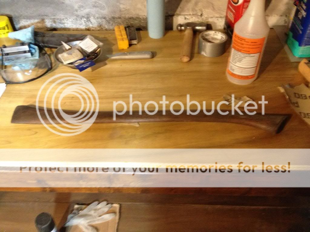

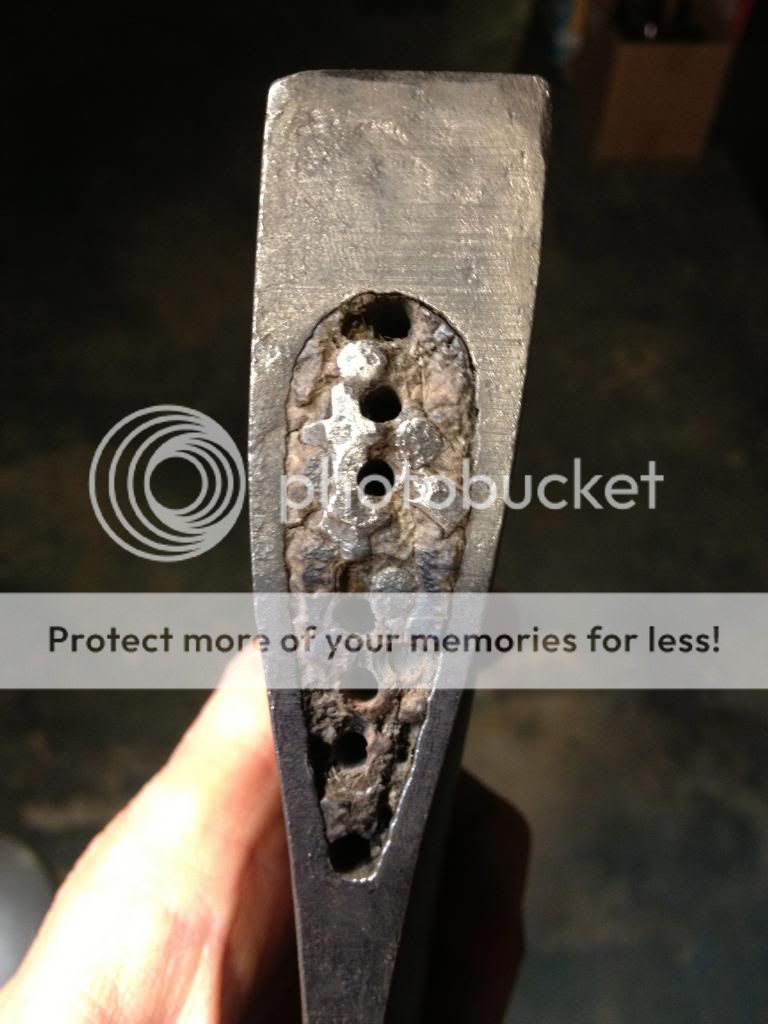

Well, I failed to salvage the beautiful old handle on my Collins Legitimus. I guess I still lack some crucial skills.

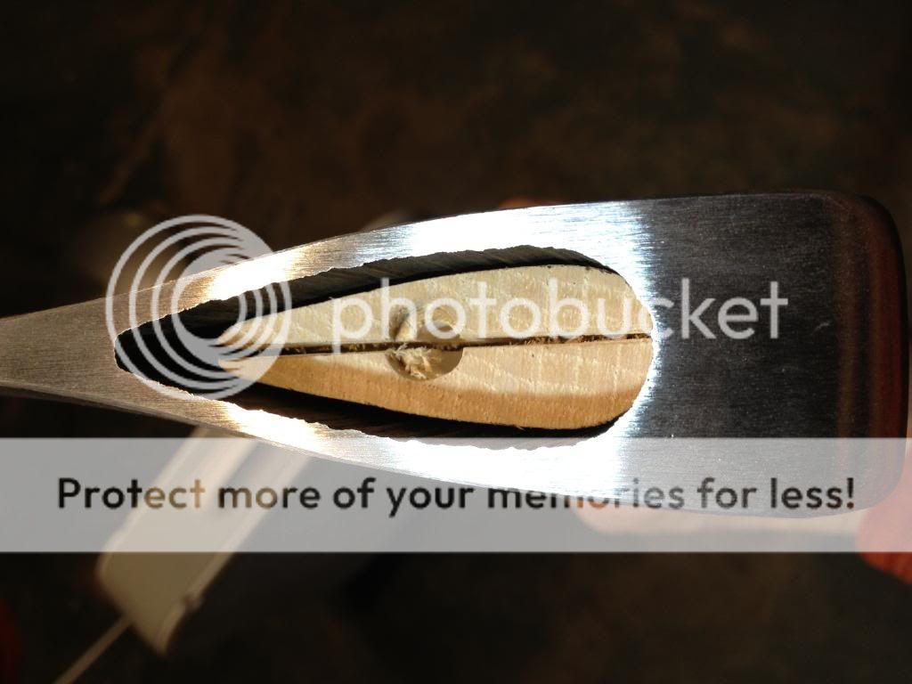

Here is the head from the top. Just too much metal for me to get out.
I drilled around where I could, but the thing was getting ugly and still wouldn't budge. I sadly decide to cut it off.

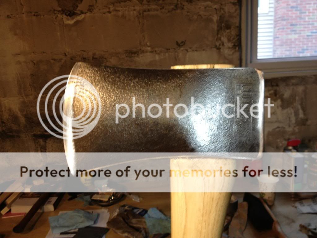

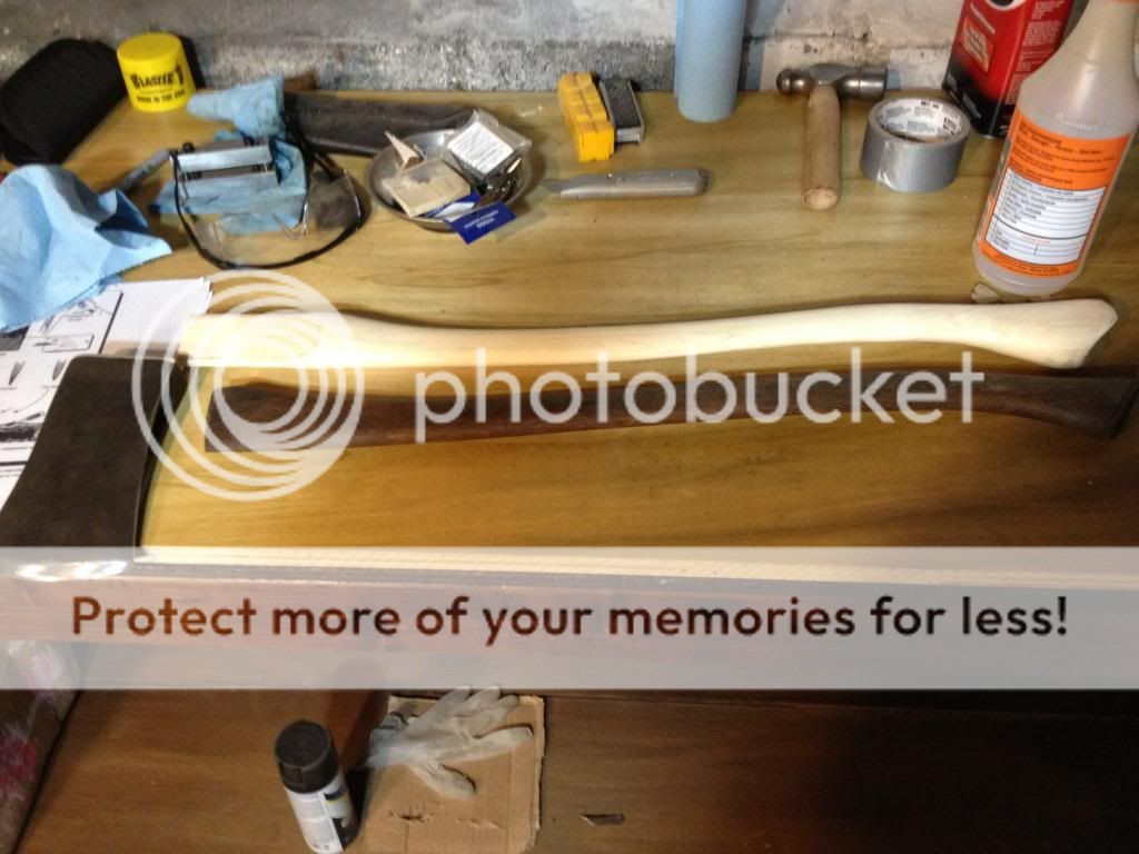

Now for the good news. I had a boys axe handle that was pretty close in size to the original. Strangely, even though the head weighs nearly 3.5 lbs., the eye is closer to that of a boy's axe.

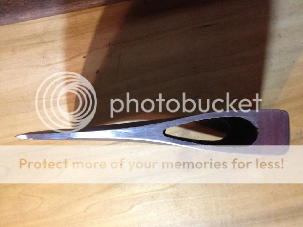

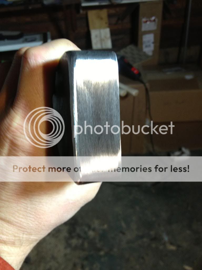

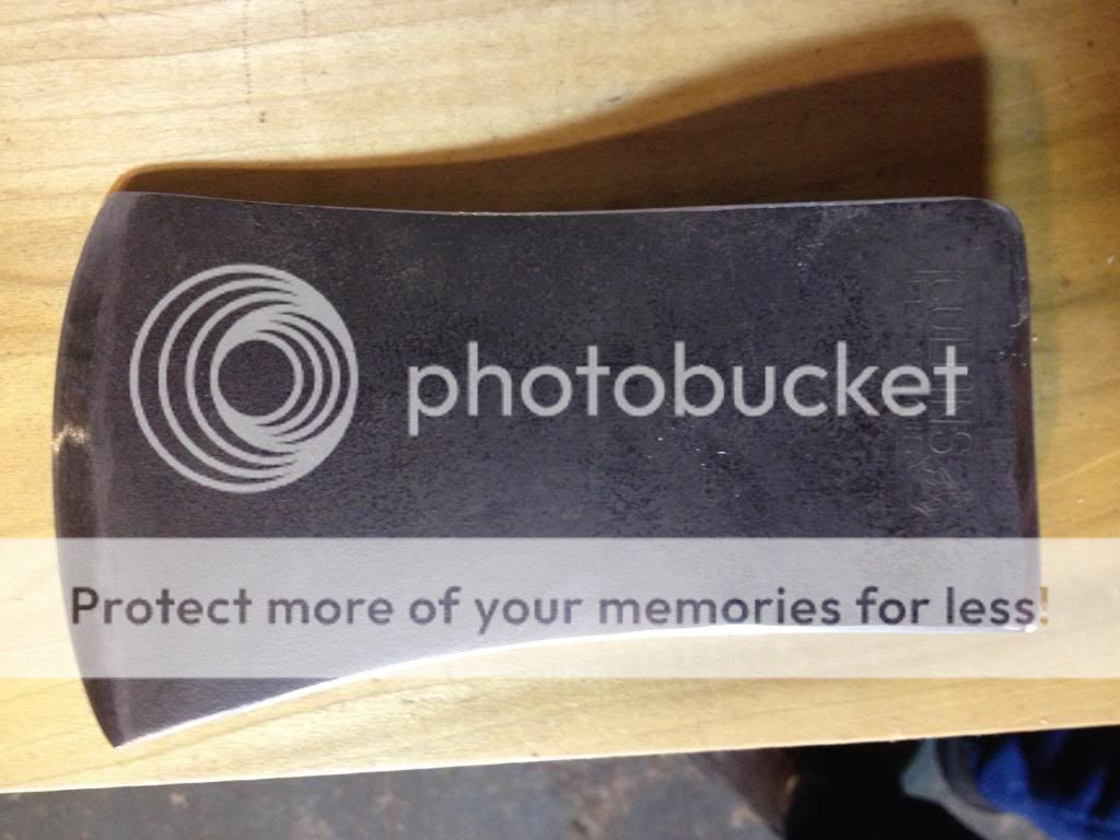

This also gave me a chance to clean up the head a bit better than I could have with it mounted.
Here are some shots of the eye and handle before any work had been done.
And here they are after very minimal filing and cutting off a bit of the extra haft.

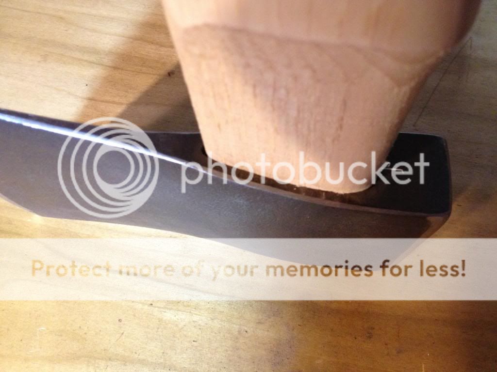

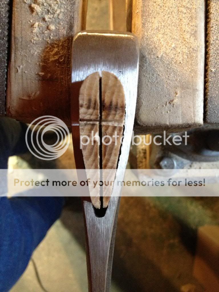

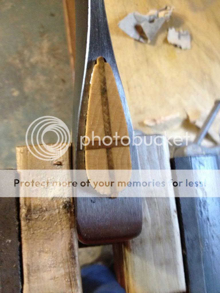

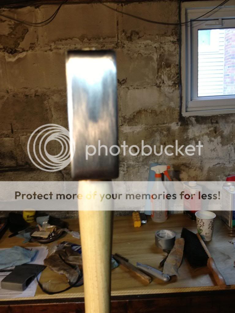

The fit was good overall, except for the gap up front. I decided to remedy this with the two wedge system I learned here.

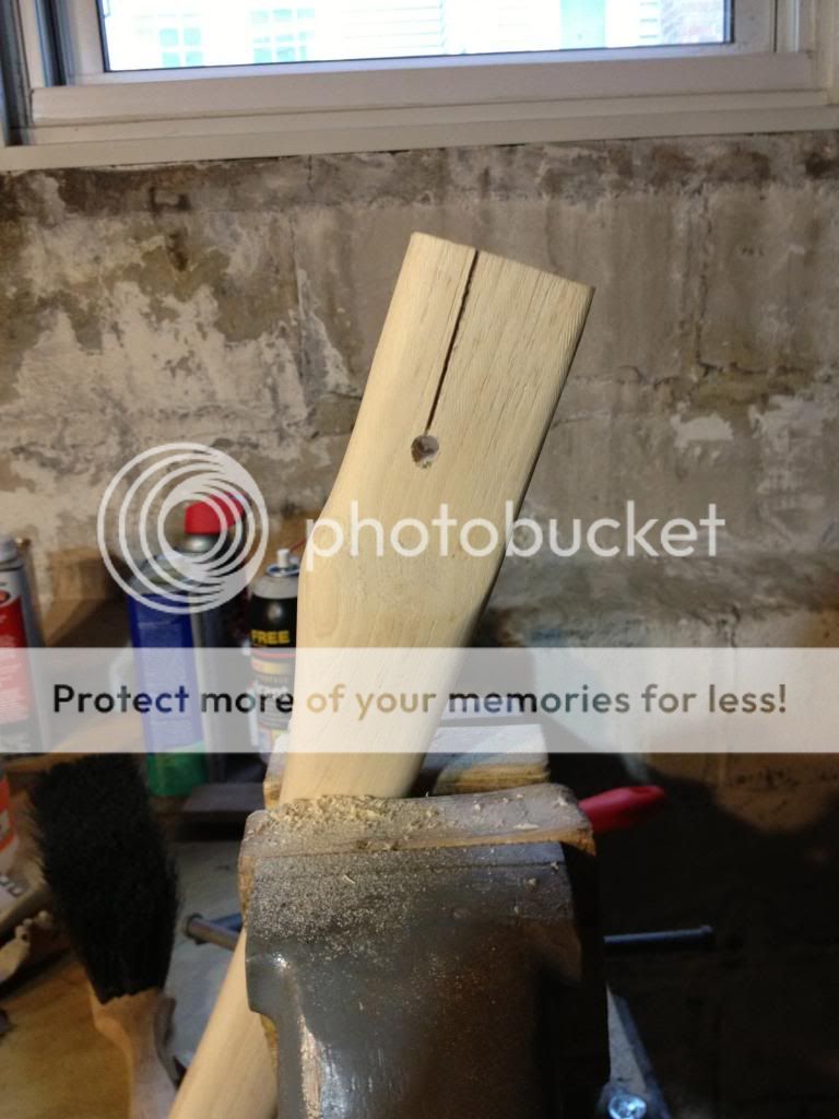

I sawed a second kerf and drilled a hole to prevent cracking.

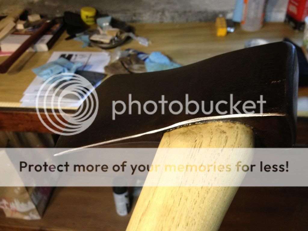

I then worked some wedges down to a nice profile and thickness. They went in nicely, but I still wound up with a bit of space up front. :grumpy:
I decided, for now, to leave the top of the haft a bit proud. Grinding it down flush would likely help with the appearance of the wedges.
Aside from the slight problems mentioned above, I was happy with some of the new things I did on this axe, like smoothing out the transitions between the shoulders and heel, which I used to leave as they came from the factory.
Overall, it was fun and I continue to learn a lot.

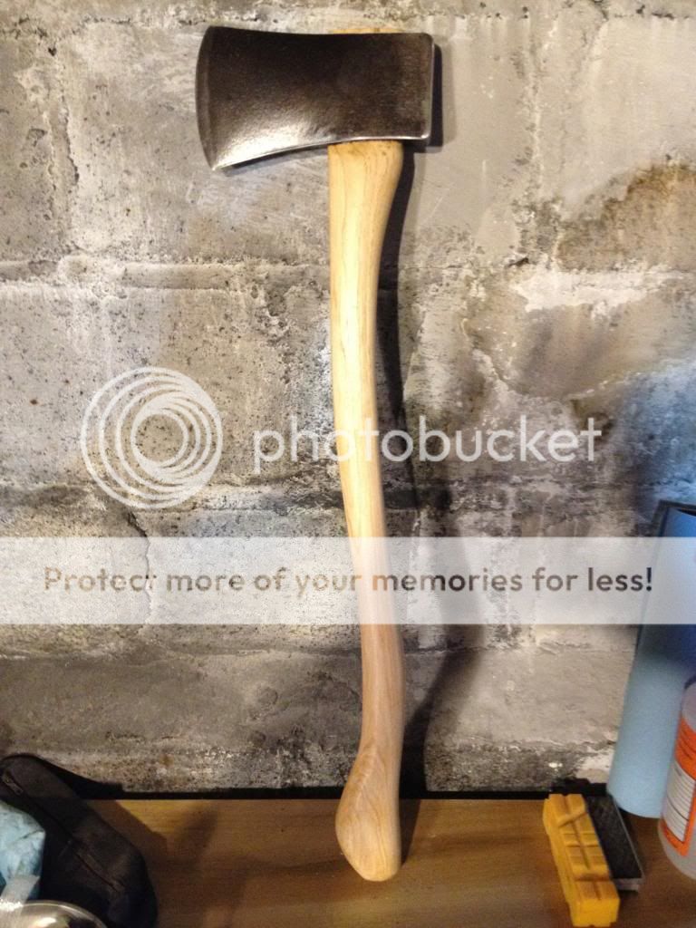

This is an interesting combination of a pretty good sized axe (3 lbs. 5 oz. after all my grinding) on a pretty small, slim handle. Should be interesting.
I always prefer to do all my work to an axe head before I hang it. It's just easier without the handle in the way.
Let us know how you like that. It's odd to see a boy's axe eye in such a heavy axe but they did seem to fit. I like your technique for stopping the crack below the cross wedge. I haven't had a chance to try that yet.
Awesome restoration, thanks for sharing. That's a very trick two wedge system, I think I'll try that sometime.
That's a beauty. That 2-wedge system with the drilled hole is a great idea that I learned just now, thanks for posting this.
That looks great. Ive used the two wedge system before as well. really sets it off! The hole to stop it from cracking is a great idea. Thank you.
