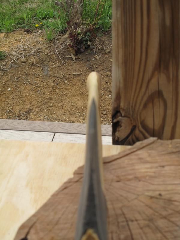

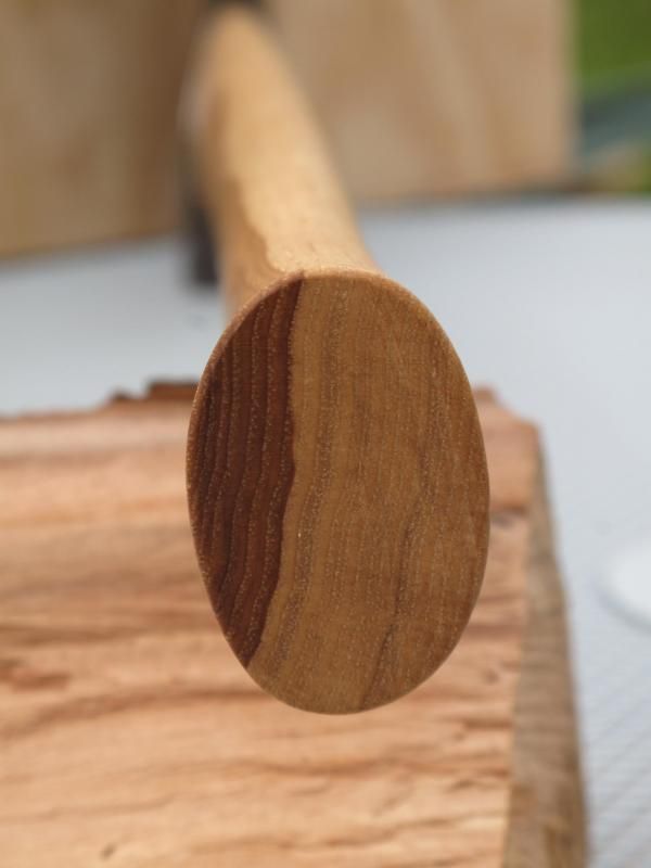

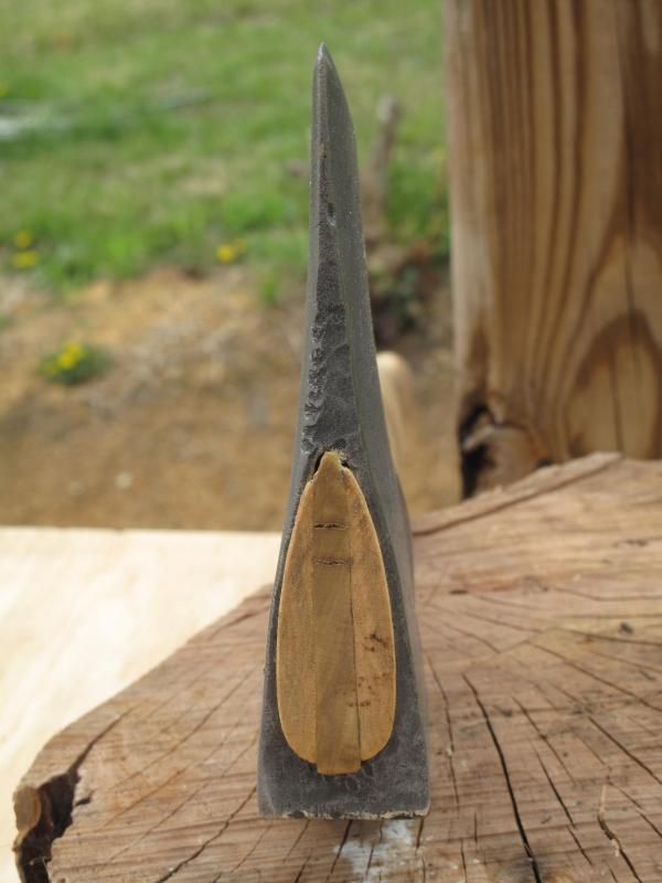

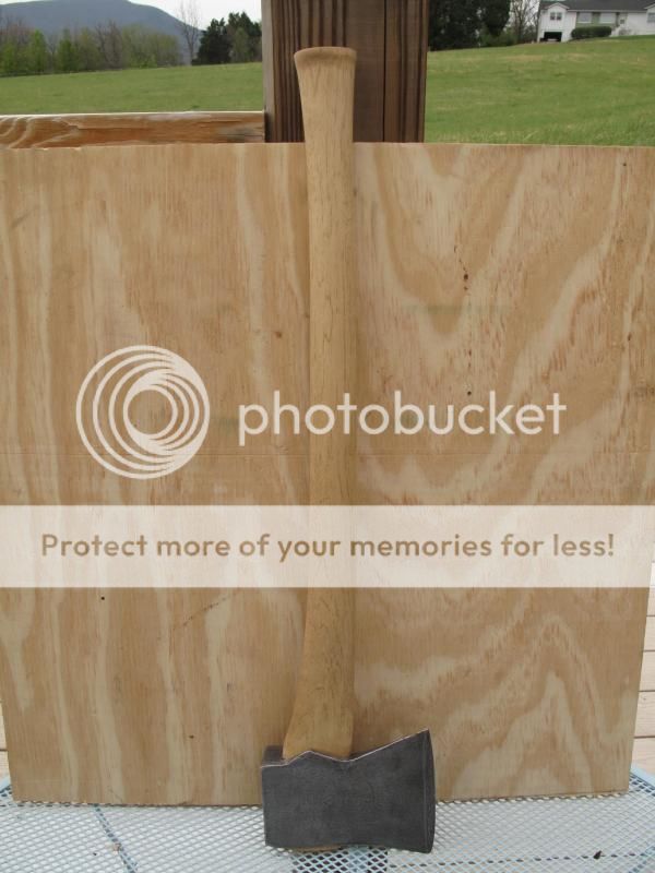

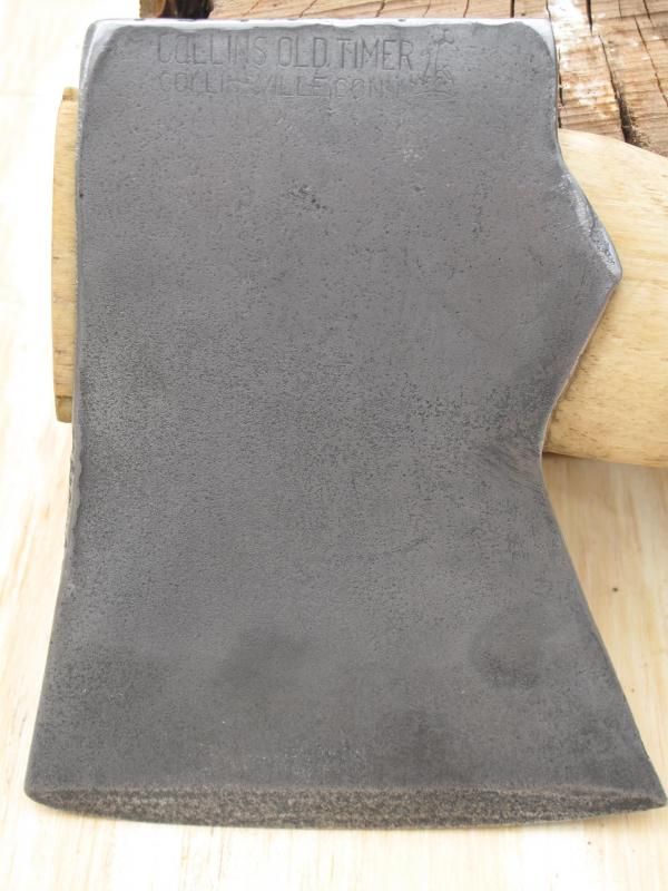

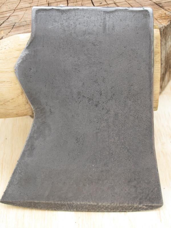

Hung this on a slimmed down HH 1630S- supposed to be 30" but was 28.5"- Now I do not even see them cataloged? One coat of WATCO medium Walnut and 2 coats of BLO.
Bit came from the auction site this way. Just a skosh over 3lbs, straight bit and a V grind like a carpenters hatchet. Do not know what the previous owner was using it for ground this way? Maybe timber fitting? Have not decided if I will change grind or just keep it "different". I had soaked in vinegar to make sure I still had good steel at it looks short bit to poll @ 6 1/8"
OAL- 27 1/8"
OAW-3lbs 15 oz
bit= 5"
Have not had a chance to use it yet.

That looks great. I tried my first rehang today and screwed it up pretty badly lol I'll have to buy another haft and try it again.
Nice job on that! I'm liking this move towards less curved handles and may have to have a go at one myself. That you've not cut the haft flush with the eye is also a nice touch.
Thanks guys, I am still learning and trying to apply what I have learned here going forward. I know now that the spoke shave will be my friend, just need to save for a better one as the blade in mine cants in use. Leaving the handle proud above the head and cutting the kerf wider were things I learned here and do make for a nicer job.
I wish I could find 32" straight handles but I am picking up "fat" 36S handles to try shortening and shaving down.

Makes sense from a practical stand point to leave the haft proud of the eye since it 'locks in' the wood a little bit better by virtue of not being compressed such as inside the eye. Plus makes it easier (if it isn't glued in place) to get at the wedge for removal and/or deeper placement. I notice some of the Swedes do this but otherwise it is not a common feature on re-hafts nor store-bought axes.
