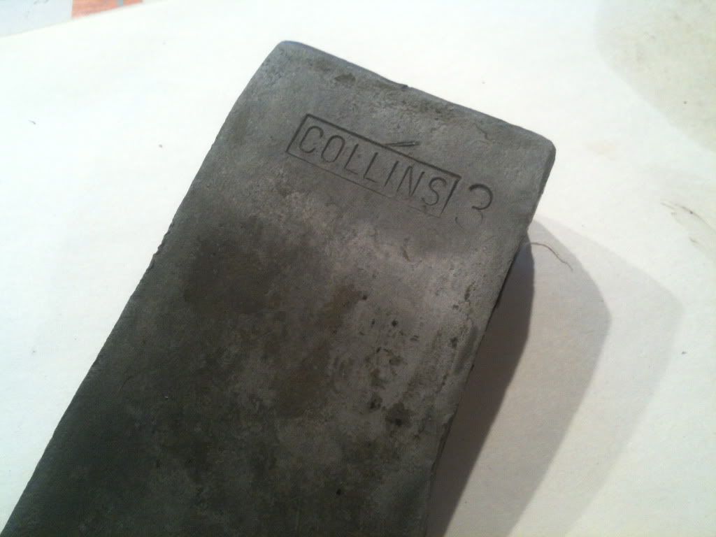

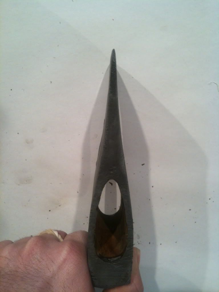

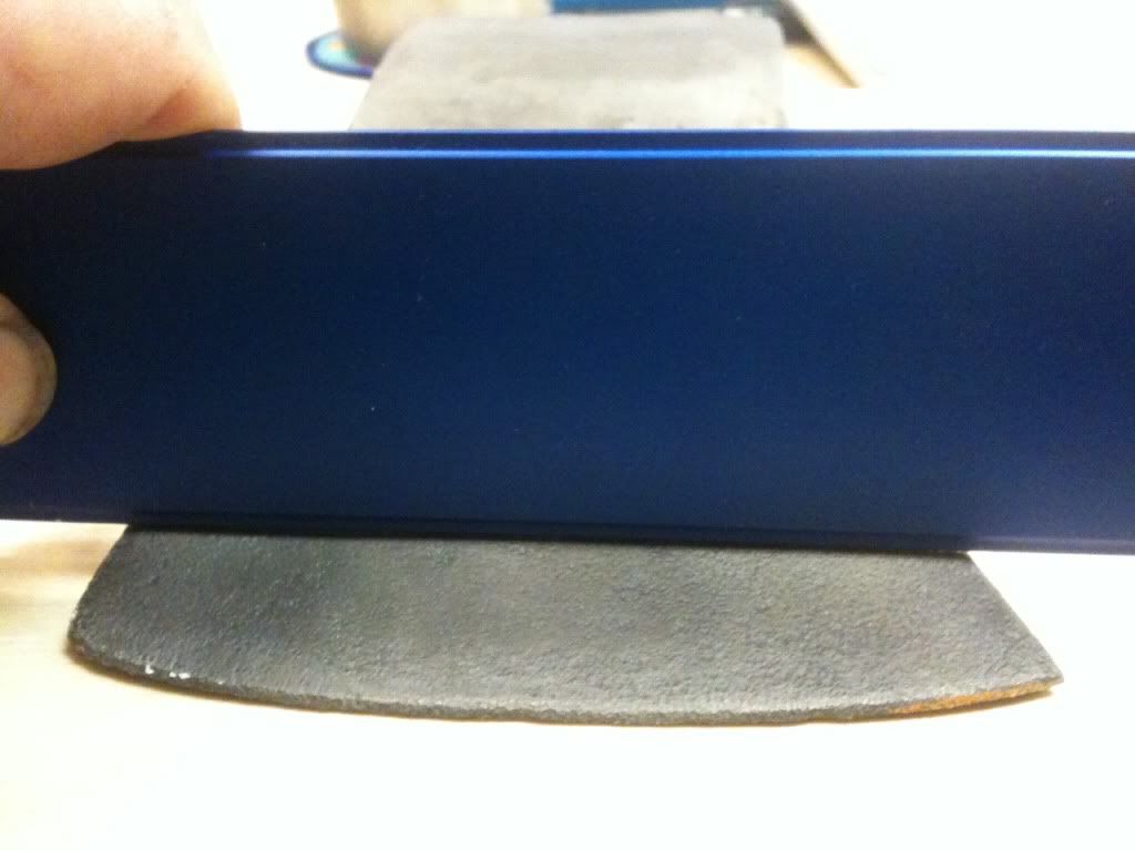

So I'm getting ready to hang a Collins 3 lb SB last week and I start thinking about the profile (this is after reading Zatch's thread about reprofiling his Collins 2.5#) and I notice something I hadn't seen before. The Collins I'm about to hang lacks the high center line that is so widely found on American axe heads. It's completely flat from toe to heel, much like a European head; Iltis, GB, etc. It doesn't look as though it's been reprofiled. Has anyone seen this before on a Collins, or any other American axe head? Anyone know if this was specific to a certain model or date of manufacture.

All of the newer Collins axes are like that. After say, 1950, the quality went down. The steel is still good but they are flat ground, some even hollow ground. I don't like em. I think they were drop forged into dies that produced flat cheeks.

Well I should say you dont see that everyday, what you are talking about is usually the norm, but you do see the flat boys, they are not that uncommon I guess. Would be interesting to see if you could corespond that to a time frame, forging technique, etc.
The one I had bit really well, but stuck and didn't throw a very good chip. Would make a good swamping/limbing axe.

I have re-ground flat faced axes to incorporate a centerline. A lot of work but doable. Power tools helped a lot.
I think I'm going to leave it like it is. I don't have any axes now that have the same characteristics.
