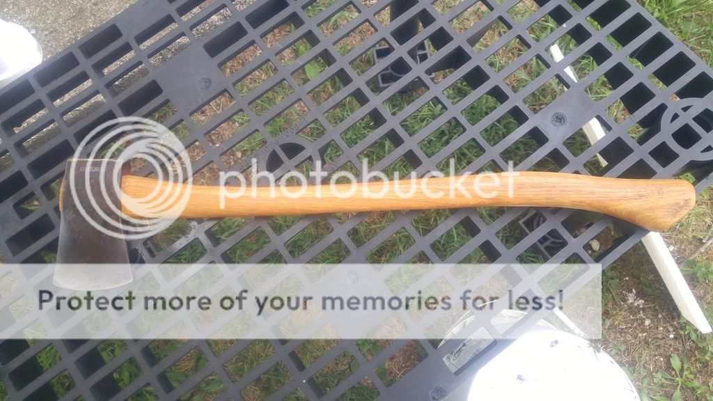

Collins red knight boys axe
Nov 27, 2015
70
Here is a 2.1lb red knight that belonged to my great grandpa. Head really chops awesome.I hung it on a link 28in hickory handle that is all heartwood. I know heartwood is not as good but It feels and looks great. Handle has a big fawns foot I like. I'm finding a 2lb head on a thin longer handle really works for me for a lot of tasks. I'm 6'6 so I don't mind the lenght.
Nice axe, nice job!

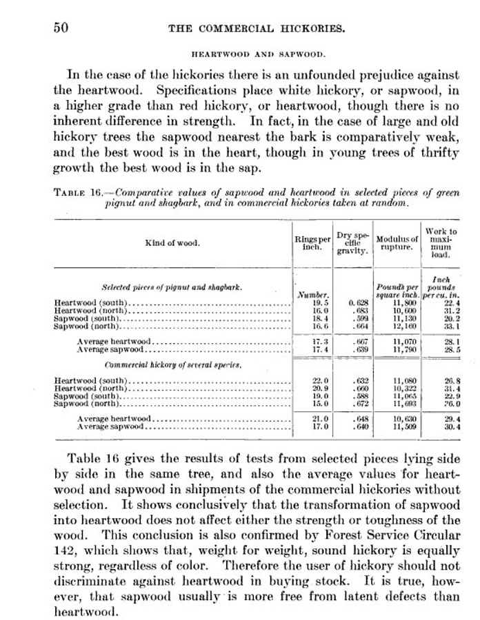

As for heartwood, don't sweat it. For an axe haft I don't think there is any significant difference in strength from sapwood. Often, heartwood also has a nicer looking color and grain.
This has been shown to be true. Heartwood is just fine if it is free from defects. But heartwood is more likely to have small knots in it and such. If you able to inspect the piece and see that it is free from defects then don't hesitate to buy it. But if somebody else is randomly choosing it for you (e.g. - online order) then you're more likely to have a small defect in the heartwood.
Also:
"Over the years a prejudice has developed against the heartwood of hickory, Red hickory (heartwood) is often placed in a lower grade than white hickory (sap-wood) simply because of its color. Tests by the Forest Products Laboratory have shown conclusively that red, white, and mixed red-and-white hickory have the same strength characteristics, regardless of color. The negative attitude toward red hickory developed during the days of virgin hickory stands. Under virgin-stand conditions the heartwood was often less dense and not as strong as the sapwood. In the second-growth stands of today this density difference does not exist, and specifications and utilization practices should be adjusted to take this fact into account."
See page 6.
http://cedarriverforge.com/Photo-index/axephotos/USFS publication 241 hickory.pdf
And:
"Red Hickory as Strong as White Hickory"
http://cedarriverforge.com/Photo-index/axephotos/Red Hickory as Strong as White Hickory.pdf
Great info square peg. I was able to look through several handles when I bought it and it's free from blemishes. It just felt the best and had good grain.
Keep in mind also that with most woods the heartwood is more rot resistant than the sap wood.
Also:
See page 6.

I agree with quinton 100 %. I have a lot of old handle catalogs. The better grades all spec sapwood. Lower grades allowed heartwood. Since most hickory logs of a size useable for handles have way more heartwood than sapwood does it make sense that the companies would make their best grades from sapwood if there was no difference? Agree also that if you work enouge hickory with drawknife, spokeshave and rasp you will see what quinton is saying. I have seen more broken hafts then anybody you know. I also found that when the haft has both sap and heartwood it will most often break along the grain where the sap and heartwood meet. As for rot resistant, if you leave your axe some place where this matters, you have more to worry about than the haft rotting. I still follow the age old rule of no hickory heartwood in my hafts.
