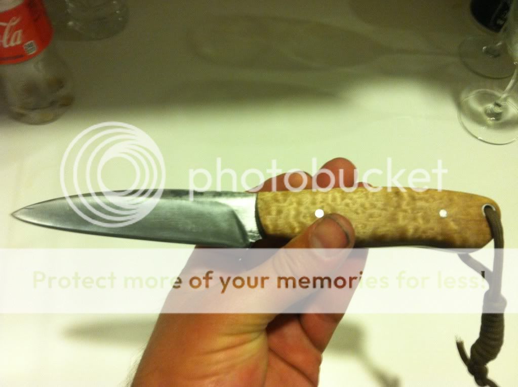

background: i signed up for bladeforums and immediately started asking a bunch of questions, looking for recommendations on a custom knife. Derrick chimes in with, "Come on out to the shop. We'll make one together and you can take it home with you." i mean...how cool is that. so, that's what i did.
This was an amazing experience that i still can't put into words. Derrick was a gracious host (Wulf on BF or visit dicksworkshop.com). i went out to his shop on four separate occasions. we started with a raw hunk of 1084 steel and i ended up with my very own custom knife. derrick was great. he is a fount of knowledge, but he explained it and then let me do pretty much everything on my own. i am a programmer. i sit behind a desk all day. this was definitely something different for me. honestly, i've been interested in blacksmiting most of my life. derrick let me experience all of it, while gently guiding me through the entire process. and, what a rewarding process it was.
i wish i had more photos to share. and, i wish i had a better memory. but, i will give you what i can.

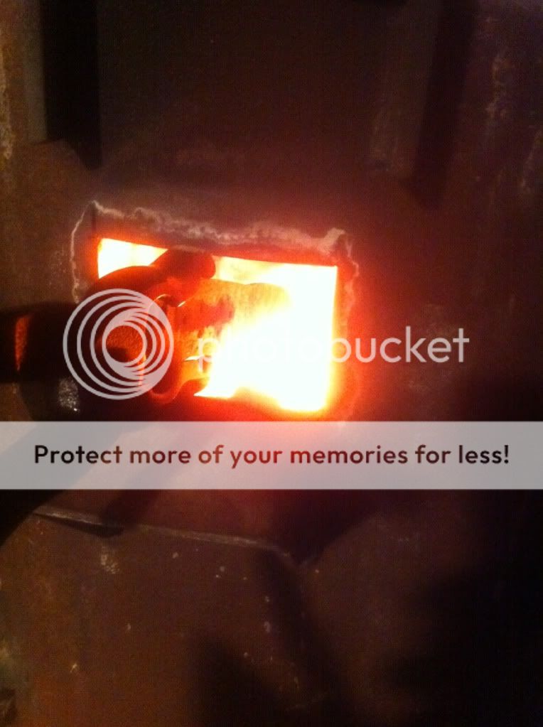

beginning: handed a piece of steel. heat it up and start forging.

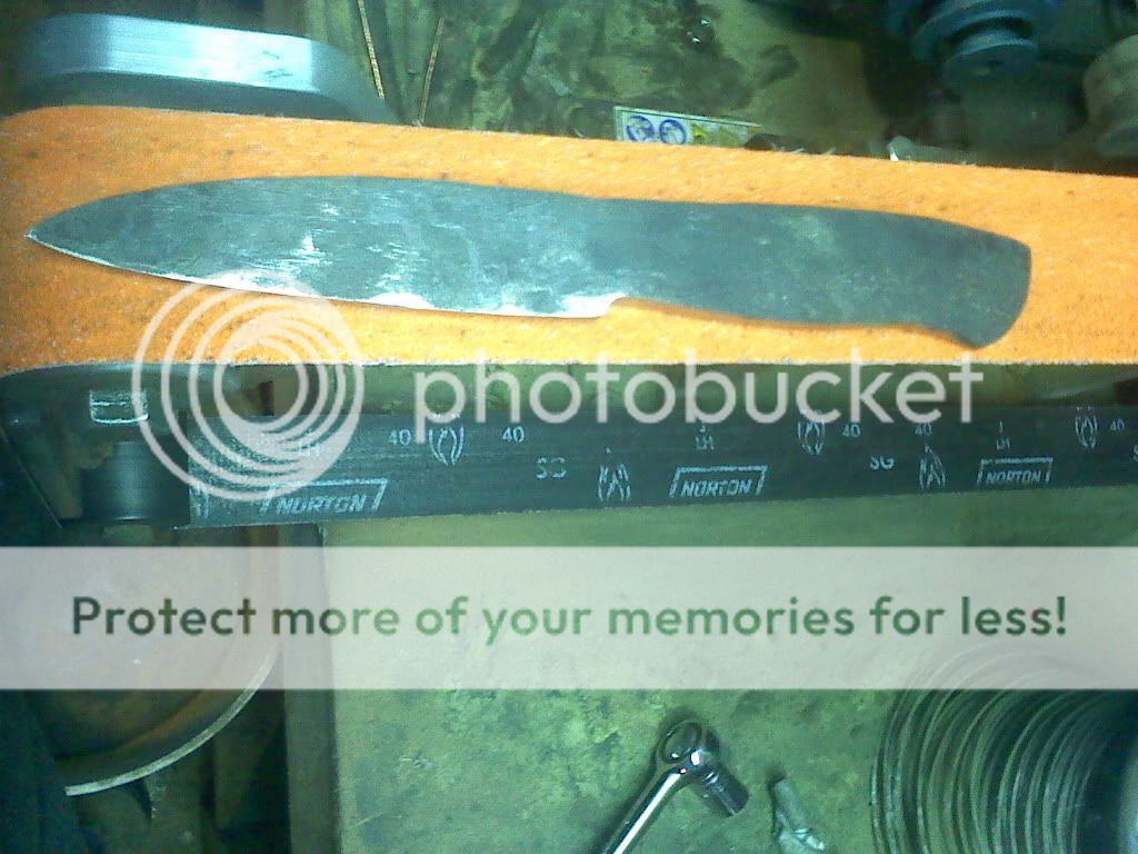

this was after forging. and some grinding. i believe this was when we were heat treating.
Post HT. Post anneal.
there was some concern after that the steel might not be good. it wasn't hardening like derrick expected. the files were still biting in. so, he sent me home with it and i tempered in my oven. 425 for an hour (times two). i sent it back so he could test it. he put an edge on it. he made sure to test it and make sure that it held an edge. ummm...he said, yup...it held an edge and it was sharp.
to be continued....

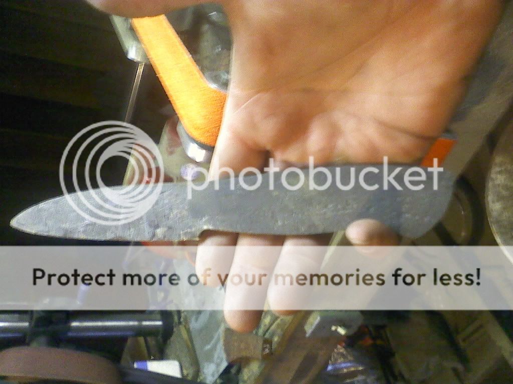

ready to work on her a bit
derrick... my gracious host...i tried, but knew enough to let him grind the edge for me

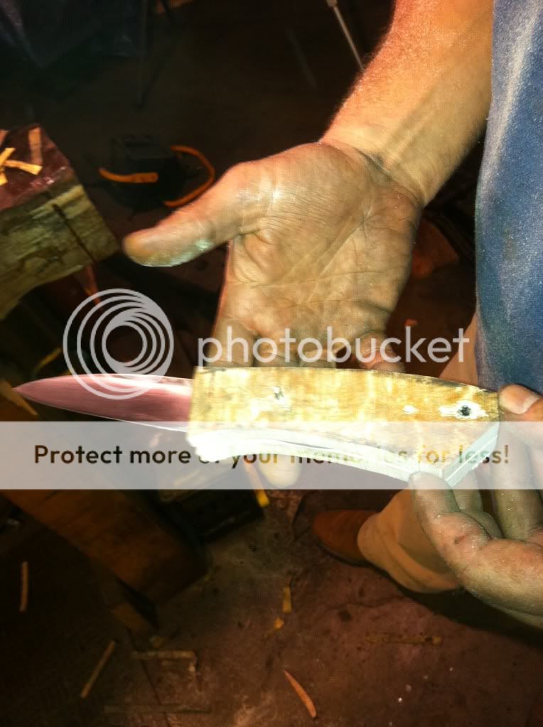

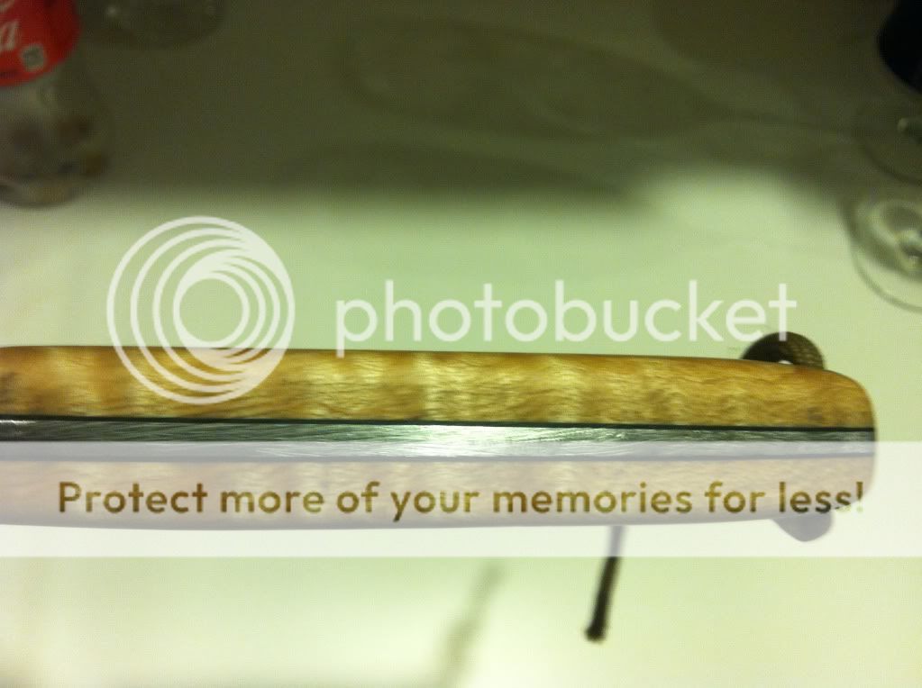

derrick let me take the pick of the litter for handle scales. i was making a knife at dicks workshop in VT. so, how about some nice quilted maple from derricks woodpile? aligned it around the blade and cut it.
here's a better peek

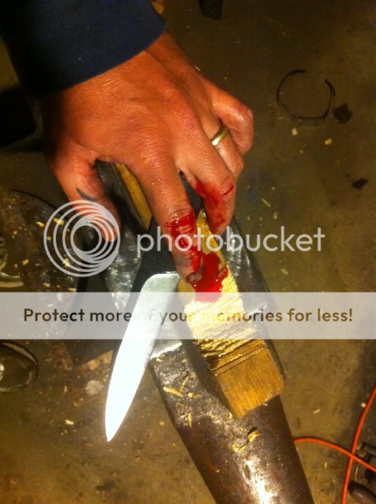

we spent some late nights in the shop. one time, derrick was concerned that i might be a zombie so he hit me with the zombie smasher
to be continued....

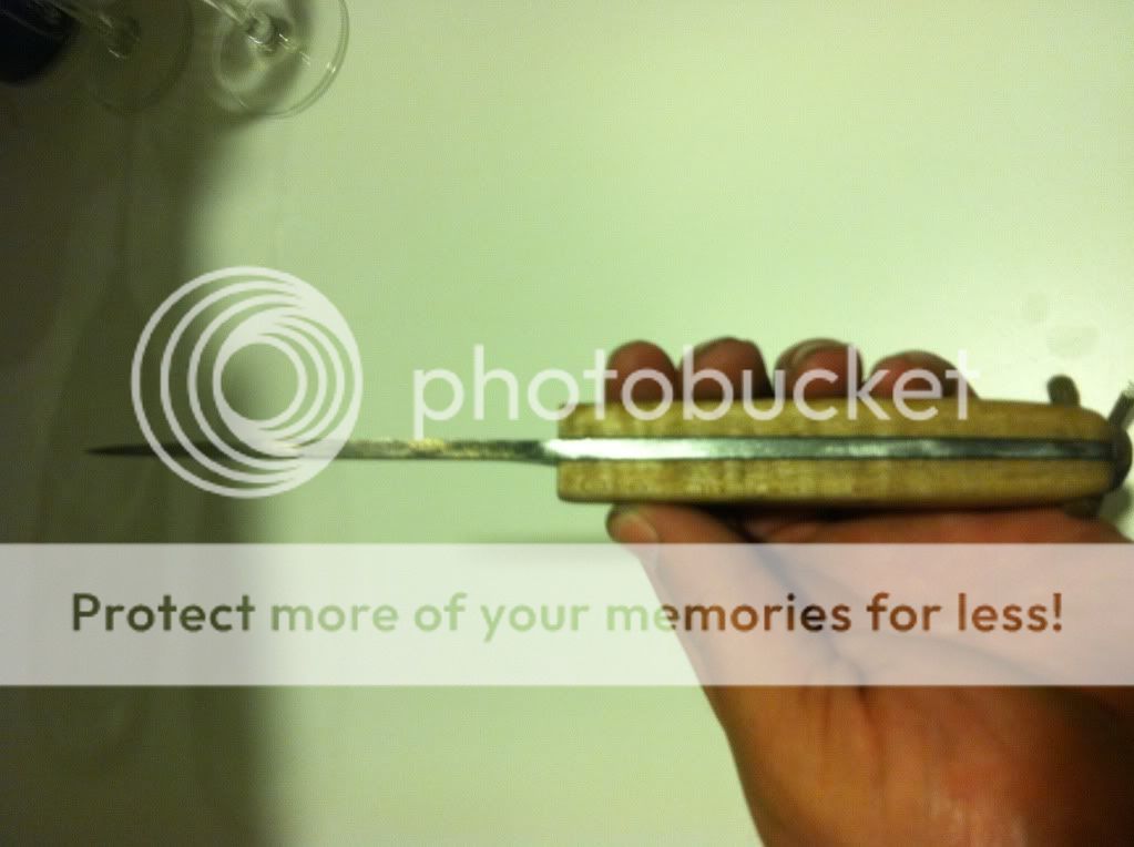

ok, so the handles are all glued up. hit it with the belt sander for some rough work. then, on to the files and then the sandpaper (220, 400, 600 progression)
admiring progess

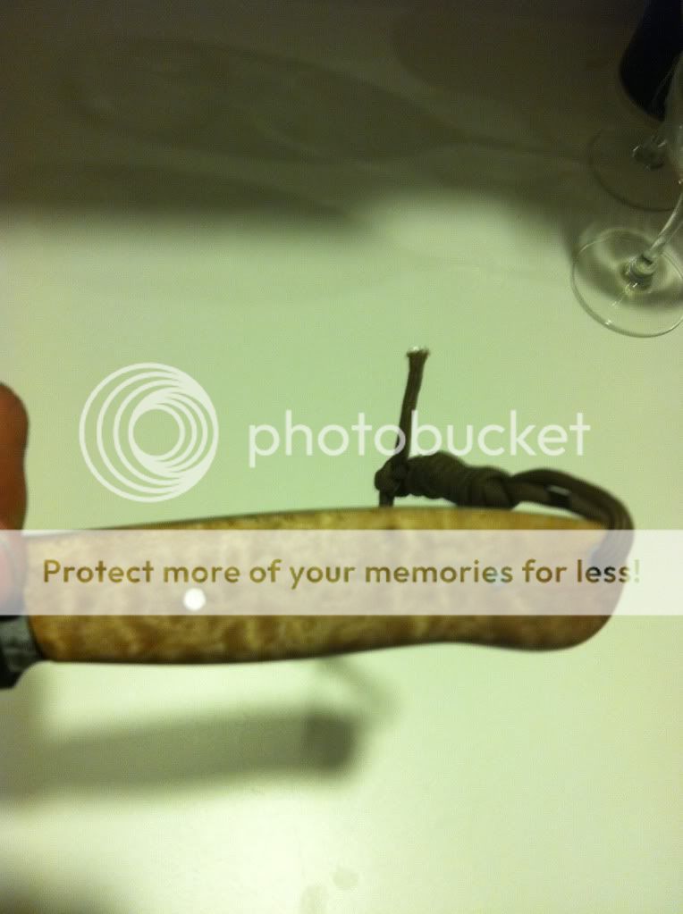

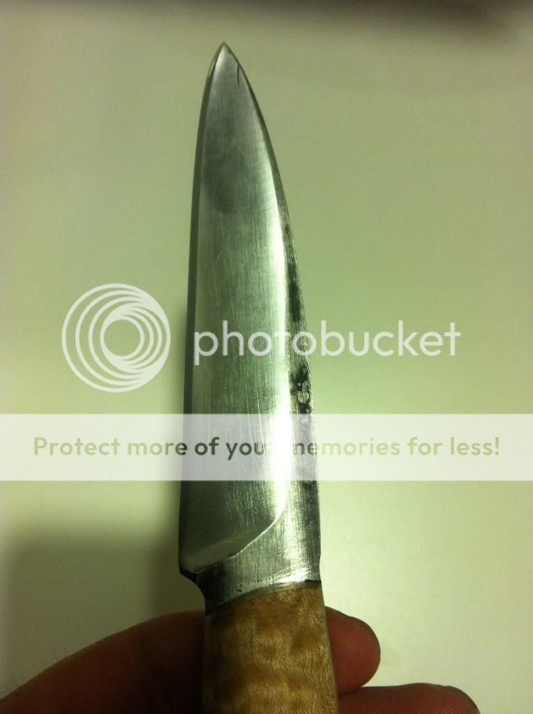

yup. kinda looks like a knife.
to be continued....

overall specs:
OAL: 8 1/2"
Blade: 4 1/4"
Handle: 4 1/4"
Blade Height: 1" at transition
Thickness: 5-6/32"
