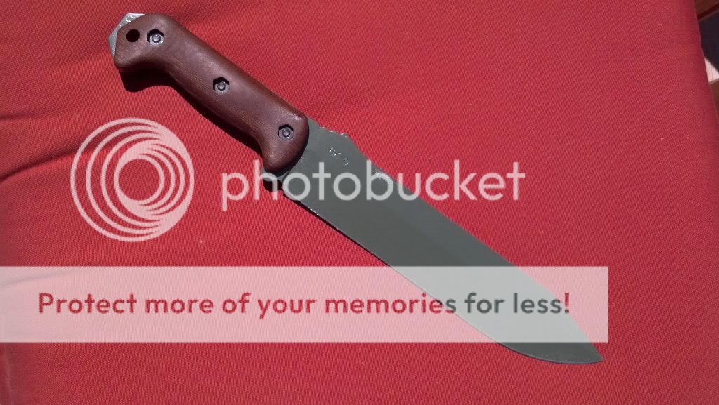

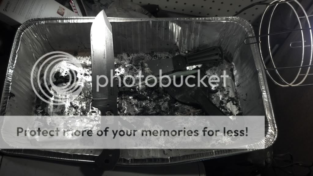

So a fellow in a thread that I now cannot find mentioned a gunsmith buddy of his would occasionally use a technique he called "hobo duracoat"... paint the parts with Krylon, then bake them in an oven at 300F for 30 minutes.
This has been festering in my head ever since, as I'm a color guy and love companies like ESEE that offer more than black. Finally I decided to do something about it, which was to hobo duracoat my BK9 and then, since that's my bruiser, see what kind of hard use the paint could or could not stand up to. Below are my results, along with some thoughts.

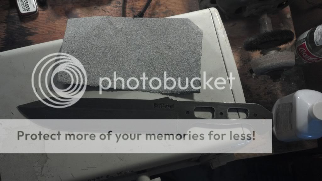

Strippin'
Scratchin'

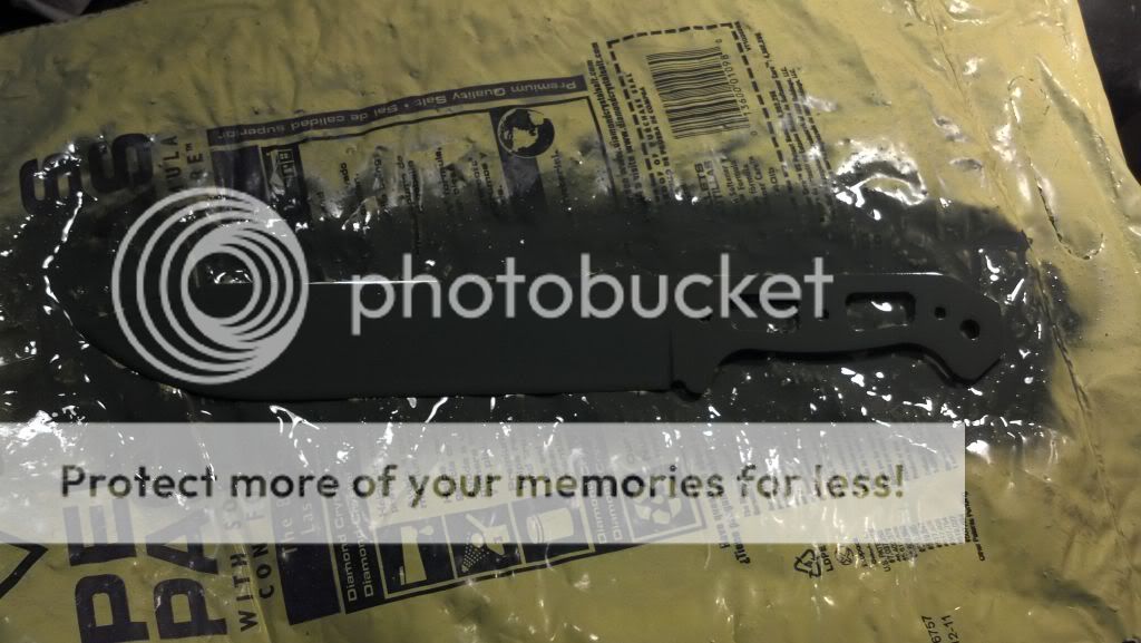

IMMINENT PAINTING
Side one done

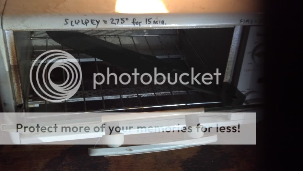

Haha omfg I didn't think to check whether my nine-inch Bowie knife would fit in my craft toaster oven. It didn't, of course. Fortunately Wife was out of the house so the kitchen oven was put into production.

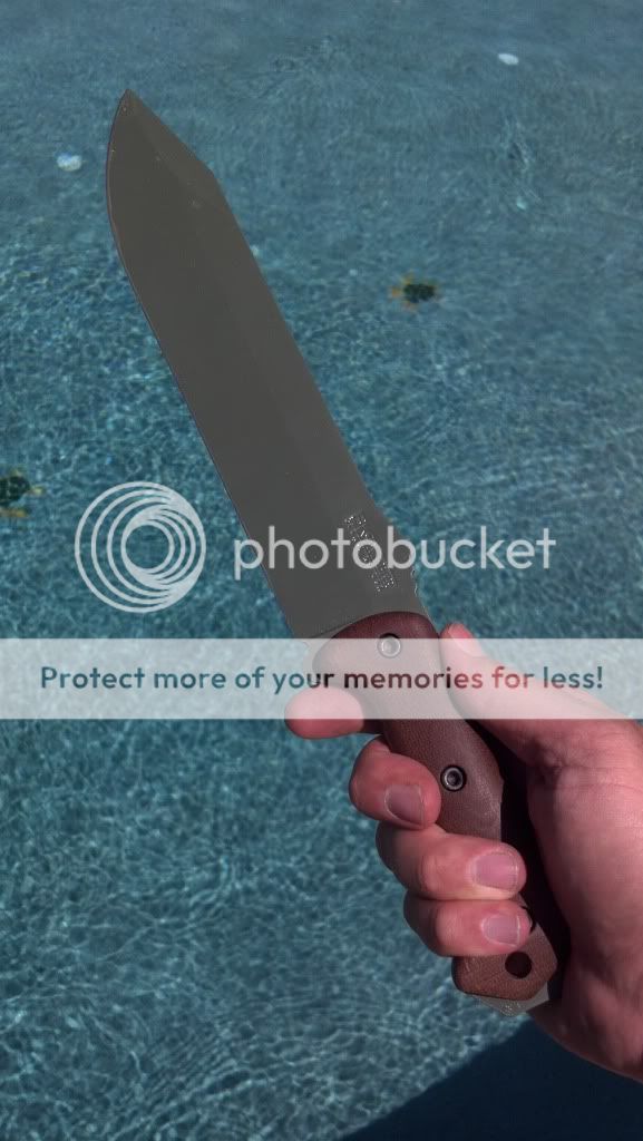

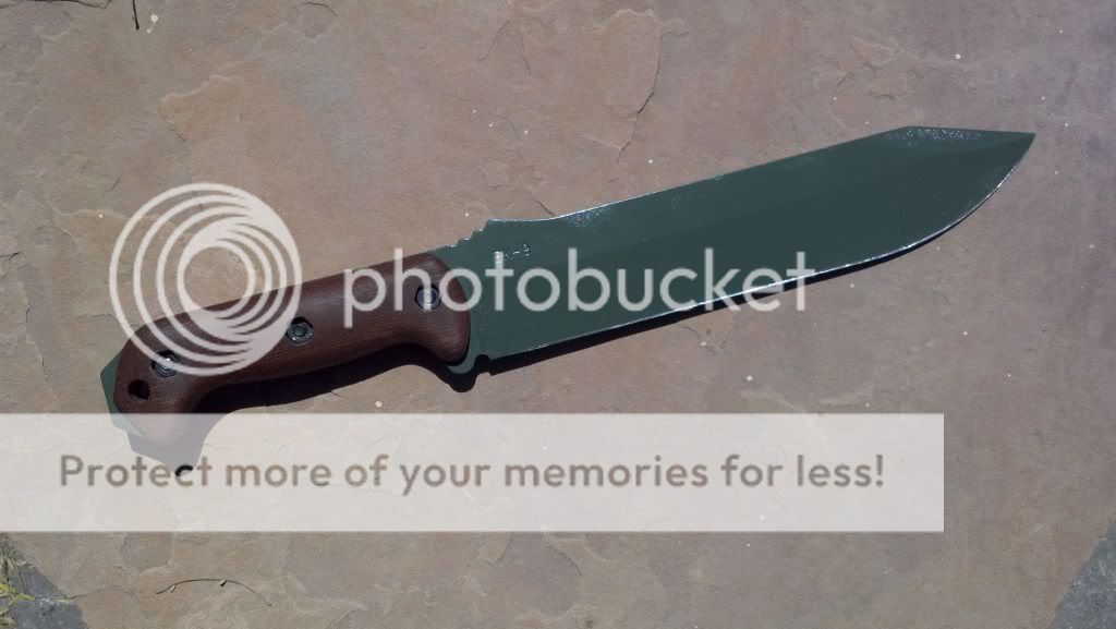

Tada!
Now, if you look close enough you can tell that I didn't put too much thought into how precise I was with the paint. There are drips, there is orange peel, all the usual. I figured it wasn't worth spending a lot of time getting the paint right; I just sprayed it on thick, let it set a bit, sprayed some more on, then into the oven it went. Good enough for this experiment.

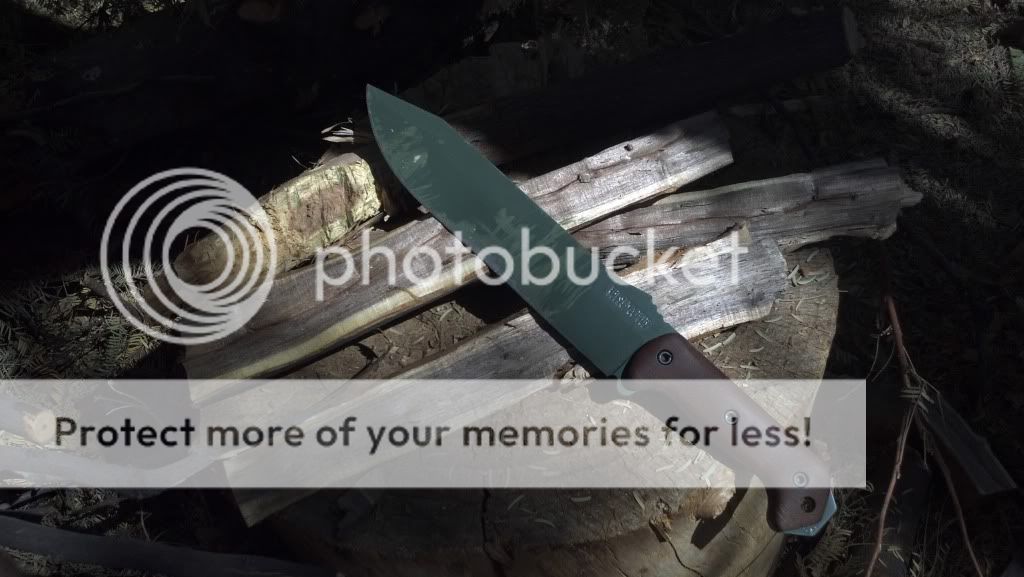

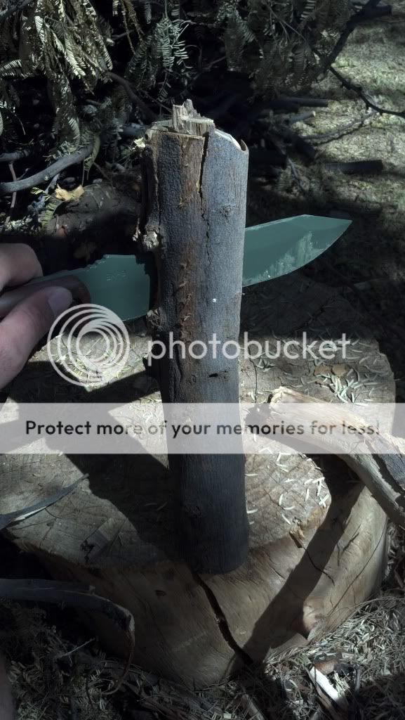

Test 1: Drive it deep into the chopping block.
Hey, it held up pretty well! The white on there is just wood chunks, not metal.

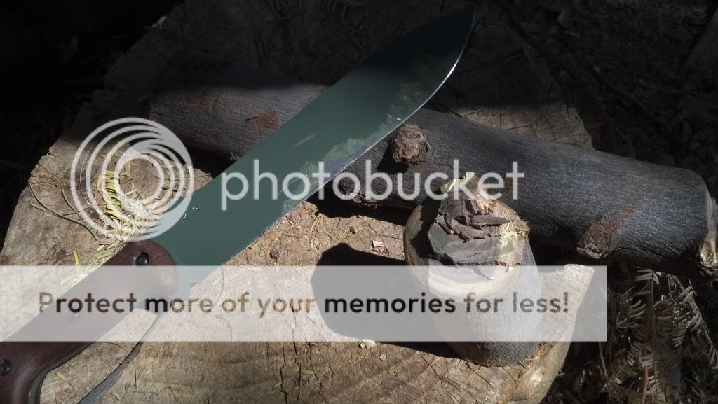

Test 2: chopping a piece of 3" hard mesquite.
Definitely took some paint off this time.

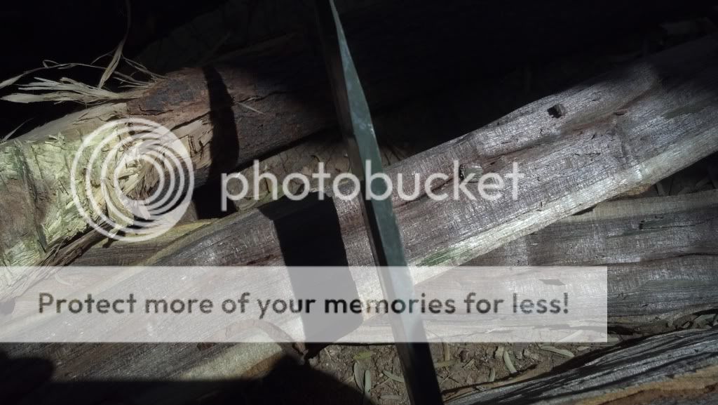

Test 3: Batoning that same piece of mesquite lengthwise into three pieces.
Really not much steel showing after that.
Conclusion
I would say this is a damn effective way to put a custom color on your Becker. The hobo duracoat came off a little bit easier than the factory coating, although not by much. This might not be best way to color something that sees a lot of hard use, like some of the bigger choppers, but for the tweeners and neckers I would think the paint would stay intact for a really long time. Looking forward to taking my BK16 into new territory... I think I'll see how this OD looks with the coyote brown scales.

300 degrees seems a little high, can tooj chime in and let us know if that would affect the temper at all? It looks good though, I am thoroughly impressed how well it held up.
Ive definitely done the using the kitchen oven, damn gf was pissed last time haha
I'm not Tooj, but in order to get a target Rc of 58, I bet 1095CV has to be tempered somewhere between 500-600F.
You probably can't even hurt it in your oven.
-E
Maybe if you put it in there and put the oven on the self cleaning cycle.
The last time I checked, self cleaning temperature was about 830 degrees, unless you own an old model from the '60's, in which case, 1050 F, at least for Westinghouse.
