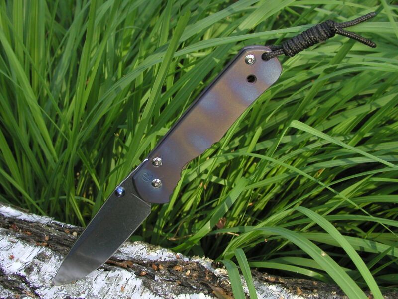

What do you think?
Did firing the blade have any effect, positive or adverse, on the texture/feel of the titanium scales?

Nice job on the knife. Very nice picture. :D How did you fire it?
Thanks Esav! How did I do that? easy:
1. disassemble your benza
2. clean Ti slabs (brush + soap + water)
3. degrease it VERY GOOD. That's the key issue. Any industrial light degreaser will work. I've used... I don't know what... I've just asked a guy in the DIY store "good degreaser for titanium please" :)
4. get a butane torch with high-temp, narrow flame (pen-style works best, ask in DIY store again)
5. start flamingh your benza slabs... for a long time you got no color, than it turns: sand-brown -> purple -> deep blue -> light blue -> gold. Longer heating gives next colors.
6. Air cooling is just fine.
7. Assembly your benza :)
There is no difference in slabs surface texture - after the flame treatment it handles just like any Sebenza.
Hi,
Did you do that on the lock side also, If so did it change the tension on the lock bar?
Thanks,
Jim
jim c: I did the same on both sides. The only difference is that the locking bar itself has been heated only a bit, to get sand-brown color. Anyway, AFAIK such a treatment doesn't change anything in Ti structure.
