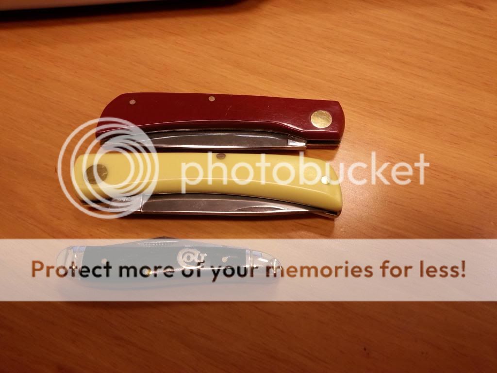

I have the Colt Peanut in 440a. I will tell you I was impressed with it enough to give it to a coworker who I've known for 8 years and not feel like I gave him a piece of junk. Excellent FF just like the OP's carbon trapper. Excellent cutting ability. The only sacrifice was not so great edge retention, but the blades are so thin that it doesn't take very long to freshen up. Btw, I whittle some green wood with that little peanut with no detriment to it in ff after. After the whittling session I was sold that it wasn't just some cheap knife with a gunmaker's brand stamped on it even though it sells online for dirt cheap!
Just got the canoe in the mail. I gotta run out but I'll post pics and more details later. I have to say though its a very fine knife. Shaving sharp out the box, strong pull and snap, no notable gaps, no hot spots and no play at all. There's almost a bit of rub between the blades but nothing that seems to be scratching. Its heavy but comfortable and'll make a great whittler.
