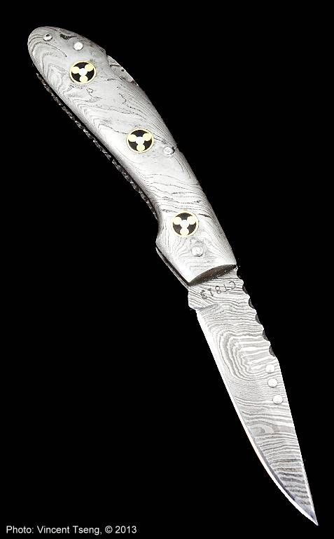

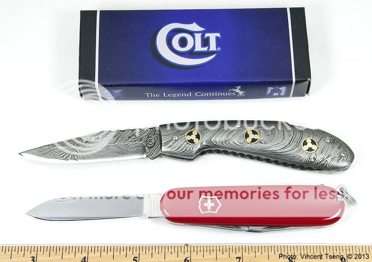

I just received this and am again rushing out a review.

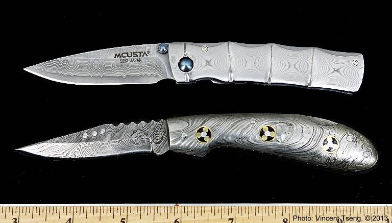

This time it is a true Damascus blade -
and just about everything else (except for the decorative mosaic and pins that hold the knife together) is Damascus.
Even the lock-bar and back-spring are Damascus steel.

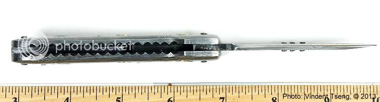

Size -
Open -
Closed -

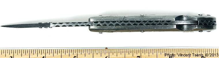

Measured just a shade under 4" closed.

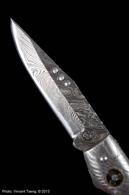

2 7/8" Damascus blade (measured to handle end) -
Those 3 pins/studs give grip/purchase to open the blade

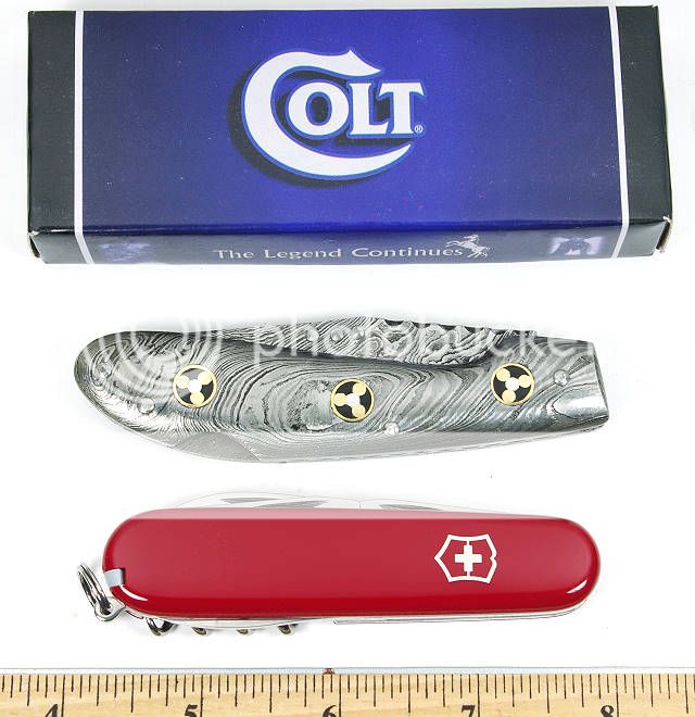

Being all Damascus steel the knife is pretty solid and heavy for its size at 5.24oz.

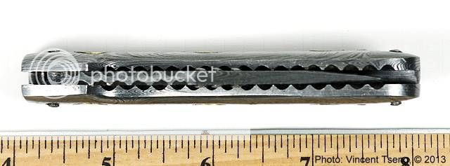

It has file-work on part of the spine and back-spring -
And there's file-work on the handle opening -
and the blade is pretty well centered in the handle.
The action is good with nice lock up and unlocking -
OK....

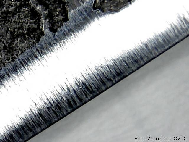

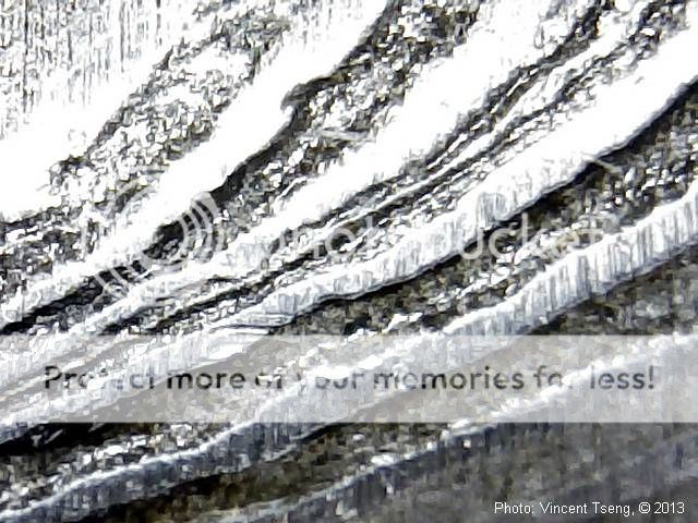

Test cutting - er - it was about as sharp as a butter knife -

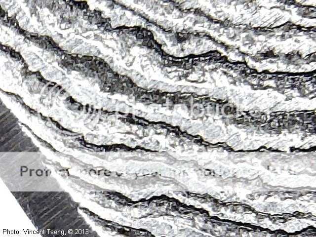

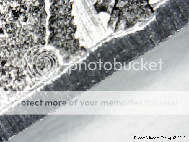

Edge under usb microscope (~110x)
Edge looks pretty poor

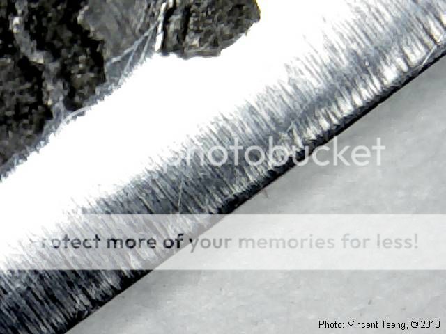

I spent over 2 hours on my Work Sharp (belt grinder) Knife Sharpener to grind in a new 20 deg convex edge
and finishing on the Work Sharp Knife & Tool Sharpener - Ken Onion Edition
Edge after sharpening -
The new convex bevels are really wide because the original (laughingly called) edge was very obtuse.
The new edge looks pretty good -

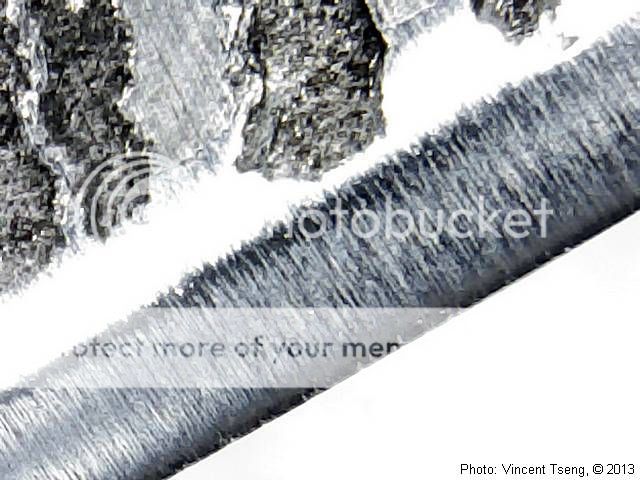

But will the edge last? -
these are the usb microscope photos after 7 long cuts through corrugated cardboard against the grain.
So it looks like the edge may last -
but the cutting was not that good despite the good convex edge at 20 deg/side -
as the basic geometry was not good, giving a thick cutting profile -
and those 3 opening studs/pins get in the way of cutting through too -

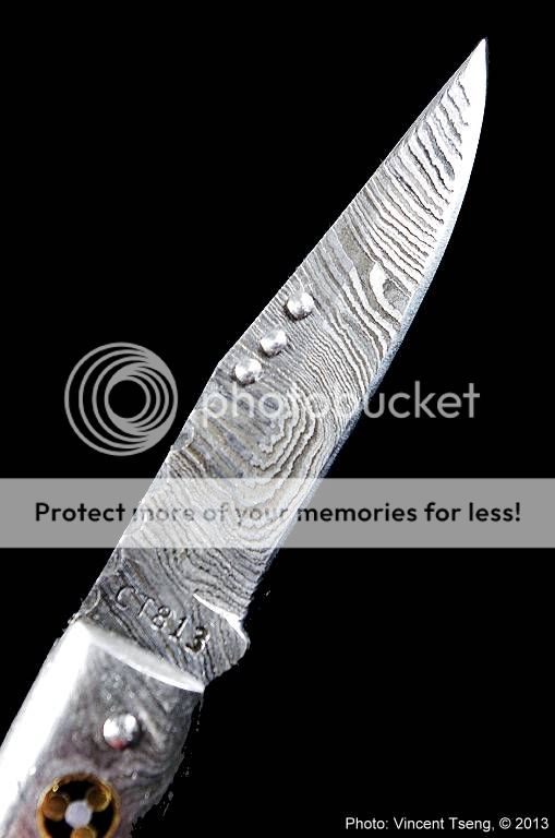

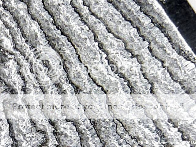

ubs microscope pics of
Damascus - Blade -
(original edge in corner)

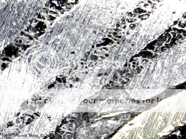

Handle also Damascus -
outer brass ring of the decorative mosaic bottom right corner.

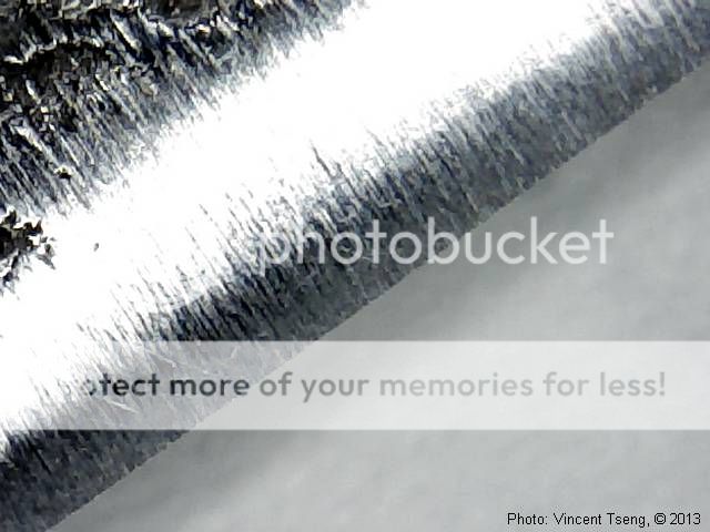

Looking at that photo above - I can see that the finish didn't seem to quite reach the very edge.
This is despite me feeling an easily defined burr along the full length of the blade.
So I think there is a difference between when the burr first forms - which is literally just when the grinding/sharpening just reaches the actual edge)
vs. what I am looking for under a microscope - a finish right to the edge.

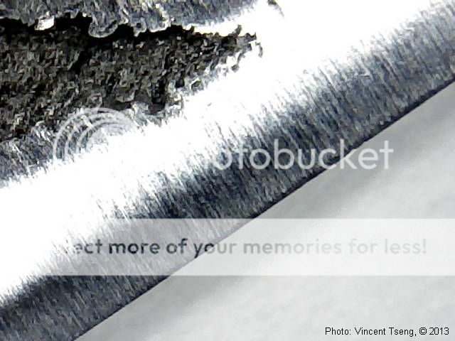

So since I had used the blade to cut through corrugated cardboard - I sharpened it again -
this time taking the blade to the microscope to make sure the finish was right to the edge -
but dong this the long-winded overly cautious way of making sure I got the finish just when it reaches the edge -
so as not to take off any more steel than I needed to.
Ah! but here's something I learned -
Knowing that it was one side that the finish didn't reach the edge I worked only on that side using the WSKTS Ken Onion Ed
using the coarsest P120 stock belt - single pass raise the burr, then single pass X65 - felt the easy burr - then couple of passes on X22 - same thing easily felt burr - then finally 3 passes on the X4 - with one pass on other side to knock off the burr - then finish with the 6000MM (2µm) belt - still favoring the side I was grinding - examined under usb microscope - - not quite there yet!!!
Repeat the process - this time it looked good under the microscope......

Remember I had a bias on one side which formed the burr that I carried through the process?
It's not that there was still a burr - but the minimal grinding/sharpening on the other side - although knocked off the burr left a crude edge!!
Hence the unsharp results - unable to cut paper cleanly......
so back to the sharpener - this time doing it from the X65 single pass each side - then progressively on the stock belts - but this time even/equal on both sides -
finally gave a much better result and finish
Results under usb microscope -
this was the side where the photos shows the finish didn't quite reach the edge.
opposite side -
One can see the finish/grinding only just reach the very edge - but that is nice and clean - so the knife will cut paper cleanly -
but still not through things that well, because of the poor geometry, presenting a thick profile -

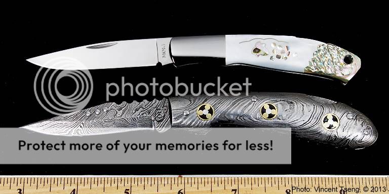

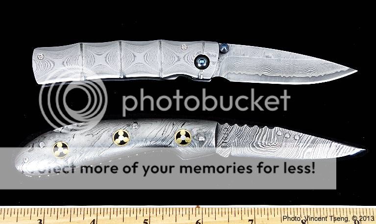

Anyway might seem almost opposite ends of the pole -
the Moki MK-509 Aiora is one of the prettiest and most elegant folders I own -
the Colt CT813 - is somewhat cruder finish and the weight doesn't help the impression of being somewhat "clumsy" -
but in terms of just looks -
it is surprising isn't it? even when shown right next to each other -
this Colt CT813 is a looker.
