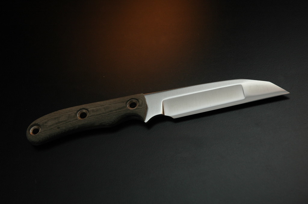

This is my first knife in CPM-M4 and boy does this stuff take an edge. Not too bad to grind before heat treat. But it is definitely slow going grinding this stuff after HTing. This stuff takes a fine edge and holds it like a pitbull. It easily push cuts slivers of hair like butter. If it was more stainless it would be my new favorite steel. I am lazy when it comes to maintaining my blades.
