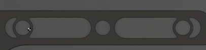

I like the full cutout, it probably helps a lot with balancing. Do you have a picture of the micarta spacer? Are the scales recessed so they fit inside the pocket to prevent movement, or is the spacer fitted against either end of the pocket?
I've been (unsuccessfully) trying to think of a way to retain two standoffs here. My latest idea was more an exercise in making a hole appear in the middle of a pocket than anything else; I don't think this would work very well. I had thought about a Delrin wedge on either end which could capture either the spacer or be threaded itself. Threading wouldn't be terrible, but if someone cranked down they'd pull the threads out. Especially at 4-40 sizes.
