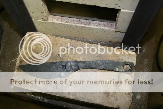

The second knife was forged from 3/16" x 1" 1084 plain high carbon steel from Aldo Bruno. Here's what it looked like after forging with the profile cleaned up but before the bevels were filed.

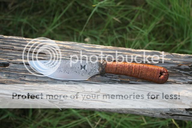

After hardening in canola oil and tempering three times, I wrapped the handle. There is a slab of leather underneath the wrap on either side going the full length of the handle. They have holes so that the hemp wraps through the steel and the leather. The three-strand Turk's head know is in black cotton cord, and then whole handle is sealed in amber shellac.
After all of that had cured and the edge was sharpened to shaving sharp, it looked like this:

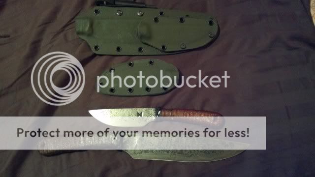

He's done a bang-up good job making a Kydex sheath with a firesteel loop for the big knife and has made a pair of sheaths for the companion. After I get pics of the companion sheahts, and with his permission, I'll post those up.

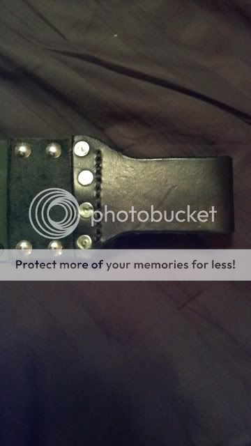

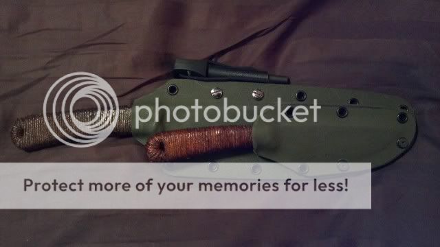

Here are the sheaths that the customer made for his knife set:
He commented that the companion knife throws sparks off a ferro rod better than anything he's used. He's very pleased with the set and is planning on getting a bush sword in the future to round it out. :)
