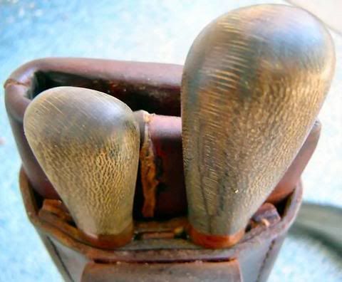

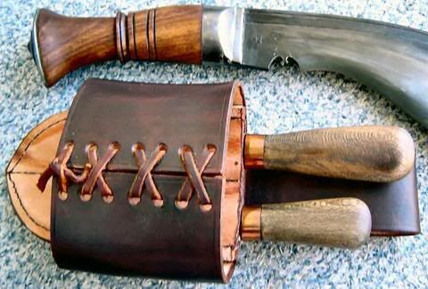

And hopefully here is a pic or three of my full size Foxy Folly with it's pair of kardas I made from some old knives that had leather washer handles beyond repair...
