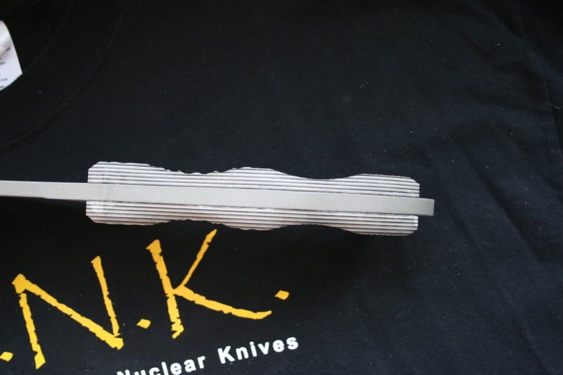

Comparing thickness of 5 different fusion handles for reference.
AZTimT
The Stripetition Finish Guy (inactive)
Platinum Member
Oct 15, 2009
4,506
There was recently, as well as many times in the past, questions where newer guys were asking about handle thickness differences. I am an amateur at photography and I've got a long way to go. :o So to practice I tested out some pics the other day trying to figure out camera settings to go with a crude light box as there is too much snow outside to take pics. I figured while at it I could take some shots to show the range on the two most common stock thickness of fusion handles being ~.25" and ~.33" with both standard thickness and mags. If I can find my micrometer I can post the actual thickness of each. For the meantime the simple math would be standards are ~.50" per pair and magnums are ~.75" per pair on top of the blade thickness.
Handshaped on .25 (black canvas on CF) above machined magnums on .25 (Cerakote) sorry for the out of focus
add machined mags on .34 below (bruiser/satin)
add machined standards on .34 to top (snakeskin/black)
add machined standards on .25 to the very top (bruiser/black)
For comparison from the side.
This shows most of Busse finishes offered except the old smooth coat, DCBB and BIG satin.
Satin, Cerakote, Competition Finish, Combat Grade coated

Only thing I would add that I have observed is;
The Scales on the new Bronze CG FBM's are really a combo of Machined Magnum scales and Hand-shaped Magnums.
The Machined Magnums where the same thickness but has square corners
The hand shaped had no machine texture.
I only add this because on a kydex sheath, if you mold to a Hand shaped scale or a Machined Magnum scale it will not be 100% correct.
Again very cool pics and Thank you for sharing.
I had scored a very cool CS recurve FBM from KC. But the mag scales on top of the 0.31" blade were just too thick for my hand; it had that 'golf ball' thing going on with the center swell. IIRC, the thickness at the center was 1.1". Had to sell it.
